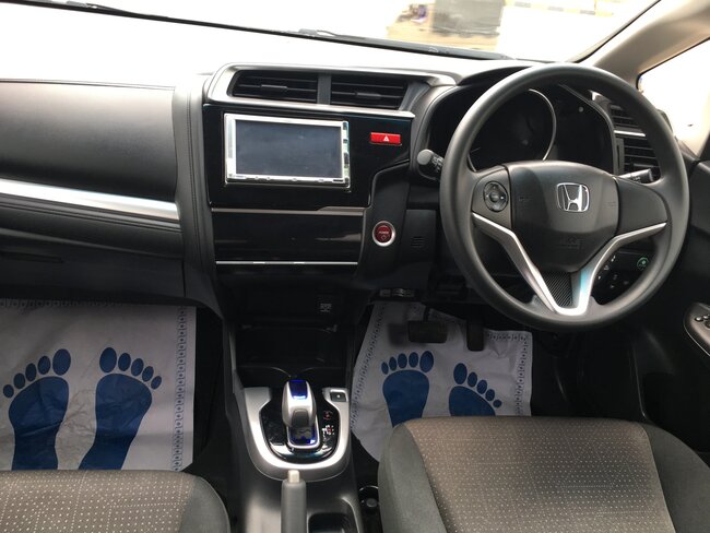

Car won’t startup using push button and I get following error codes
However, the aircon and multimedia player turn on but won’t get ignition lights and won’t get started instead the car keeps asking to press brake and push start button.
Error Codes:
U0155 F-CAN Malfunction
U12AD EPP(IMA)-CAN Malfunction
U0293 Malfunction (ECM-PCM-Motor)
Solutions I have tried are below:
Replacing new push start button.
Replacing 12v main battery.
Replaced the remote battery.
Also confirmed that when pressing brake pedal the rear brake lights turn on.
See the attached video
The car listed above is an AWD, GP-6.

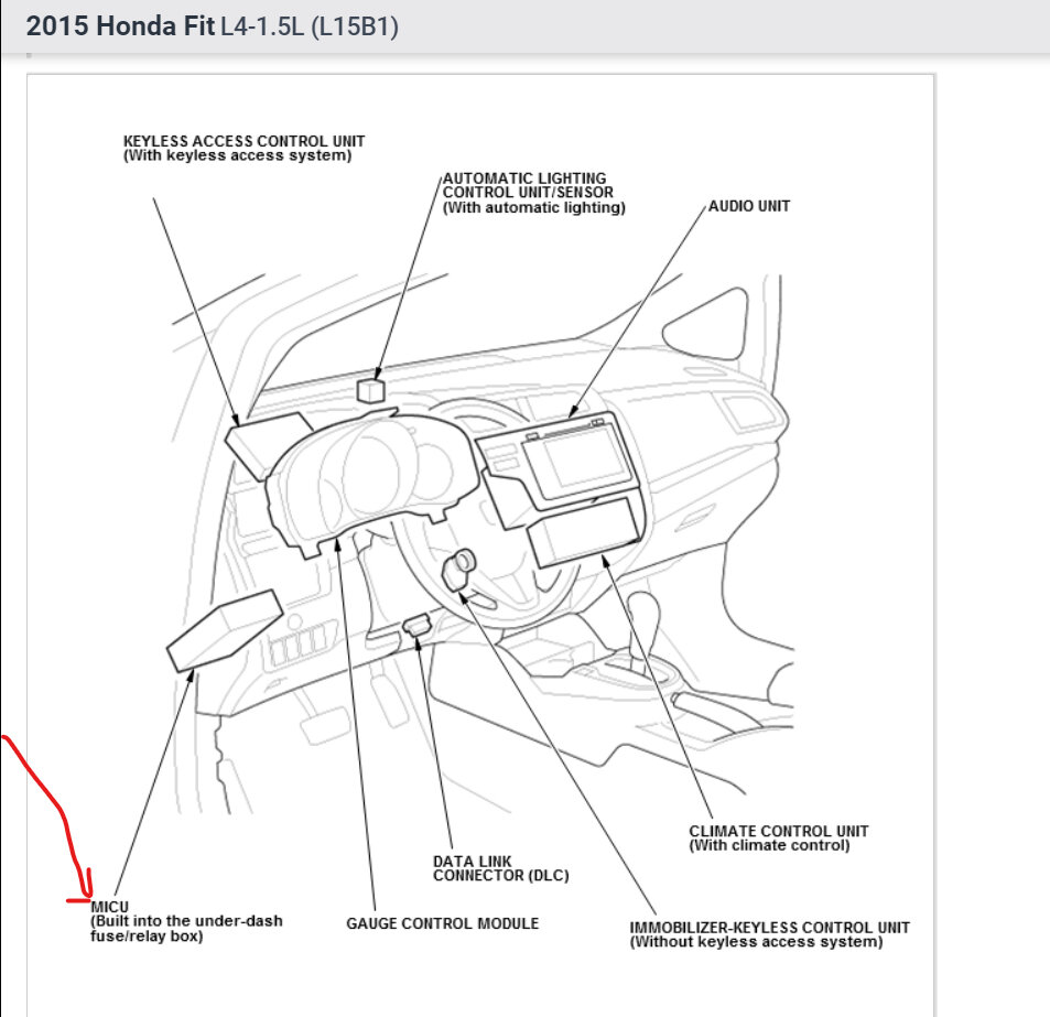

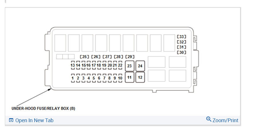

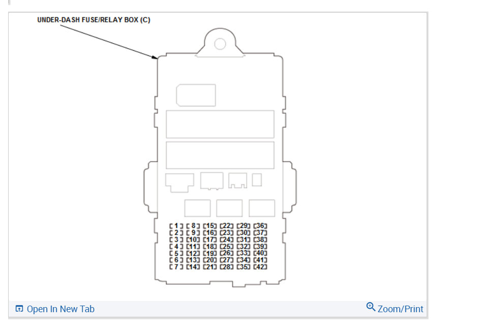

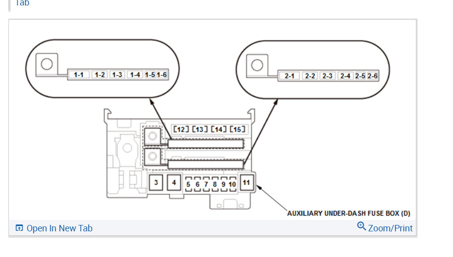

Thanks for the video and images. I would first check all fuses when the system is on. This guide can help.
You may have a MICU that needs to be replaced. Check out the images (below). Let us know what happens and please upload pictures or videos of the problem so we can see what's going on.

It sounds like the MICU, or the IPC is going out and needs to be reset to work, we should do a CAN scan to see which codes come up, you can get a CAN scanner (Controller Area Network) which will work on most cars from Amazon.
Here is a guide to help us get started:
https://youtu.be/u-4syLc-ifQ
and
Please go over these guides and get back to us.
