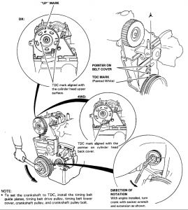

I was cleaning out my block area because there seemed to be a leak, I saw oil dripping out the sides, so I opened it and found the problem, some of the oil got all over the cam gear area, so I decided to unscrew it and clean it, but at the same time I accidently dropped a bolt into the timing belt area. And my dad tried to start the engine when I said "No dont" he still did. The car wont start and I need a way to fix it.
Can you please tell me how to fix this problem. Any suggestions?
My car - Honda Civic EX 1998 D-series engine.
Sunday, January 5th, 2020 AT 5:47 PM (Merged)
  • 75,992 POSTS
You need to open the front cover-check the belt maybe it snapped, then find the bolt-your valve/ignition timing is off it will never start-you need to put it in TDC compression stroke-line up the cam and crank sprockets and making sure the rotor is pointing to the no.1 tower on the cap. Before you reinstall the belt and then retime the ignition.
HTH Good LUck

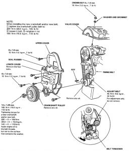

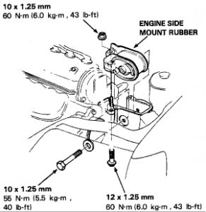

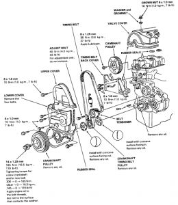

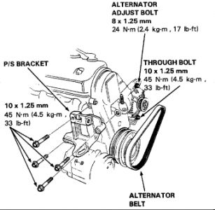

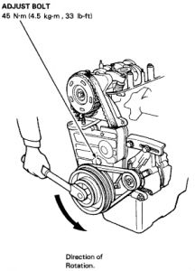

How do you replace a timing belt on a civic. What type of tools do you need. Can you describe how to fix it in steps. Thank you.
Sunday, January 5th, 2020 AT 5:48 PM (Merged)
F4I_GUY
  • 3,302 POSTS
This is a very lengthy job, to explain it step by step would take a long time. Your best bet would be to download or purchase a service manual that will have exact torque specs and pictures/diagrams for you while you work on the car!
The only speciality tools needed would be a honda crankshaft pulley holder and a torque wrench.

I have a Honda Civic DX 1994 with 177,000 miles snd 1.5L 4cyl engine. Last night my car died on me, after hitting a small bumb in the road. The car won't crank over at all. I check the fuel and ignigtion system and they all seem fine. Could I have knocked the timing out of whack?
  • 75,992 POSTS
Maybe - try putting the engine on TDC on no.1 compression stroke. Make sure the timing pulley marks are all line up. Open up the distributor cap is the rotor exactly under the no. 1 cap tower.
