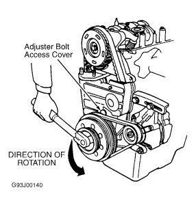

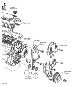

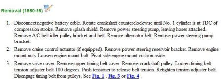

you do not have to replace water pump if it is not damaged in any way ?? some people replace it at the same time because of all the work involved .. it's a matter upto yourself ?
https://images.2carpros.com/forum/automotive_pictures/266999_time1_1.jpg

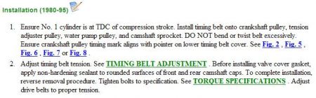

TIMING BELT Removal (1980-95) Disconnect negative battery cable. Rotate crankshaft counterclockwise until No. 1 cylinder is at TDC of compression stroke. Remove splash shield. Remove power steering pump, leaving hoses attached. Remove A/C belt idler pulley bracket and belt. Remove alternator belt. Remove power steering pump bracket. Remove cruise control actuator (if equipped). Remove power steering reservoir bracket. Remove engine mount nuts. Loosen engine mount bolt. Pivot side engine mount cushion aside. Remove valve cover. Remove upper timing belt cover. Remove crankshaft pulley. Loosen timing belt tension adjuster bolt 180 degrees. Push tensioner to release belt tension. Retighten tension adjuster bolt. Disengage timing belt from pulleys. See Fig. 1 , Fig. 3 or Fig. 4 . Fig. 3: Exploded View Of Timing Belt Components (1984-91) Courtesy of AMERICAN HONDA MOTOR CO., INC. Fig. 4: Exploded View Of Timing Belt Components (1992-95) Courtesy of AMERICAN HONDA MOTOR CO., INC. Installation (1980-95) Ensure No. 1 cylinder is at TDC of compression stroke. Install timing belt onto crankshaft pulley, tension adjuster pulley, water pump pulley, and camshaft sprocket. DO NOT bend or twist belt excessively. Ensure crankshaft pulley timing mark aligns with pointer on lower timing belt cover. See Fig. 8 . Adjust timing belt tension. See TIMING BELT ADJUSTMENT . Before installing valve cover gasket, apply non-hardening sealant to rounded surfaces of front and rear camshaft caps. To complete installation, reverse removal procedure. Tighten bolts to specification. See TORQUE SPECIFICATIONS . Adjust drive belts to proper tension. Fig. 8: Aligning Timing Marks (1992-95) Courtesy of AMERICAN HONDA MOTOR CO., INC.
https://images.2carpros.com/forum/automotive_pictures/266999_time_4.jpg

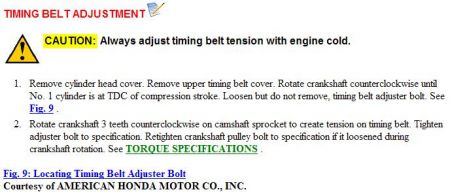

TIMING BELT ADJUSTMENT CAUTION:Always adjust timing belt tension with engine cold. Remove cylinder head cover. Remove upper timing belt cover. Rotate crankshaft counterclockwise until No. 1 cylinder is at TDC of compression stroke. Loosen but do not remove, timing belt adjuster bolt. See Fig. 9 . Rotate crankshaft 3 teeth counterclockwise on camshaft sprocket to create tension on timing belt. Tighten adjuster bolt to specification. Retighten crankshaft pulley bolt to specification if it loosened during crankshaft rotation. See TORQUE SPECIFICATIONS . Fig. 9: Locating Timing Belt Adjuster Bolt Courtesy of AMERICAN HONDA MOTOR CO., INC.

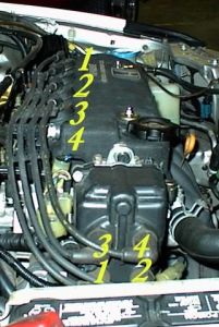

I was wondering how to set the timing on a '95 Honda Civic with a 1.5L 4 cyl. engine. I also was wondering what the cyl. order was on the same vehicle
Jan 5, 2020 at 5:47 PM (Merged)
F4I_GUY
  • CAR REPAIR CONTRIBUTOR
  • 3,302 POSTS
https://images.2carpros.com/forum/automotive_pictures/276698_firing_order_honda_2.jpg
With regards to your timing question, are you referring to camshaft timing? or ignition timing?

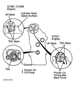

BOBBAR
Engine Mechanical problem
1995 Honda Civic 6 cyl Automatic
I see no markings on the cam pulley to line up the timing belt .I don't want to do it wrong is there a way to find some markings ? need help please
F4I_GUY
  • 3,302 POSTS
The cam gear should say UP on it. You want to make sure that the UP mark is indeed facing upwards.
On the side of the gear (90degrees of the UP mark in both directions) there will be little slots on the gear. This will line up with the edge of the cylinder head.
Hope this helps.
If you do not see any marks, just set the crank to TDC and mark your own marks, but be careful that you do not loose the marks that you made while the belt is off.
