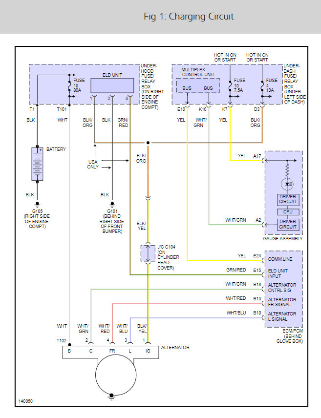

I already got a new battery and alternator installed plus a new Electronic Load Detector (ELD) but the battery light stills stays on. Everything is good and charging, its just that light wont turn off. Can someone point me out in the right direction before I tear up the wiring from the alternator to the fuse panel under the dash, to the computer and finally to the indicator light in the dashboard? Thanks in advance.

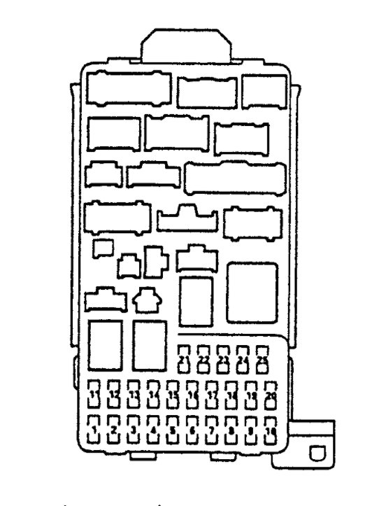

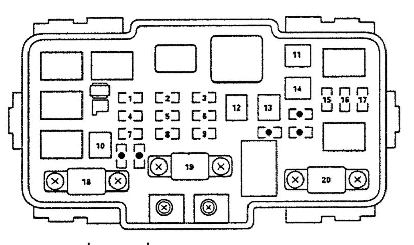

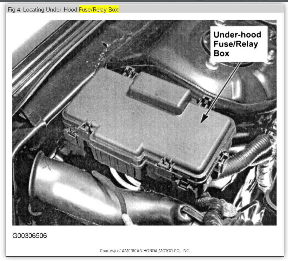

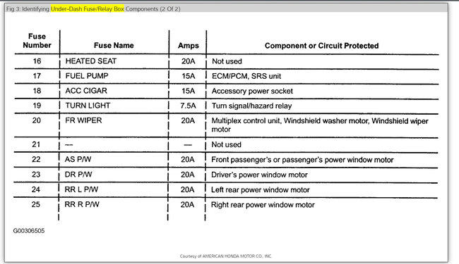

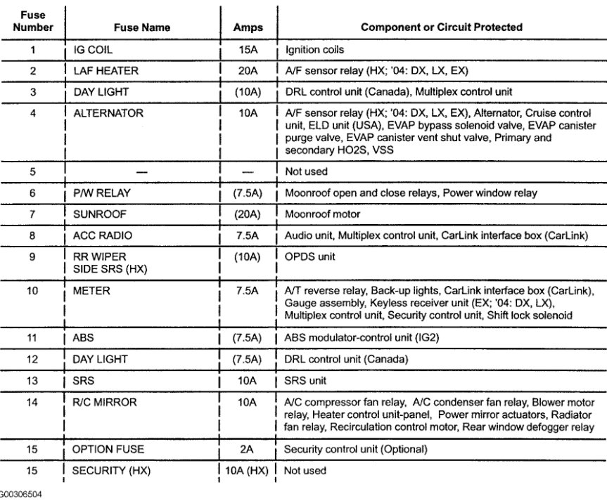

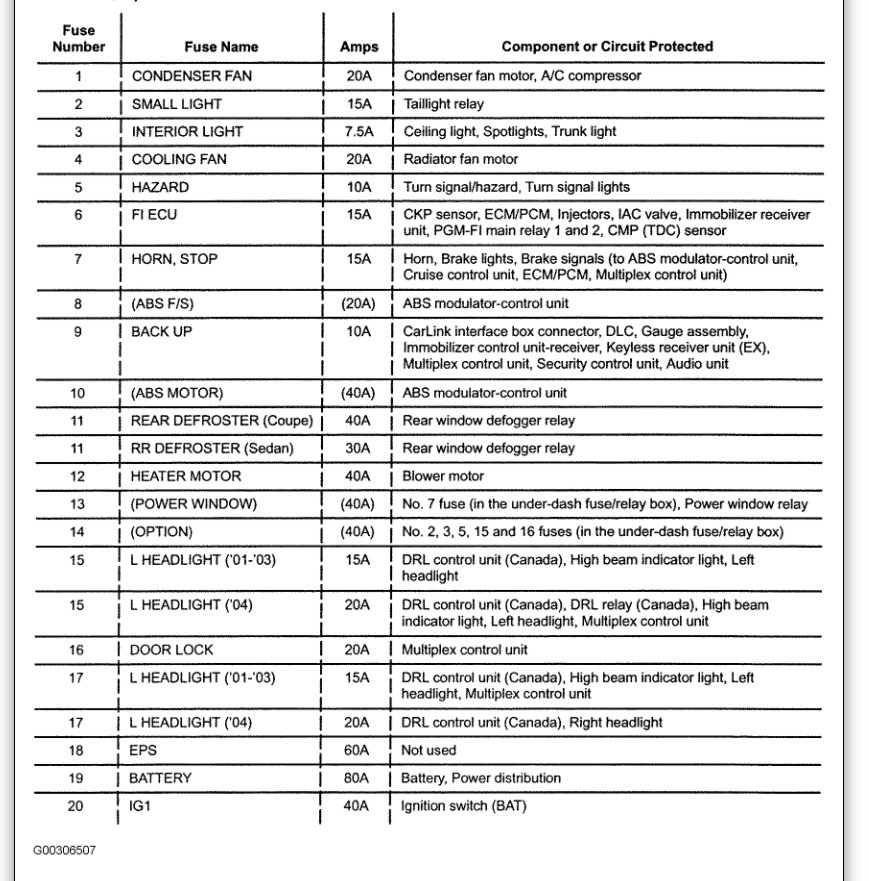

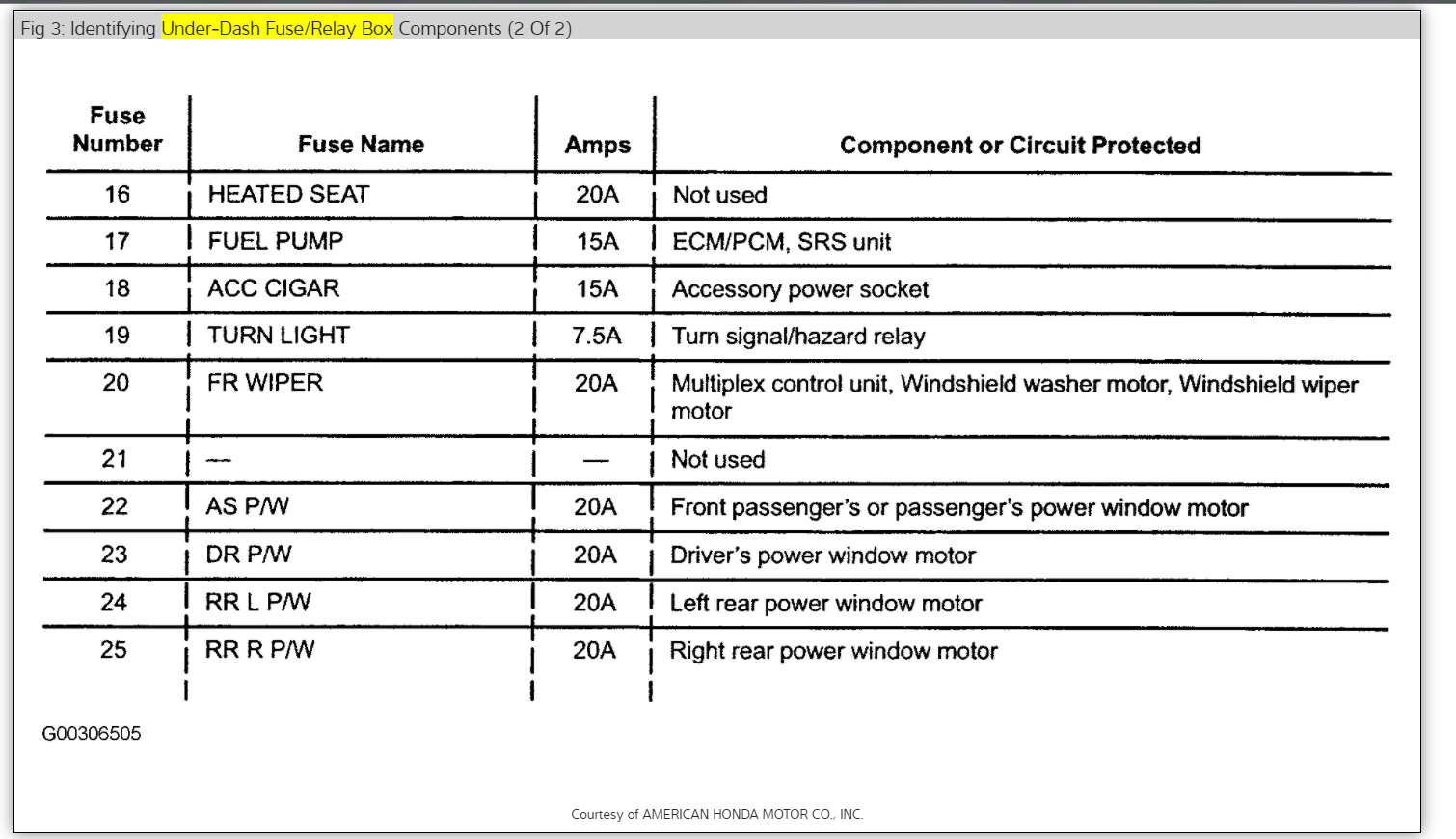

There are some wiring connections that need to be confirmed. Here is a guide to help you do some testing along with a alternator wiring diagrams so help you see how the system is connected.
There is also three fuses that run the systems as well.

has new alt, battery cable ends
fuses all good
replaced lcd relay in engine compartment fuse box also new
its charging but battery lite stays lit

Most likely the multi-plex control system underneath the dash has failed. These are hard to diagnose because some parts are wireless and read frequencies. I'd bring it to a electrical diagnostic shop or Honda to have them confirm what the problem is.
