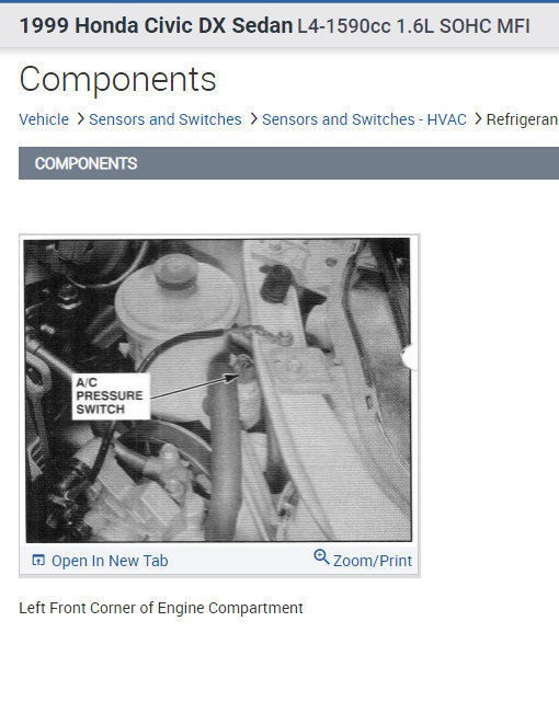

My ac works great and is very cold for a few minutes and then the compressor turns off and only the fan blows.

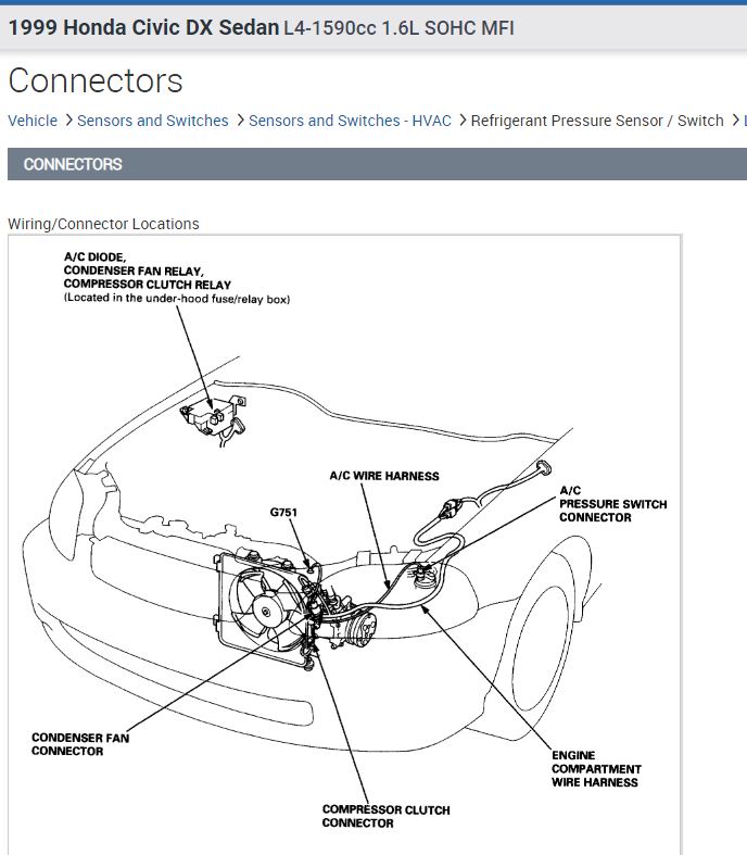

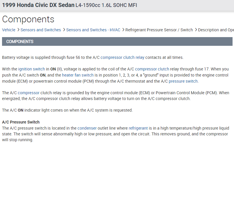

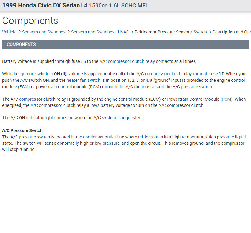

It sounds like you might have a faulty A/C pressure switch.
As the compressor is functional, because you get cold air for a little bit.
But if the pressure switch if bad they it will provide incorrect signal and the compressor will shut off.
The pressure switch if located on the front left corner of the engine compartment.

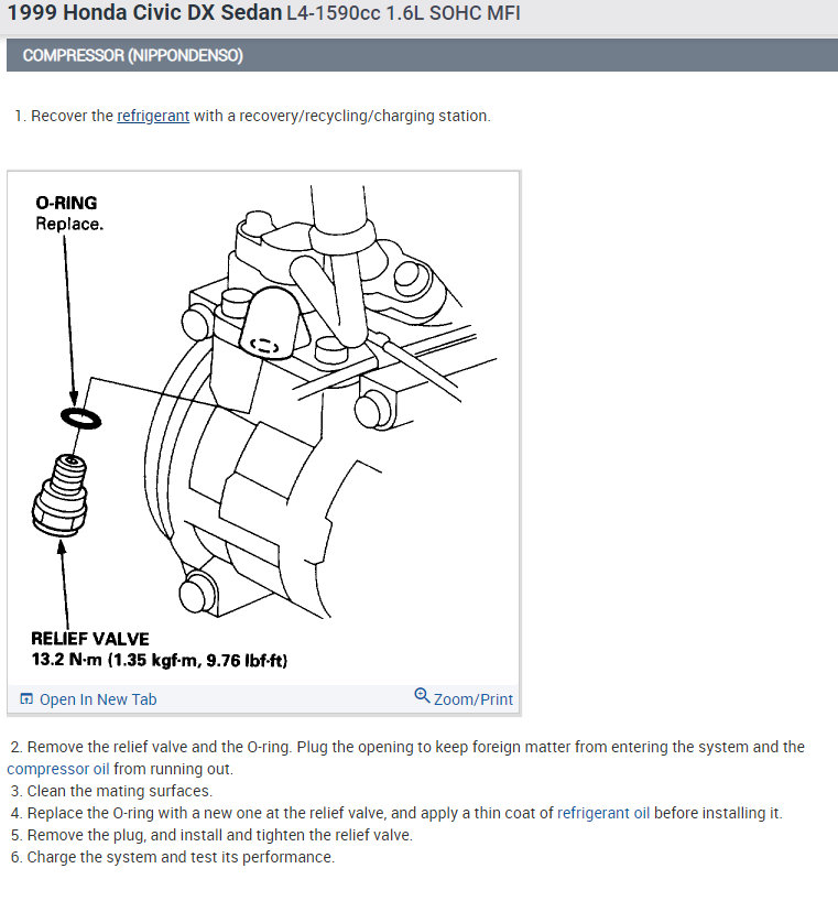

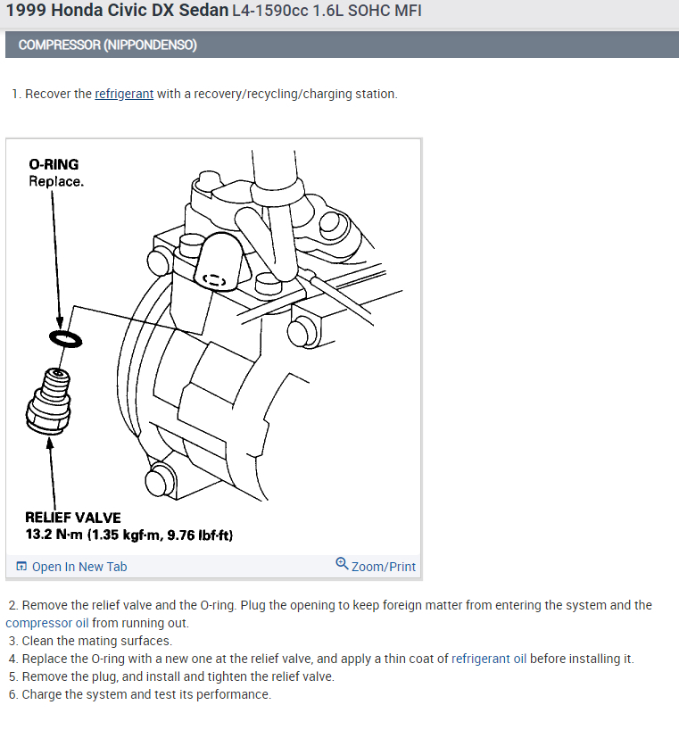

There is also a high pressure safety valve that goes on the side of the compressor, which can trigger this issue as well.
