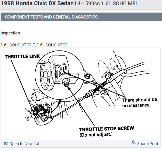

Throttle body issue? Cleaning?
PARKER1980
  • 1998 HONDA CIVIC
  • 4 CYL
  • FWD
  • MANUAL
  • 115,000 MILES

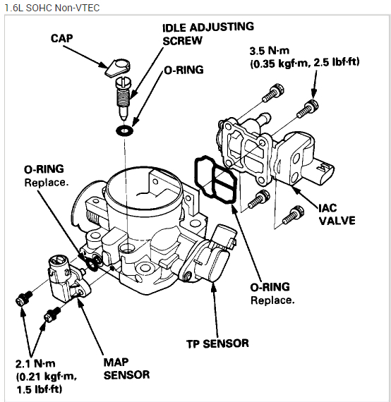

When coming to a stop the cars idle drops and the car cuts off. I have replaced the pcv valve, so I know thats not it. What could be the problem?
Sunday, February 7th, 2010 AT 8:24 PM
SQM
  • 6,383 POSTS

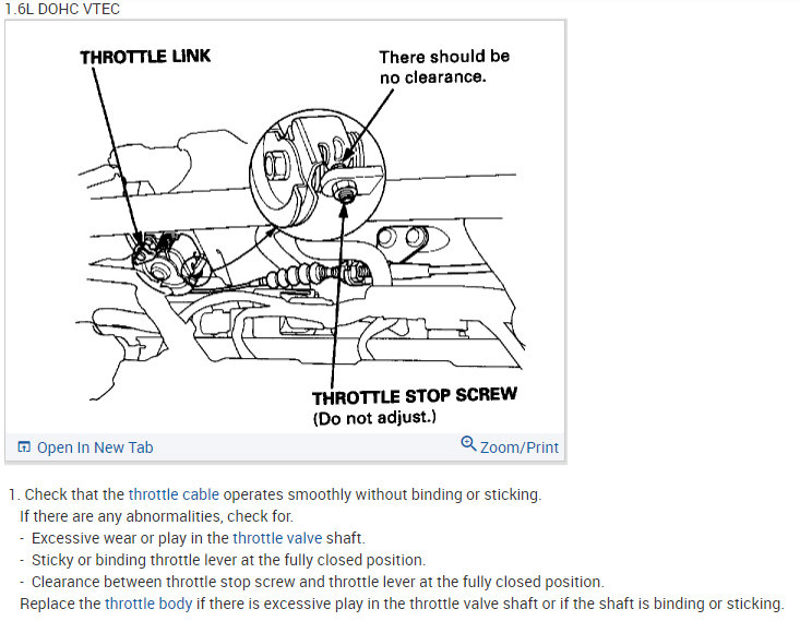

There are few reasons this can happen.
It would be good idea to clean the throttle body if it has not been cleaned in a while. However most times dirty throttle body will cause power loss issue just about any throttle.
Could also be vacuum leak that causing this issue.
Check this article for diagnose vacuum leak:
Is your check engine light on? If so do you know the codes?
https://youtu.be/vMwTzURWXmk
You might find this article helpful:
https://www.2carpros.com/articles/engine-stalls
Any questions please let me know.
