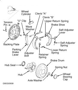

How do you put back together the shoes and springs? Where does it all go. And somehow we messed up where the e brake goes. Nothings fitting

Hi there,
See if this pic helps, there is not much in the text that will be of help.
https://www.2carpros.com/forum/automotive_pictures/61395_brakes_2.jpg
