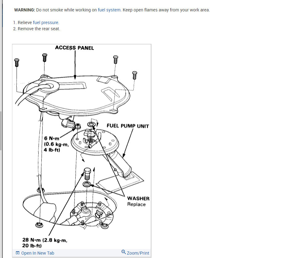

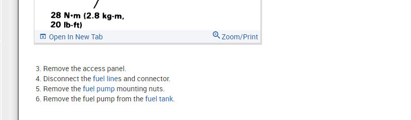

We will need to check the pressure so here is a guide for that:
If this proves out to be a pump issue then here is a guide that will help with replacing this:
https://www.2carpros.com/articles/how-to-replace-an-electric-fuel-pump
Below you will find the process from the manual that will give the remaining detail on this.
Please let us know what questions you have. Thanks
