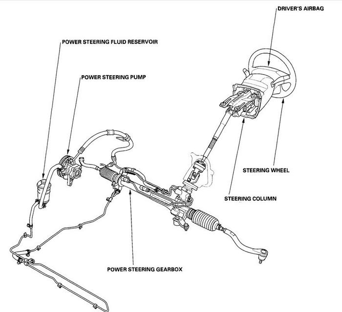

How do I remove the power steering feed hose on a 2004 Honda Accord V6? I have disconnected everything but there just does not seem to be enough clearance to remove it either from above or below. I have seen some discussion suggesting that jacking up the engine or some such other extreme measure may be necessary.

Yes you will need to loosen the engine mounts to sneak the hose out from the car. Here is a video so you can see how a hose is changed with a diagrams below to help you see what to do on your car.

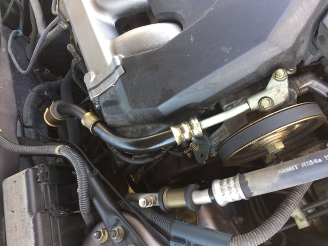

Ps system is noisy, hose little wet.

Preferably use a flare nut wrench so as to not round the head of the fitting. The pressure hose is the one with threaded fittings on both ends. The fittings unscrew counter-clockwise. Follow the same routing as the old hose. Remove one end first and allow it to drain into a pan. Once drained, remove the other end. Which end is which doesn't matter.
Friday, October 19th, 2018 AT 2:20 PM (Merged)
JCCELICA
That part I know, hose already loose, can't seem to get it out by rear mount any suggestion.
+1
RIVERMIKERAT
  • 6,110 POSTS
Both ends are loose?
JCCELICA
Yes, both sides are loose. There is a bracket under the rear mount. Can't find a diagram of the PS system for removal.
RIVERMIKERAT
  • 6,110 POSTS
Can you take a picture of it and upload it?

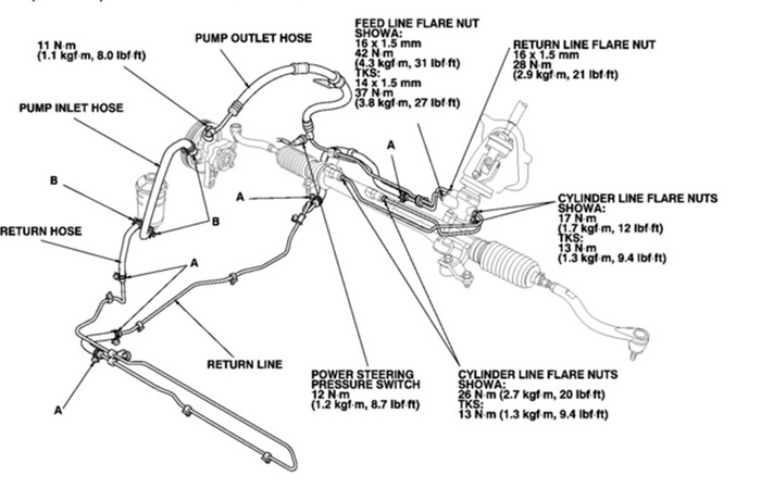

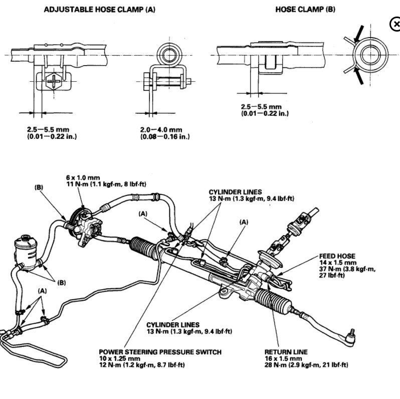

The power steering pressure line has an obvious leak to it, I already bought a replacement I just need a better explanation on how to go about replacing it.
KEN L
  • MASTER CERTIFIED MECHANIC
  • 43,070 POSTS
Yep that one goes to the rack, here is a guide and some diagrams (below) to help you get the job done,
You will need to jack up the car first.
here is a video that will give you an idea on what you are in for when doing the job
https://youtu.be/BGBUv5r9fk0

This is a straight forward job. Loosen the joint at steering rack to drain the fluid. Remove the joint, remove any portion in between that is holding hose. Remove 2 holding bolt at poser steering pump and manouver the hose out.
