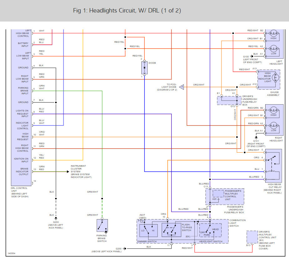

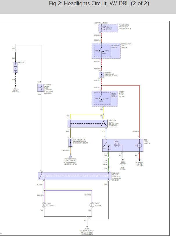

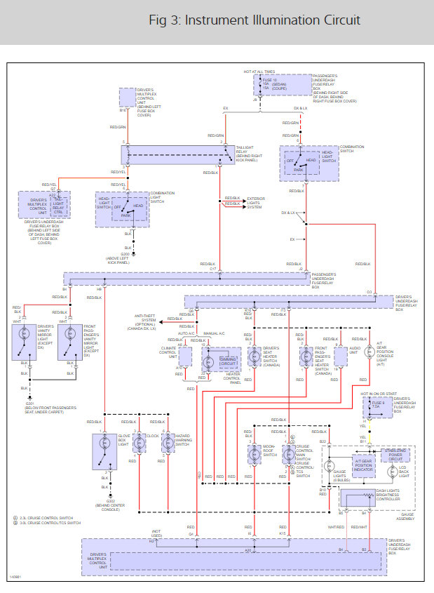

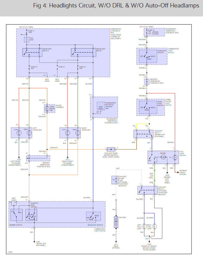

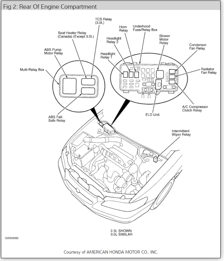

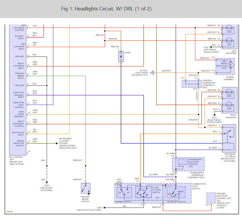

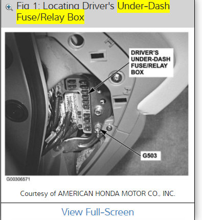

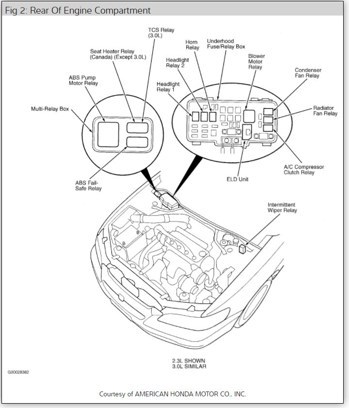

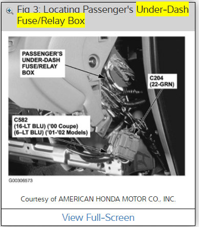

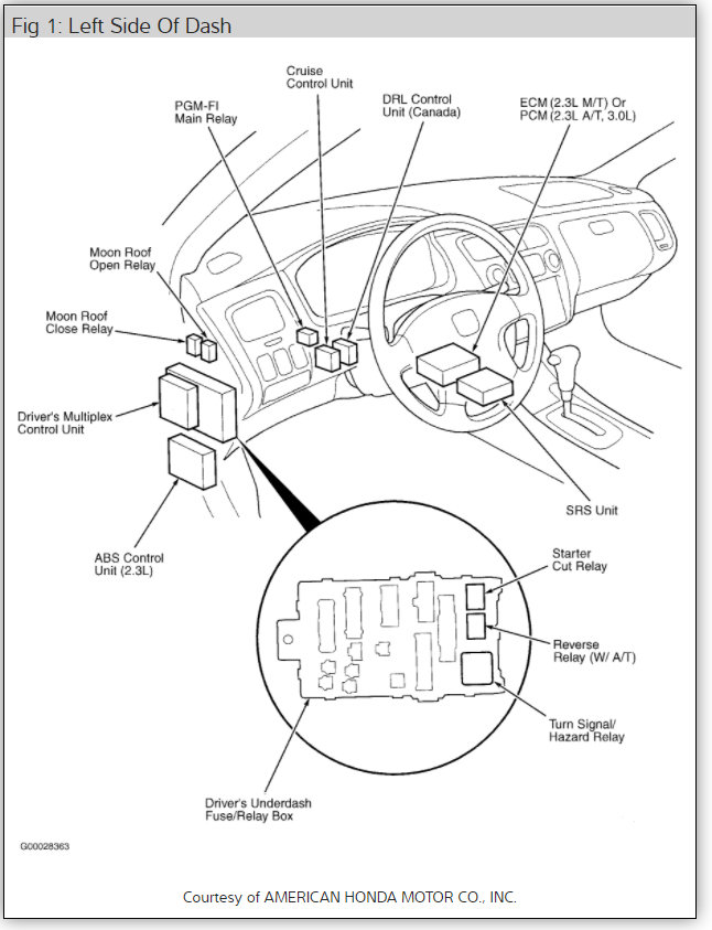

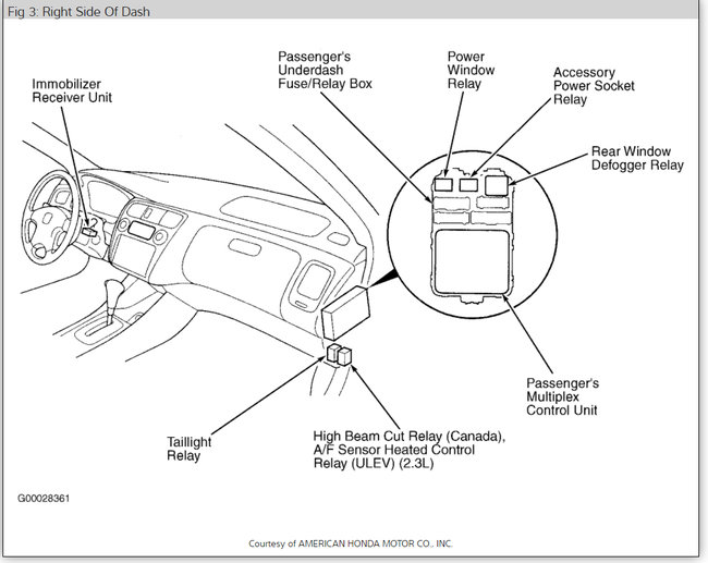

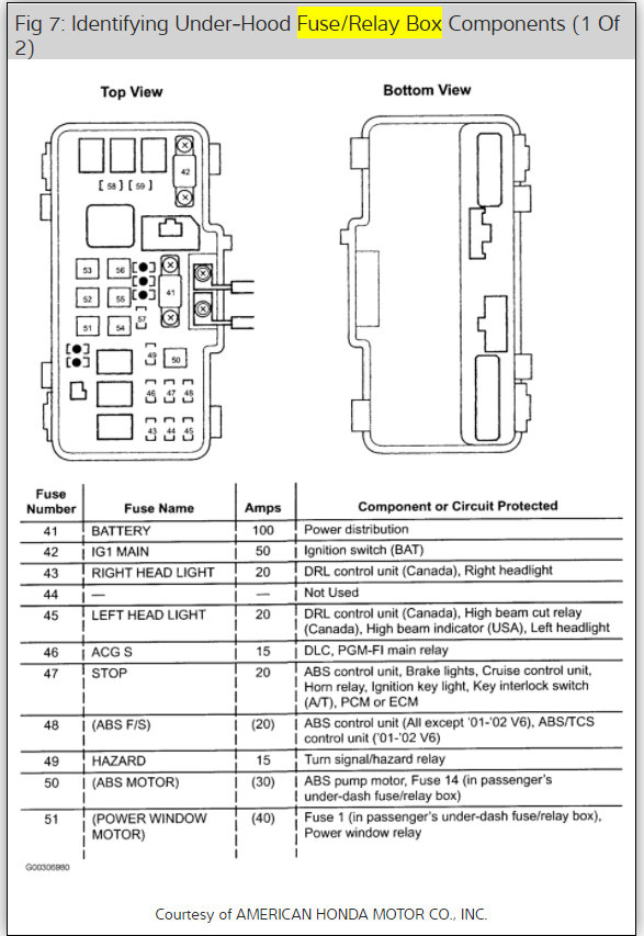

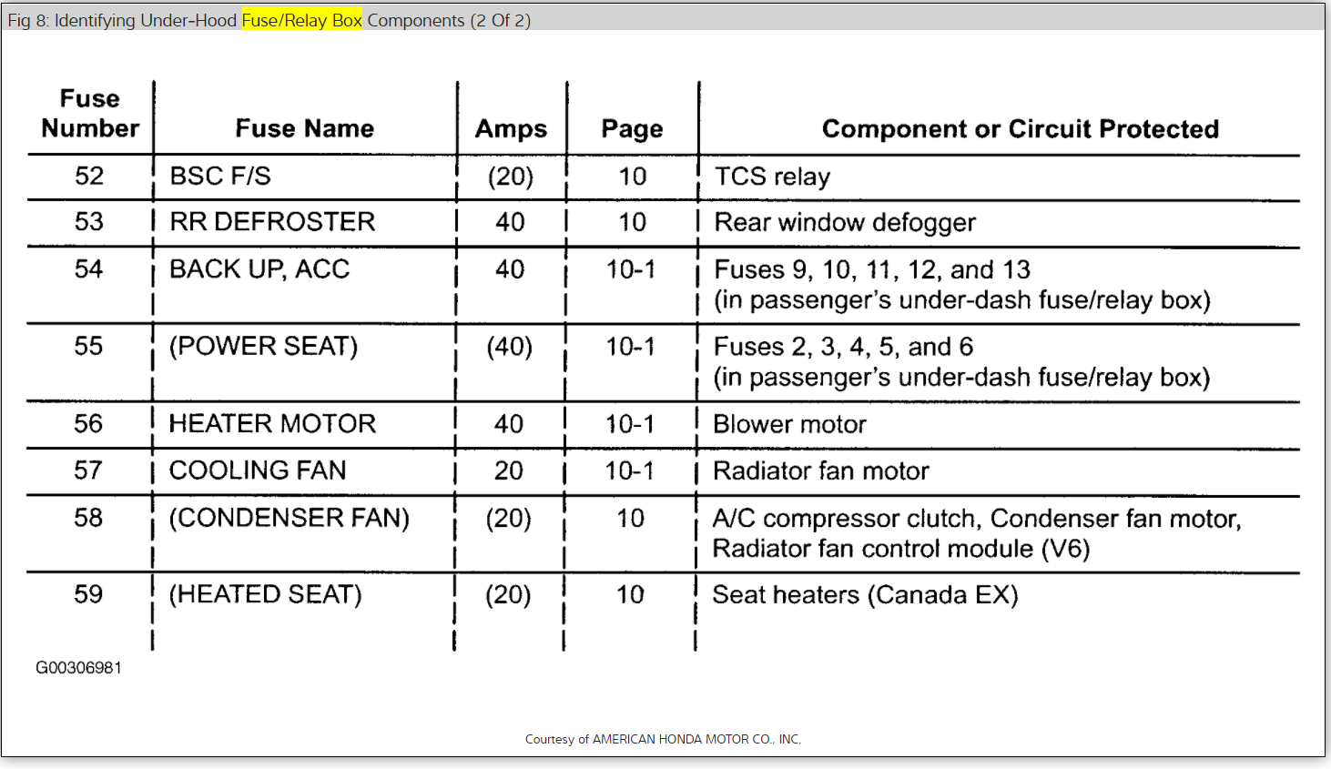

There is a tail light relay that goes out in these cars here is a tail light and dash light wiring diagram so you can see how it works and see the tail light relay powers both of those check it out.
Here are the diagrams fuse and relay locations
Cheers

Thanks for the diagrams, but I double checked the #10 fuse. Sure enough, it was bad. I changed the fuse and all works well. Thanks for your help.
