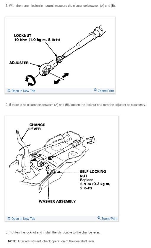

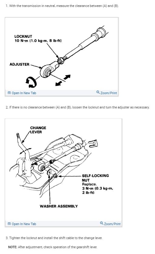

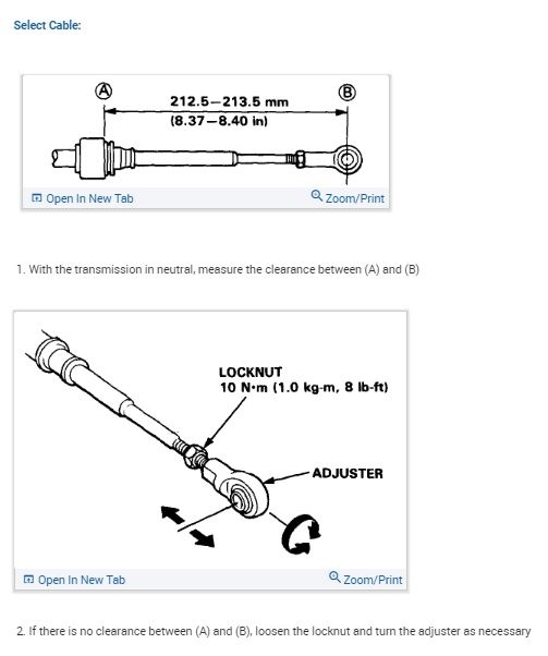

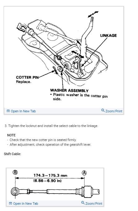

Hi chrisbobb,
Getting the part should not be a problem.
I couldn't find any specific replacement instructions in the manual, I did however find how to adjust them. This will show how they attach to the shifter and how to adjust once replaced
See the diagrams below

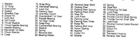

I put in a new shifter cable and when I first drive my car and put it into park I get a loud grinding sound but after that everything is fine just happens when you first put it into park.
Saturday, September 26th, 2020 AT 12:09 PM (Merged)
KHLOW2008
  • 41,814 POSTS
Hi dannyboy63,
Did this happen prior to replacing the cable?
Was the cable adjusted correctly.
If vehicle is not at complete stop, a grinding noise would be emitted when shifted into park.
DANNYBOY63
  • 6 POSTS
As a matter of fact it started happying after I replaced it because when I got the car when I was putting it in park felt like reverse because still wanted to roll thats why I replaced it does it mean it has to be adjusted.
KHLOW2008
  • 41,814 POSTS
The problem seems to be from the trans rather than the cable.
When stationary, the parking pawls should be at a stop. If it is turning, it would cause rachetting noise when trying to engage. This is usually caused by a faulty 1 way clutch/parking gear.
Gear assy is located at end of trans and if you are able to remove the cover, you can check if the lock nuts ( item # 7 and 17 ) are loose, which often happens, and retighten to rectify.
