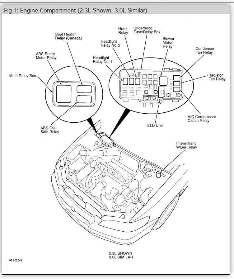

Hi.I'm Danny.I have a 2000 Accord. The AC stop working, I checked the power to the compressor, and it's missing.I also checked the high pressure switch and it's working and it has 4.66 V. The AC light inside it's on. I need to know where is located the Ac relay, or if someone has a repair manual. What I have to do to diagnose the system.
The compressor does not engage. A friend of mine told me do not jump the compressor directly from the battery, because I can burn the compressor, some of the cars are using less than 12v for the compressor. He said.
Thanks in advance

Hello Danysony,
The location for the air conditioner relay is under the hood, the diagram below will show you where.
Here is how you test the relay
If the compressor does not engage when you turn on the A/C, see if it will run by jumping the compressor clutch wire directly to the battery (use a fused jumper wire). If the compressor works when you jump it, and the A/C blows cold air, the system contains refrigerant and the fault is likely a bad A/C compressor clutch relay or a bad clutch cycling switch or pressure switch.
If the compressor does not engage when you jump it, the problem is a bad compressor clutch.
If the clutch engages but the compressor does not turn (the belt will start to slip and squeal), the compressor is locked up and you need a new compressor.
Here is how you replace a compressor

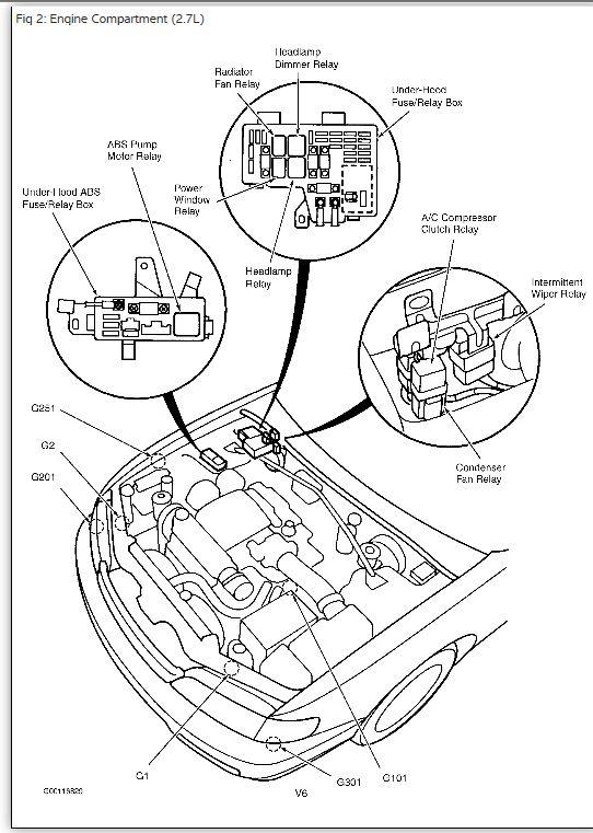

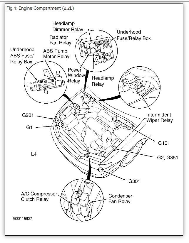

Hi There, I need help locating the AC clutch relay on a 1997 Honda accord v6. It's not under the fuse/relay box under the hood and I don't see next to the ac condenser fan which is were it is located on 4 cylinder models. ?

Attached is a diagram of Relay location.

This diagram is for the 2.2 liter. I need one for the 2.7 liter
Tuesday, June 30th, 2020 AT 7:17 PM (Merged)
DRCRANKNWRENCH
  • 3,380 POSTS

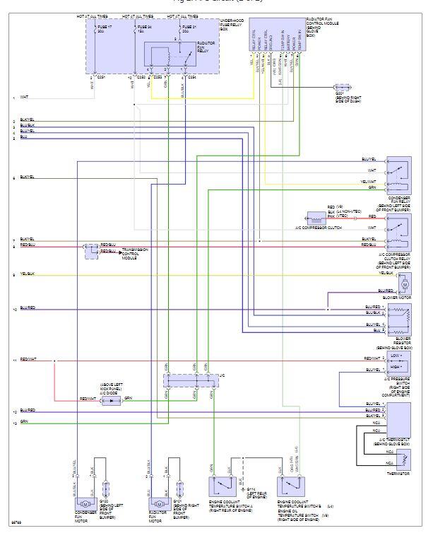

Sorry it took so long. Attached is wiring diagram for 2.7L AC system with description of location. Also there is a pic of engine compartment location.
