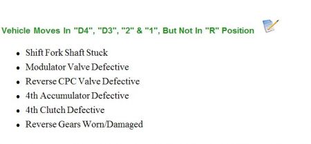

Seems the trans is failing. Attached are the possible causes.
https://www.2carpros.com/forum/automotive_pictures/192750_Reverse99Accord_1.jpg
