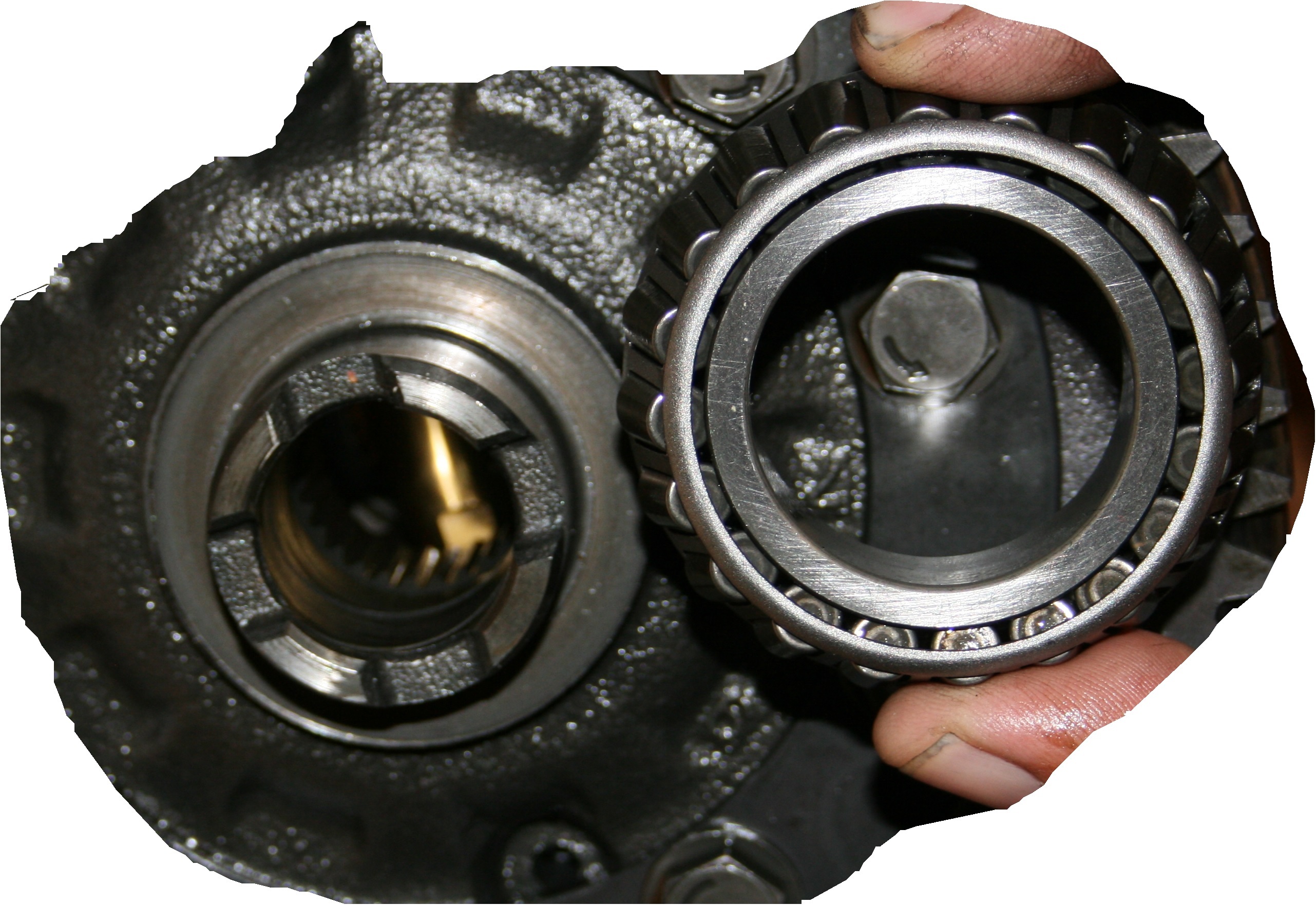

ZEMORZEMOR
  • 486 POSTS
This is the picture of the bearing that I talked about
+1
Tuesday, July 7th, 2020 AT 2:57 PM (Merged)
CARADIODOC
  • 34,463 POSTS
I don't see anything obvious there, but it's hard to tell from a picture.
ZEMORZEMOR
  • 486 POSTS
I know they press in those bearing on the differential house, but mine I can put it in and take it off by hand its not tight on the differential anymore. What could causes that?
