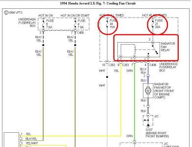

RBRAZELL1
  • HONDA ACCORD
I have a 1994 Honda Accord 2.4L Automatic Transmission. When you turn the car off, the cooling fan does not turn off at all. I used to be able to pull the fuse for it, but now it stays on. I had the fan relay under the hood replaced last summer. The mechanic says it could possibly be the ECM going bad. I am stuck with this one, because it can kill the battery. Please send response.
Sunday, January 5th, 2020 AT 7:09 PM (Merged)
  • 75,992 POSTS
Could be the coolant temperature sensor/temperature switch/relay and last the PCM

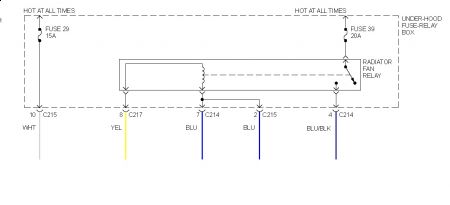

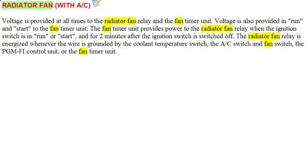

I just replaced the cooling fan on the driver's side of the radiator as the original one stopped working. Now the fan runs without the vehicle being warm, meaning after running the engine for a few minutes the fans starts running and continues to run after the car is off and not anywhere near operating temperature. Is the problem with the radiator fan control module/fan time relay module brain?
+1
JDL
  • 16,098 POSTS
Hi, thanks for the donation, found this info in our database. Are there any applicable trouble codes for the fan? As you can see from the fan relay wiring, the voltage for the load/switch side of relay is hot all the time. Voltage to the coil side of relay, goes hot when the key is on, yellow wire. The relay is energized by the ground circuit , solid blue wire/s, several switches have control over the ground circuit, right now, I'm not sure which one is causing the problem?
https://www.2carpros.com/forum/automotive_pictures/170934_honda_radiator_fan_1.jpg
https://www.2carpros.com/forum/automotive_pictures/170934_honda_fan_relay_wiring_1.jpg
