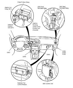

Behind the glove box
https://www.2carpros.com/forum/automotive_pictures/30961_fan_1.jpg
https://www.2carpros.com/forum/automotive_pictures/30961_fan1_2.jpg
+1
Sunday, January 5th, 2020 AT 7:08 PM (Merged)

Checked both fans. Wires hot to relay, jumped and fans came on. I have located fan module, how do I check it?

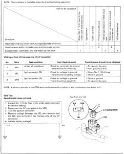

I just moved from michigan to california and drove this car the whole way. It broke down 5 times due to issues with the radiator and transmision. I have put a great deal of money into this car coming out here and there is still more to be fixed. I'm trying to save some money by doing some repairs myself.

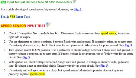

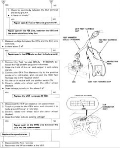

Problem number one is the car's speedometer stoped working all of a sudden. It happened right when the engine started to overheat for the first time. I dont know if there is a connection there or not. Anyways, it did not completely stop working. It would come on every once in a while for a second or two and then quit again. From illanois to california the tripometer only said I went 56 miles. That is just how much of the 2,500 mile trip the speedometer worked. I was just wondering what is wrong with it and how I might fix it.

Looks like the car is doing great for you even though you say you have put a great deal of money into it since it has about 160000 miles. It is time certain things start to go though.

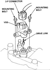

Number One: My first thought is the Vehicle Speed Sensor. I have attached a few troubleshooting charts for you and some pics and directions on how to change.
https://www.2carpros.com/forum/automotive_pictures/248015_d_1.jpg
https://www.2carpros.com/forum/automotive_pictures/248015_a_1.jpg
https://www.2carpros.com/forum/automotive_pictures/248015_b_1.jpg
https://www.2carpros.com/forum/automotive_pictures/248015_1_9.jpg
https://www.2carpros.com/forum/automotive_pictures/248015_c_1.jpg
1. Disconnect the 3-P connector from the vehicle speed sensor (VSS).
2. Remove the mounting bolts, then remove the VSS. NOTE: The VSS drive link is a very small part, be careful not to lose it.
3. Install in the reverse order of removal.

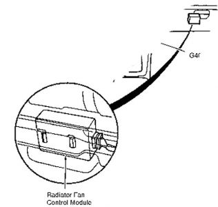

- Now the fans. I have attached some info below on the operation of the cooling system for your reading pleasure.
- Cooling fan operation is controlled by the fan timer module, which monitors signals from a thermo sensor, underhood temperature sensor and the A/C compressor clutch. The timer operates the cooling fan by controlling voltage applied to the fan relay control coil. Battery voltage is applied directly from the main fuse to the relay switch circuit and timer bypass circuit, and voltage is applied to the timer main circuits through the ignition switch start and run contacts. The timer module controls voltage applied to the relay control coil circuit, and the control coil circuit is completed to ground either through the thermo sensor or timing module. When current flows through the relay coil circuit, the relay contacts close and voltage is applied to the cooling fan motor.
During normal operation, voltage is applied to the relay coil by the timer module and fan operation is controlled by the thermo sensor. When coolant temperature is approximately 190 °F, current flows through the relay coil circuit and voltage is applied to the fan motor. When coolant temperature is below 190 °F, the thermo sensor contacts are open and the cooling fan does not operate. However, when the A/C is turned on, the timer energizes the relay coil and the cooling fan operates as long as the clutch remains energized.
When the engine is turned off, the timer module remains energized and monitors signals from the underhood temperature sensor. If underhood temperature exceeds 220 °F, the timer activates the fan relay and the cooling fan is energized. The cooling fan will operate for a maximum of 15 minutes after the engine has stopped or until underhood temperature drops below 220 °F.
- Now the fans continued: Please check all fuses with a volt meter for continuity. Not always is visual okay. Fuses 4, 8, 15, 18, 21, 34. I have attached pics of the fuse panels etc.
https://www.2carpros.com/forum/automotive_pictures/248015_Fan_1_1.jpg
https://www.2carpros.com/forum/automotive_pictures/248015_Fan_3_1.jpg
https://www.2carpros.com/forum/automotive_pictures/248015_Fan_4_1.jpg
https://www.2carpros.com/forum/automotive_pictures/248015_Fan_5_1.jpg
- Question, my information shows 1 fan. Is that all you have?
- Next - when you turn the AC on, the fan should automatically come on. If the fuses are okay, and you changed the fan motor, then I would check the radiator fan relay and the condenser fan relay. Tests below.
- Before we go farther than this, most of the time it is the fuses or relays or motor. So let me know from here on this.

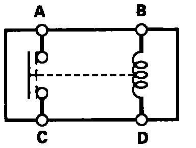

RADIATOR FAN RELAY
https://www.2carpros.com/forum/automotive_pictures/248015_Fan_2b_1.jpg
https://www.2carpros.com/forum/automotive_pictures/248015_Fan_2_1.gif
RADIATOR FAN RELAY TEST
There should be continuity between the A and C terminals when power and ground are connected to the B and D terminals, and there should be no continuity when power is disconnected.
