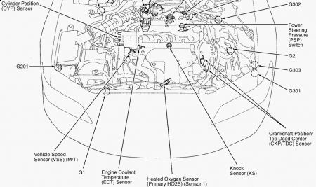

Are'nt there two temperature sensors, one in the thermostat housing and one in the head? Which one am I supposed to test? Also, what is the procedure for testing? Engine running? Where do I place the VOM leads? Connector on sensor or off?

Test with a scantool hooked up that can read degrees and voltage!
https://www.2carpros.com/forum/automotive_pictures/62217_accordECT4_1.jpg
Also at 10 plus years you might want to have a look at the ignition switch, they tend to overheat and bur n the wires...
