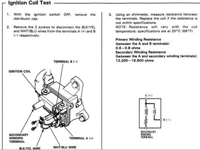

Well if you suspect it's the coil, here is how you diagnose it properly.
https://www.2carpros.com/forum/automotive_pictures/276698_coil_test_5.jpg
Goodluck.

BORA
Thanks for the help,
I will try this tomorrow and see how it goes as I don't have the car today.
I was also thinking could it be the wires?
I guess the car needs a tune up.
Update.
Spoke to my friend and now the car is shaking/chugging all the time. Maybe it could also be a fuel delivery problem?
