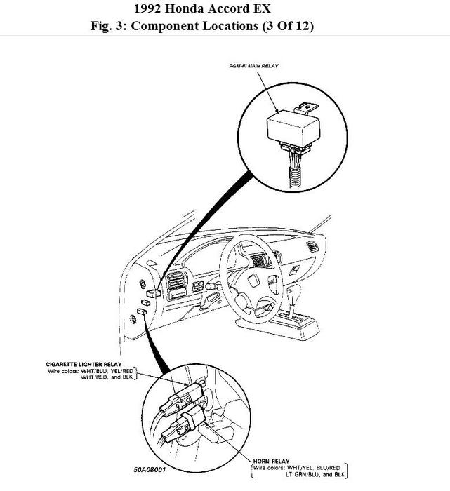

It is a 2.3 liter and what is PGM-FI relay where would I find one would like to perform test before I change it and could you maybe go into more detail wit jumper wirer and test procedjure

Please make sure you read the directions carefully to prevent any problems. The relay is on the car under the dash. As it says you put a jumper wire from the 4 to the 5 plug on the wire side of the female terminals. Then check your fuel pump plug.
