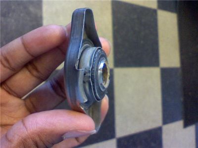

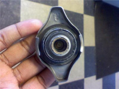

Engine Cooling problem
1997 Honda Accord 4 cyl Automatic 289,00 miles
After abt an hr and a half drive the air cond. stopped working. I turned it off and then at least 10 mins later I felt a hesitation and the check engine light came on and it continued to hesitate. After getting off the highway i noticed a decrease in power. When i stopped at a light the car died. I looked under the hood and there was antifreeze squirted everywhere. At the shop..they couldnt find anything wrong with it..just said it was out of antifreeze..I went to get some but the temp. gauge went past the red before I made it. I pulled over and the overflow was sizzling and smoking. Took it to another shop they put antifreeze in it and ran it for at least an hr...coulndt find anything wrong...no leaks. I drove home 2 hrs and when i got home it was sizzling again and overheated....what can be wrong? The antifreeze still appears to be full..but there was soem spashed just like the first time.

Hi loveofhondas,
Did you retrieve the trouble code for the MIL indicating?
Since coolant is splashed over, there must be some leaking somewhere. Get a pressure test done to check for leaks. If engine overheats very fast with correct coolant level, the most likely cause would be the fans not working or the thermostat is stuck.

Hi KHLow2008,
Thanks a lot. I took it to the shop again this morning. They did another (3rd) pressure check and still said nothing was leaking. He then found the cap for the radiator was broken so thats where it was spraying from. Too bad i didnt think of that could have saved the money and bought a radiator cap myself! Thanks again!!

You are welcomed.
Glad that you have solved the problem.
Wondering why the radiator cap was not checked by the guy who did the pressure test. It has to be removed and the problem would have been as noticeable as a sore thumb.
