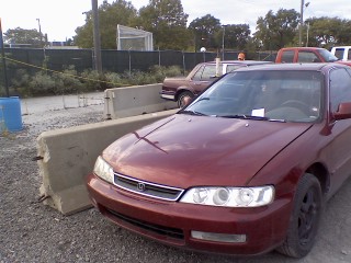

Hello, i recently had my engine washed with some engine cleaner and pressure washed it , i got the engine nice and clean .. i did this round 9 at night ..after i parked it in the garage now its cold and snowy out here but its in da garage.... oh and i air hosed it dry ok .....now the next day i went to work and all was good ....i parked it in the parking lot ..after 10 hrs my shift was over and now i drive the car home now here when the problem starts........When i turn my car off the coolant fan still is going and the heater blower is on in the dash....where as before i turn the key off and everything is off ......ok the fan goes for a little bit thats normal and shuts off but now it just stays on... just stays on completely and the heater still has power li turn it off on the dash but still i can turn it on without the key ...i replaced the coolant relay switch so its not the relay ....and i checked the fuse and its not that so i just took off the fuse now all is off ......but i put the fuse in and everything is on .....so if someone knows whats going on with my coolant fan being possessed i surely would appreciate it ..thanks
