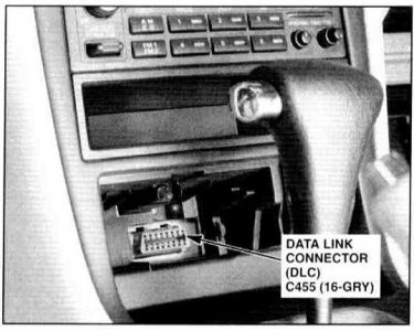

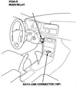

I just bought a Honda Accord but the engine light is on and I have been told that the O2 sensor is faulty. I took it to get it checked in Autozone and they were not able to find the test port inside the car to run the diagnostic in it. The car has been in an accident and the Autozone employee told me that Auto body repair shops sometimes neglect or forget to reinstall the test port inside the vehicle. I would like to know if there is any other kind of way to I can test for an error code?

Hi there,
Data link connector is well hidden. Check behind the ashtray in the center consul.
Mark (mhpautos)
https://www.2carpros.com/forum/automotive_pictures/12900_ct1_1.jpg
https://www.2carpros.com/forum/automotive_pictures/12900_ct2_1.jpg
Front Console
