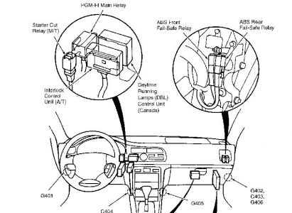

Hi rdtintx,
Try checking the main relay.

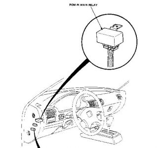

I have a 1991 honda and sometimes it doesn't start, when it does this the green "S" light comes on. The owners manual says the light is the sport mode, but it doubles as a service transmission indicator. I have checked the power supply and the starter. When it does it and I can go back within an hour and it starts right up. I have had it in the shop and they ran a diognostic, but could not make the problem occur and found nothing wrong. All they did was give me a full transmission service. I have also checked the fuel pump. What is the problem?
Feb 11, 2019 at 11:22 AM
(Merged)
Hi daniel.jourdan,
Thank you for the donation.
The problem is usually caused a faulty PGM-FI main relay. It is known to intermittently cause non starting as the fuel pump is not getting the power to work.
Remove the relay and check the circuit board for cracked soldered joints. Resoldering of the circuit board, especially the cracked joints would make the relay work as well if not better than a replacement part.

Hi DanLop785,
This is a common problem for models of that era. It is caused by an intermittently failing PGM-FI main relay and resoldering the circuit board would solve the problem.
