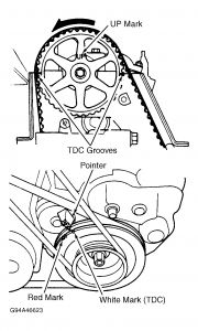

I had the car jump timing and im putting on a new water pump. I need the timing marks please

and
https://www.2carpros.com/diagrams/honda/accord/1994
