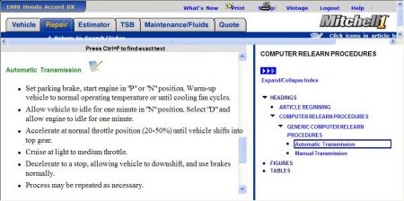

Disconnecting the battery is not a good idea it causes the computer to lose some of its memory data
Try below for the computer to relearn itself
https://www.2carpros.com/forum/automotive_pictures/12900_relearn_3.jpg
