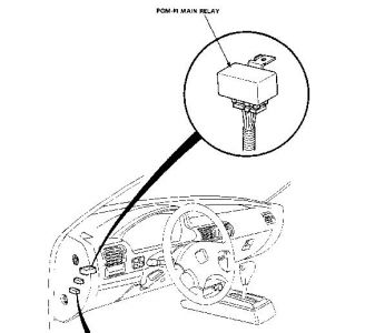

Symptoms indicates a fault with the PGM-Fi main relay. The relay is knowm to intermittently fail due to cracked solders on its circuit board. Resoldering the circuit board would solve the problem.
https://www.2carpros.com/forum/automotive_pictures/192750_PGMFIRelay90Accord_11.jpg
