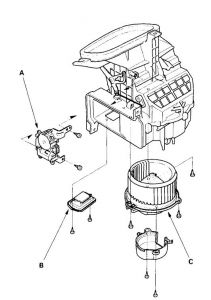

KHLOW2008
  • 41,814 POSTS
Item C is the blower motor.
https://www.2carpros.com/forum/automotive_pictures/192750_BlowerMotorHonda_1.jpg
The above is not for 92 Accord but is similar. Some parts might differ slightly or not used.
