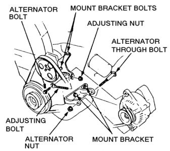

I am having a really hard time trying to get the alternator out of the engine compartment. What do I need to do?

REMOVAL:
Disconnect the negative battery cable.
Elevate and safely support the vehicle.
Remove the splash shield from under the vehicle.
Disconnect the left driveshaft from the steering knuckle. Refer to for procedure.
Unplug the multi-pin connector from the back of the alternator. Remove the clip from the harness bracket
Remove the terminal nut and disconnect the white wire from the B terminal.
Remove the alternator pivot or upper bolt and nut, then remove the belt from the alternator pulley.
Support the alternator; remove the through-bolt and remove the alternator.
The alternator mount or bracket may be removed if desired.
Alternator mounting on 1986-89 Accords
