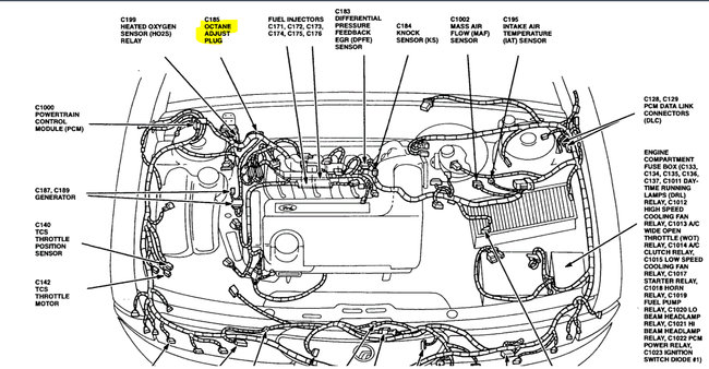

The ultimate goal is to get this car running smoothly. I have found some wiring mistakes and been correcting them. Now I'm trying to find the octane adjust circuit.
Monday, March 15th, 2021 AT 5:00 PM
  • 110,192 POSTS
Take a look at the attached pic. Let me know if it helps.
+1
Monday, March 15th, 2021 AT 5:54 PM
QFONG
  • 92 POSTS
Yes, that helps. Thank you.
