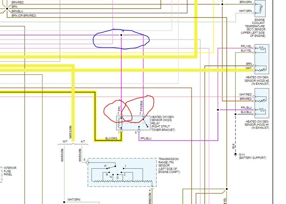

Looking at the Alldata schematic the O2 sensors seem to have two relays, one in the engine compartment fuse box and another mounted to the firewall. I don't see any interconnection between the two.

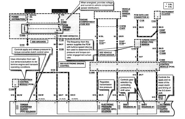

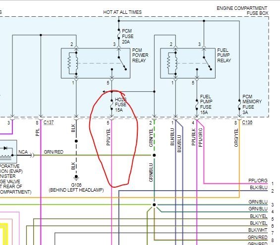

There are two relays in that system, one is the main power relay (PCM) which is powered on all the time and provides power to most of the engine control systems. It also sends power over the purple with blue stripe wire to the O2 sensor heater relay mounted on the strut tower. That relay is turned on/off when the Black with orange stripe wire grounds it, that is connected to the PCM at pin 14. The relay supplies power to the sensor heaters on the purple and yellow and purple and blue wires. The only connection between the relays is the purple with yellow and purple with blue (they change color at the first connection).

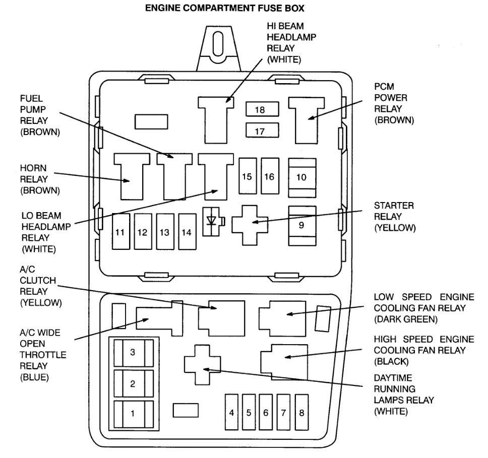

Then what is the HO2S relay for that's in the engine compartment fuse box?

I don't see a second relay for the heaters in that box. Could you take a picture of it and post it? The attached is the OE diagram for that box.

Some one put a white piece of tape on the low speed fan relay and wrote HO2 on it and I was to stupid to realize the mistake. You were right. I'm all set now. Thank you very much for your help.

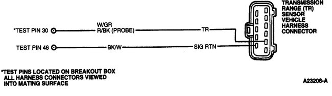

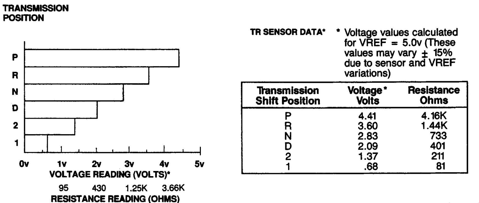

I would start by adjusting the position sensor, that alone could cause the issues you have as the PCM doesn't know what gear the transmission actually is in other than what the sensor is telling it. So if the transmission is physically in say second gear but the PCM thinks it's in 3rd you get the power and shift characteristics of 2nd gear but the transmission won't act that way. Adjustment on them isn't hard but it's a bit of a mess as you need to disconnect the sensor, then use a meter to measure the resistance in the various positions. The reverse lights can help with this. Put the transmission in reverse, then adjust the switch so the lights come on and mark it, then adjust it so they go off on the other side and mark that position, now adjust the switch to the middle of that range. Then do the resistance testing on the indicated pins. If it's in range and works test it on the road.

I detached the wires to pin 30 and pin 46 and took the resistance readings. They were good in all positions. Then I reconnected the wires and took a voltage reading from the pin 30 wire to ground and got the correct voltage readings in all positions.

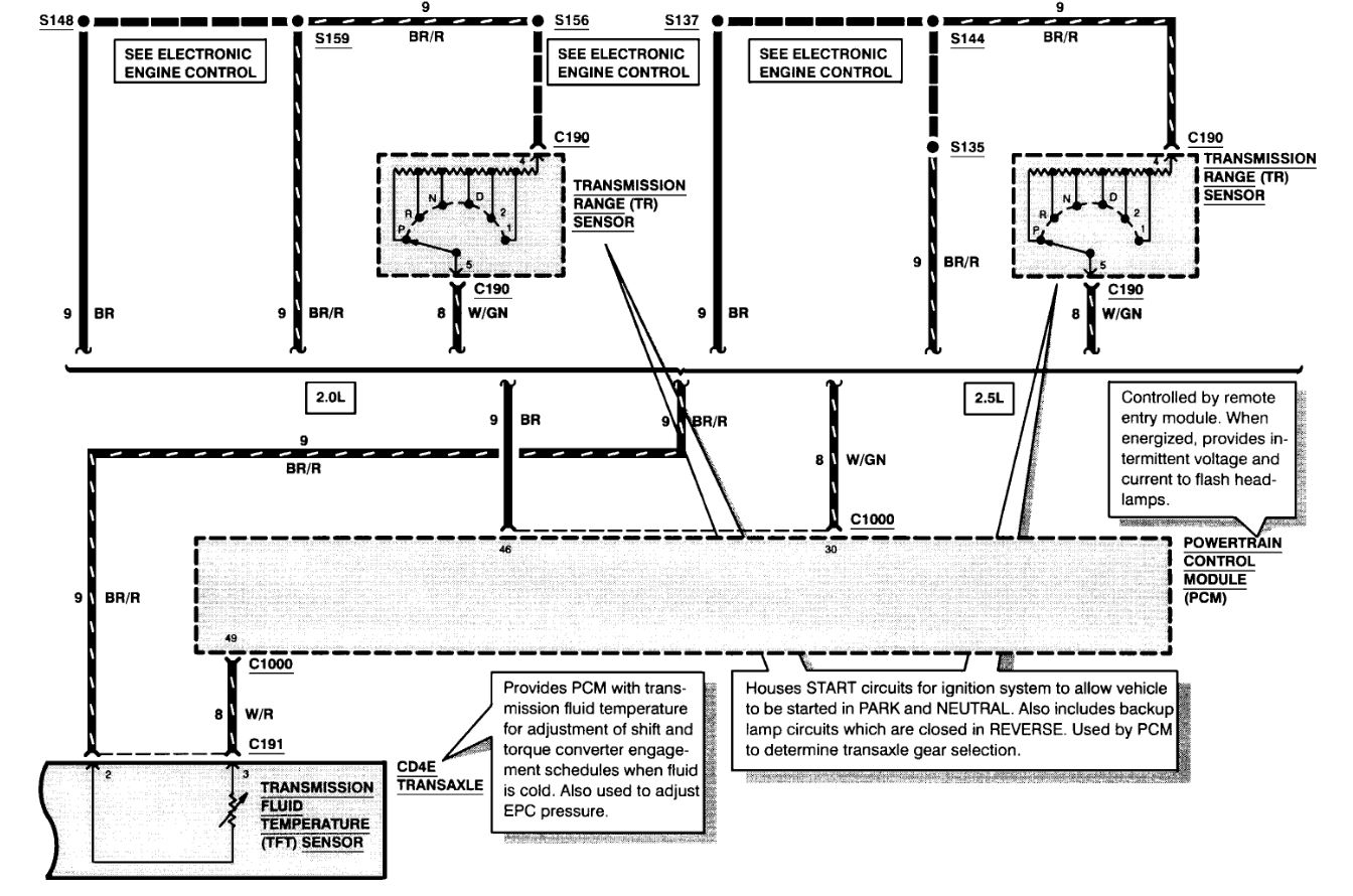

You have quite a list. The definitions for the codes are accurate. The idea that that transmission is giving you trouble is likely related to the temperature sensor. Have you done any checking?

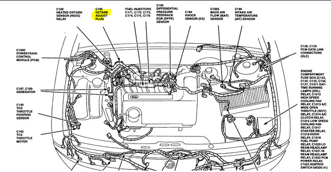

The ultimate goal is to get this car running smoothly. I have found some wiring mistakes and been correcting them. Now I'm trying to find the octane adjust circuit.
Mar 15, 2021 at 5:00 PM
  • 110,190 POSTS
Take a look at the attached pic. Let me know if it helps.
Mar 15, 2021 at 5:54 PM
QFONG
  • 92 POSTS
Yes, that helps. Thank you.
