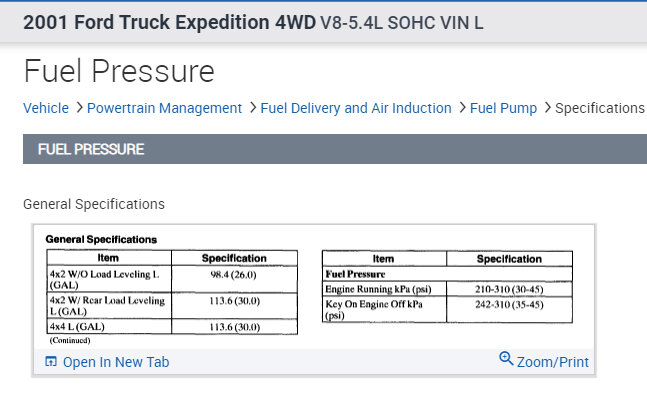

Thanks for the update. I wonder if it is related to a weak fuel pump. By chance, do you have the short-term fuel trims? You provided the long-term above.
If you haven't already, check the pressure to see if it is on the low side of the specifications. Here is a link that explains how it's done:
I attached the manufacturer's fuel pressure specifications below for you.
See pic below.
+1
Friday, December 2nd, 2022 AT 9:16 PM

Don’t have access to fuel pressure gauge when depressurizing system for gas filter good pressure shot from Schroeder valve for good 4 seconds.
Saturday, December 3rd, 2022 AT 2:07 PM
  • 110,194 POSTS
I would recommend using a gauge. 20 psi would shoot from the Schrader as well as the specs.
As far as the trims, they actually look good. Can you tell where the noise is coming from? Is it loud enough for you to record and upload for me to hear?
