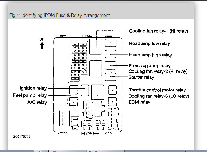

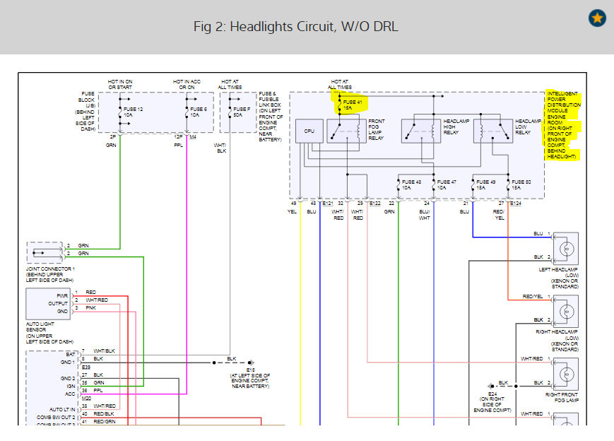

Where's the fuse(s) located for the headlights.
Jul 27, 2019 at 10:02 PM
SCGRANTURISMO
  • CAR REPAIR CONTRIBUTOR
  • 4,897 POSTS

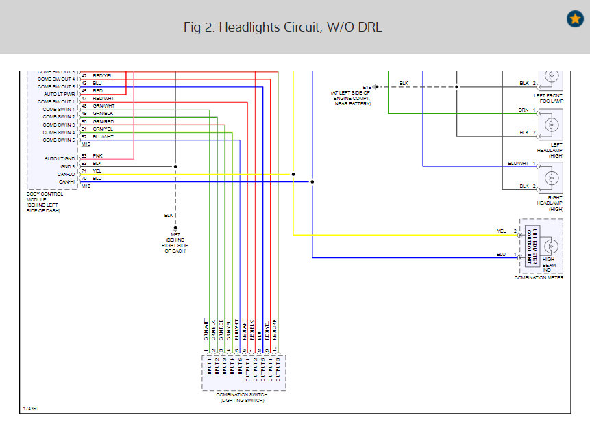

It is Fuse #41(15A) of the Intelligent Power Distribution Module (IPDM) which is located on the right front of the engine compartment, right behind the headlight. In the diagrams down below I have included the wiring diagram of your vehicle's headlight circuits with the fuse highlighted for you as well as a diagram of the IPDM. Please go through these guides and get back to us with what you are able to find out.
