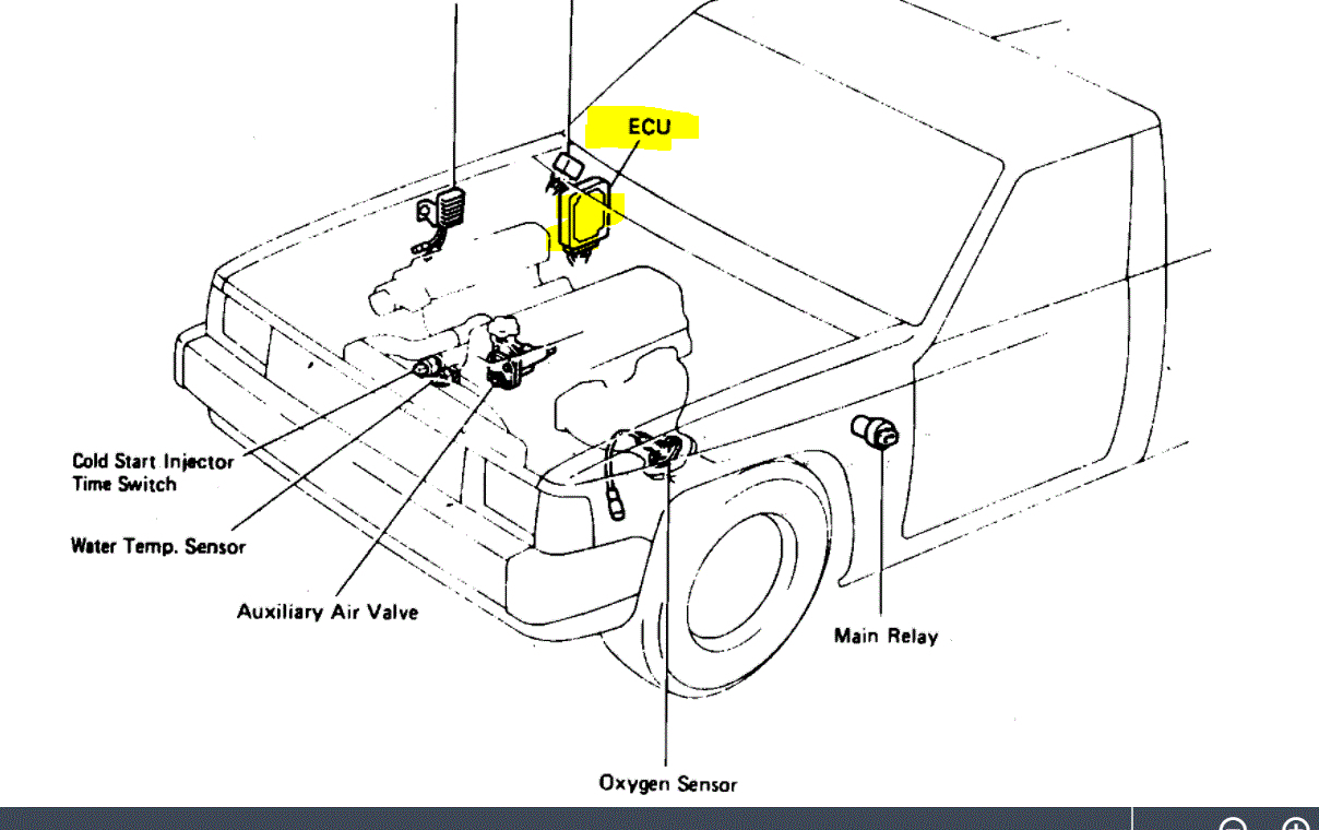

You sent me a post a while back that was supposed to have a picture of the ECU never received that picture, I have kept everything you have sent me and will print it and put it in my book. Thanks for your help

I'm so sorry. I thought I sent that. I attached the location below. Also, to check for a vacuum leak, what you suggested is how it's done. I don't use starting fluid because it is so much easier to cause a fire. Instead, I use carburetor cleaner.
Take a look through this link and let me know if it helps.
Also, an intake leak will certainly cause issues. Let me know if you are able to find one.
Take care of yourself.
See pic below.

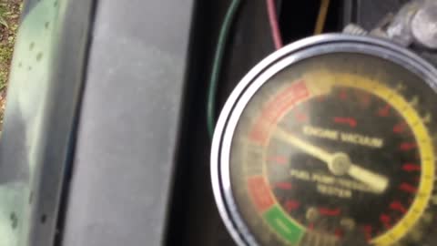

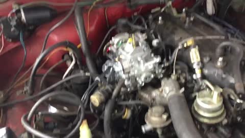

In the first video I didn’t see any spark/arc I think it sounds better in this video than the first one I sent you, I sprayed carburetor cleaner and the engine did not speed up. I sprayed the intake, vacuum lines, brake booster, and other parts. The 2nd video is of the vacuum gage that I believed he had hooked up to the carburetor I believe I’m not sure.
I never noticed the butterflies on the carburetor changing at all either hot or cold, I may have to take it to another mechanic I know, don’t seem to be getting anywhere with my friend in town. Working out in the cold doesn’t help either.

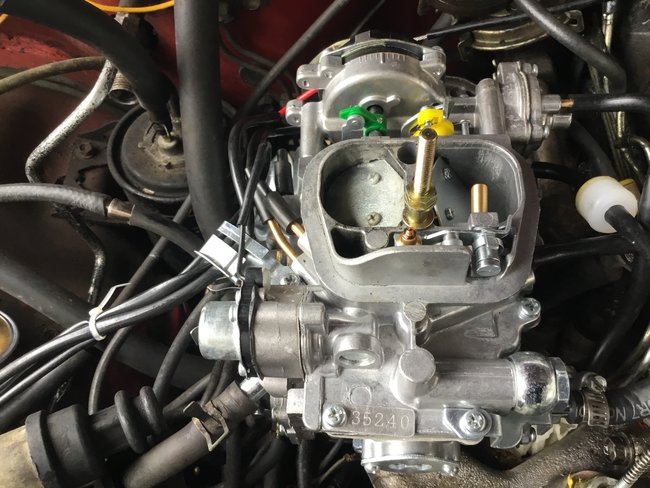

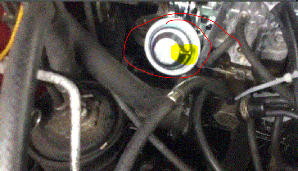

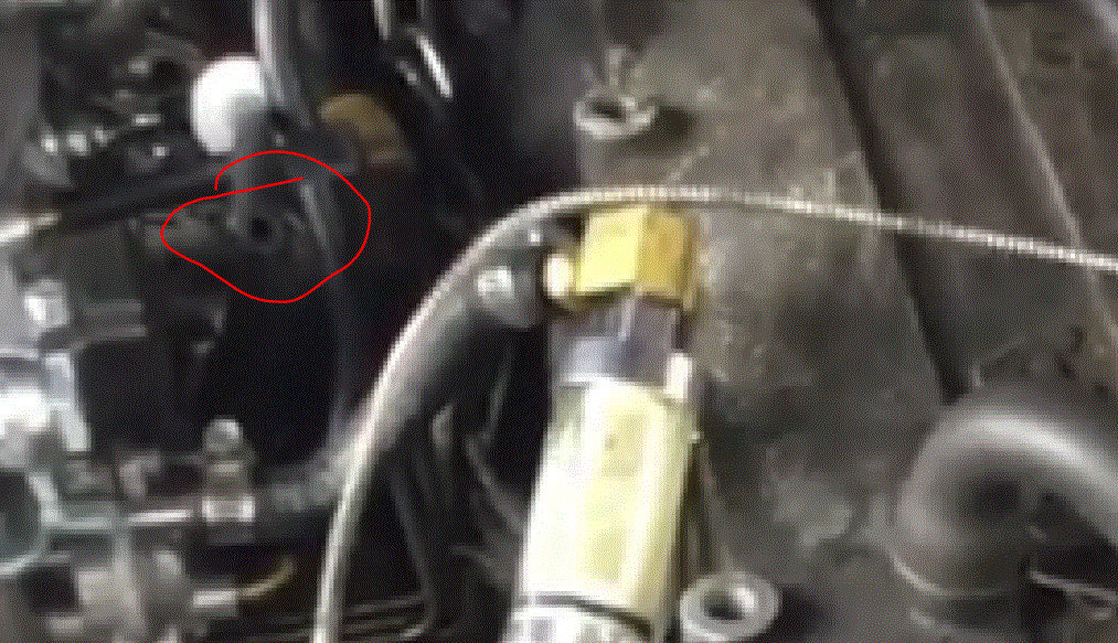

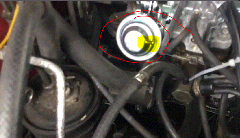

I hope you are feeling better. I looked at the pics and listened to the videos. I think I spotted two potential vacuum leaks. See pics below. The pics are from the video.
Next, at the very end, it sounds like the engine RPMs raised and it sounded like a misfire. Have the plugs been checked along with wires, distributor cap, rotor, and so on? What is the idle speed (RPMs)?
Next, the misfire or rough idle is almost rhythmic. When it happens, I hear a rattle. Could that be coming from the catalytic converter?
Also, if the engine was at operating temperature, I would think the choke would have opened more. That can be causing a rich fuel mixture.

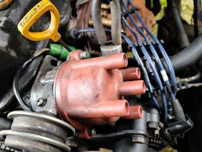

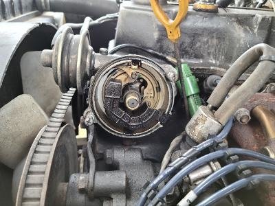

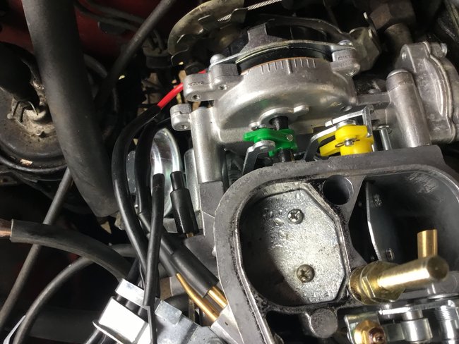

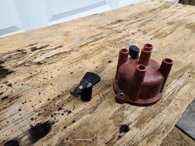

Things are going slow with the truck, the person working on it has COVID. I went and got the distributor cap off and the rotor cap off, to have it matched to get a new one. I have added the pictures of the distributor and rotor cap.

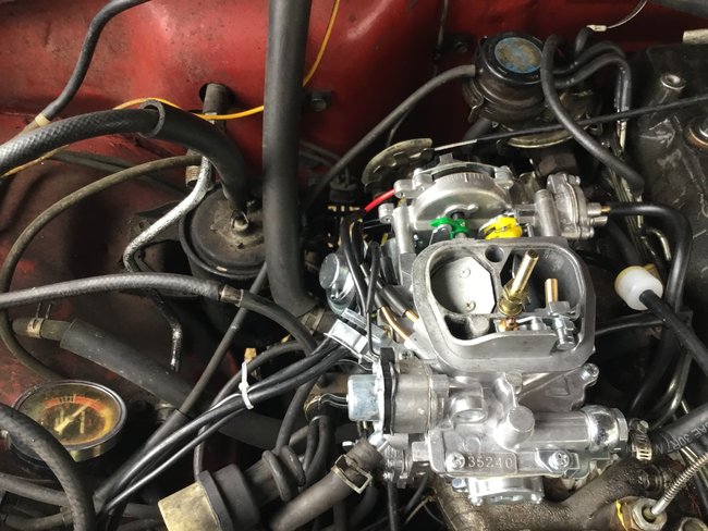

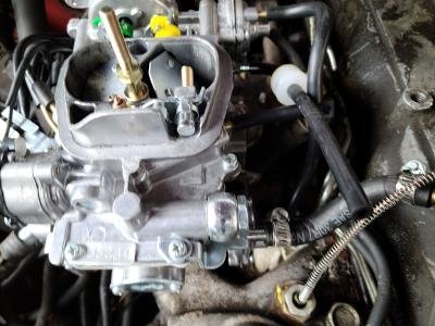

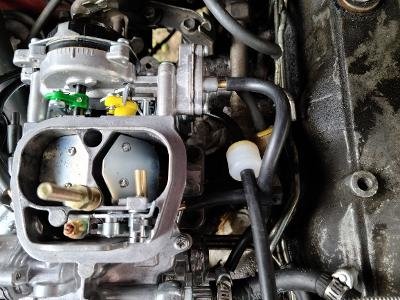

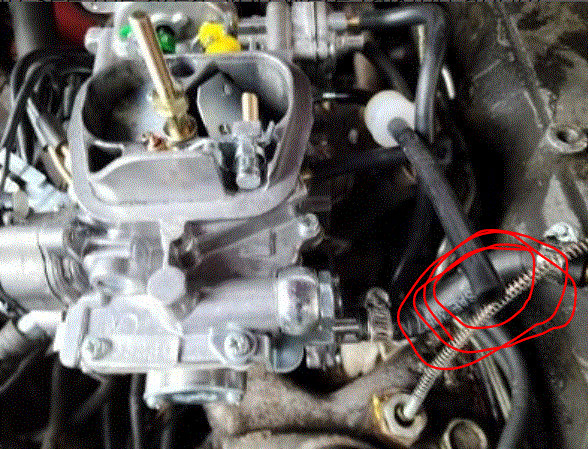

Joe, I have taken to pictures of the area of the carburetor where you said the vacuum leak might be, see if you can see the area, you were talking about.

Joe, things are going slow with the truck, the person working on it has COVID. I went and got the distributor cap off and the rotor cap off, to have it matched to get a new one. I have added the pictures of the distributor and rotor cap.
Joe, I have taken two pictures of the area of the carburetor where you said the vacuum leak might be, see if you can see the area you were talking about.

The rotor looks really corroded. Also, does the inside of the distributor cap look the same?
I attached a copy of your pic below. The hose I circled appears to be a disconnected vacuum hose. With the engine running, see if there is a vacuum at it. Or, plug it with a bolt and see if it changes how it runs.
I'm not seeing the other one I mentioned.
