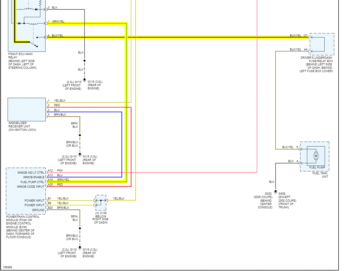

I put my key in and it won't start, the fuel pump doesn't come on and it won't let me shift out of park.

Yes, the starter engages. It'll crank but not turnover and the only things I know of not working is the fuel pump and the shifter. I thought maybe my key is not registering right because it seems security related.

Is there an anti-theft or security light staying on? Also, make sure the brake lights are working. The park release switch is powered by the brake light switch.
Do this and let me know.

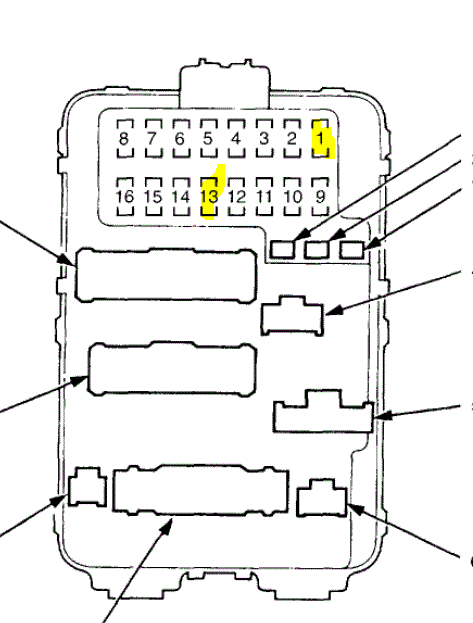

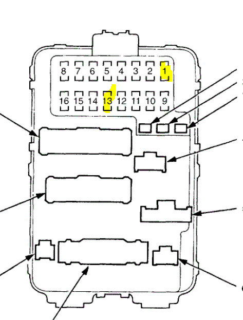

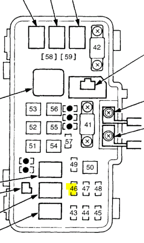

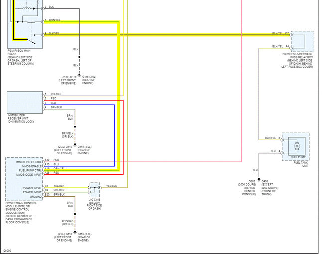

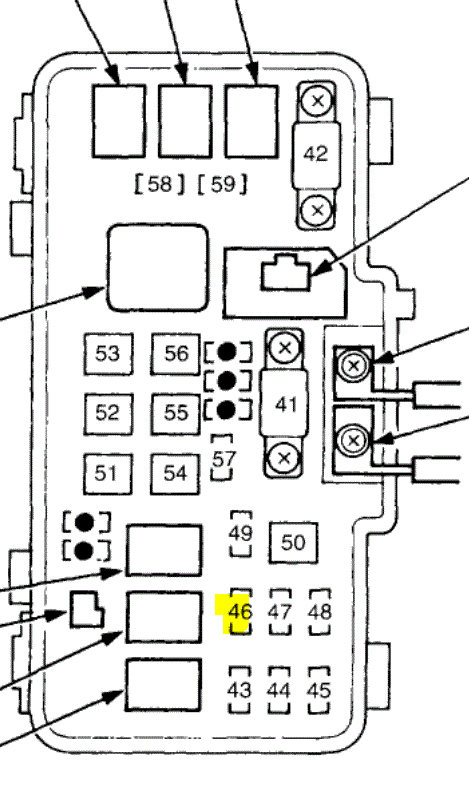

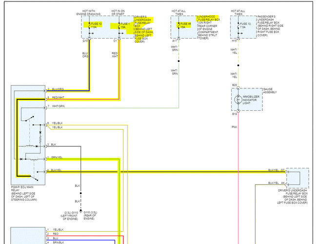

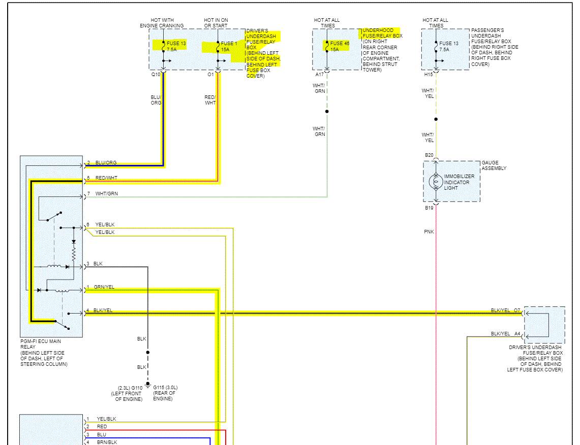

Also, I attached the wiring schematic for the fuel pump circuit and immobilizer. I highlighted three fuses. I need you to check them. In addition to checking the fuse itself, make sure there is power to and from the fuse. Here is a link you may find helpful:
Let me know what you find.
See pics below. Pics 3 and 4 show the fuse locations.

No, the security key doesn't come on at all and brake lights are working.

Were you able to check the fuses I indicated above? We need to determine if the pump is bad or if there is an electrical issue.
Remember, even if the fuse appears good, confirm there is power to and from it.

It was the fuel pump relay.
