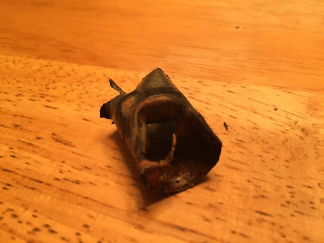

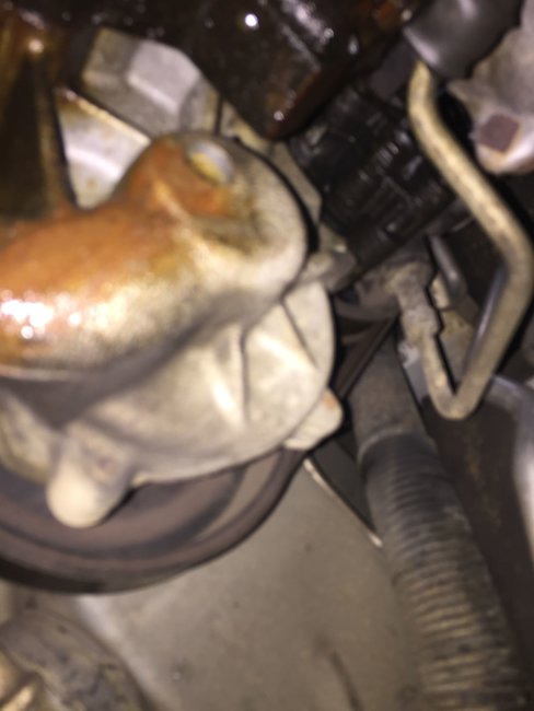

Where the heater return line connects to the back of the water pump housing, the tubing that is pressed into the housing is broken.

If it is pressed into the housing, then you need a new water pump.

It is not the replaceable part of the water pump it is the housing or body of the pump.

If it is a separate housing, then you need the separate housing. If it is not a normal wear item that would be sold aftermarket, then you may have to go to the dealer to find it.
