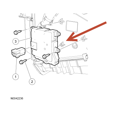

Check for a vacuum leak to heater control valve it's underhood fi both hoses hot then check temp actuator on lh side of heater, pic included.

My middle cool/heat select switch when I put to heat won't engage the damper? Just sit and clicks I beleive it's defective
how can I test and or replace? P.S if I leave it in the cool position it doesn;t click and I get cooling but no heat when in hot range

The heat in that vehicle is controlled by a blend door that regulates heated air flow. It is operated by an electric motor/actuator. The problem can be that the actuator is stripped or inoperative or the door itself could be damaged. This is what needs to be determined by examining the actuator and see if it is responding to heat change commands or not.
