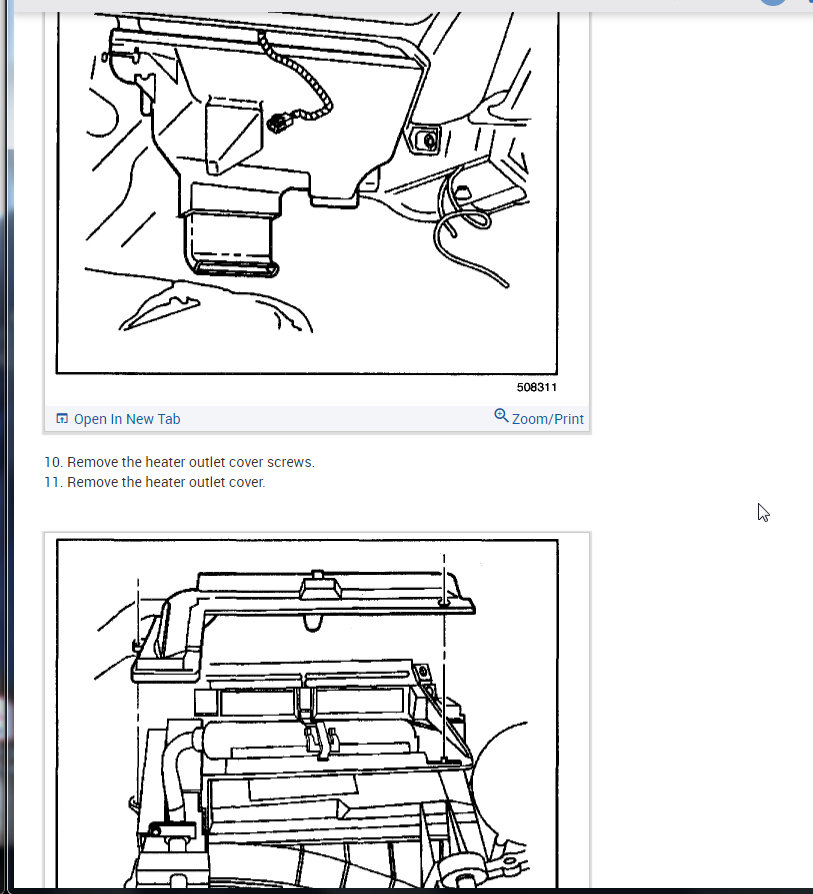

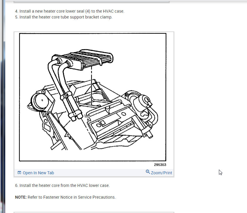

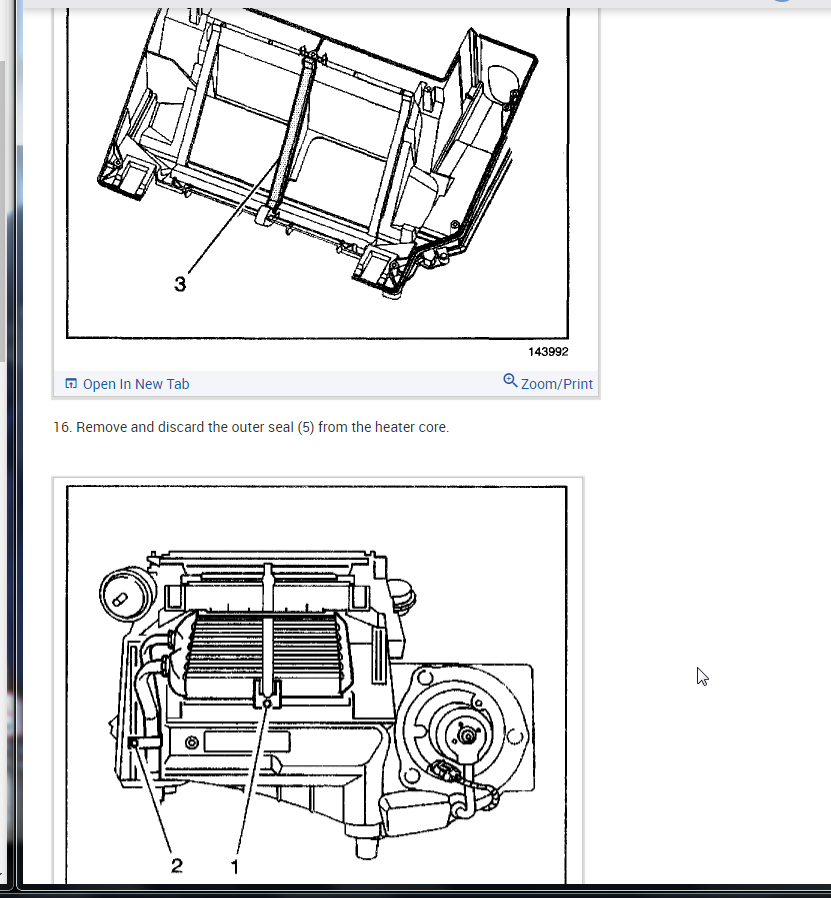

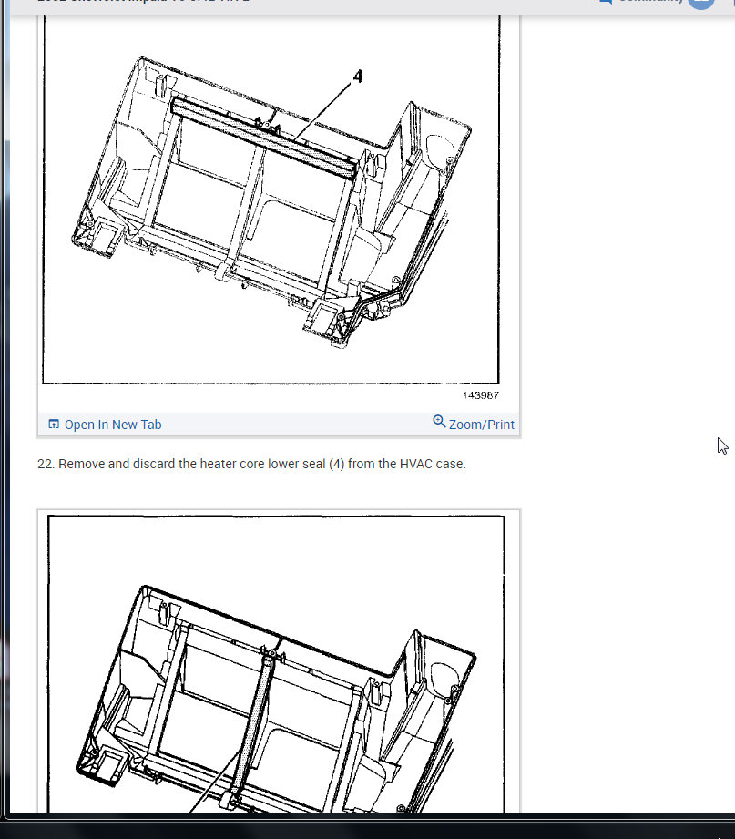

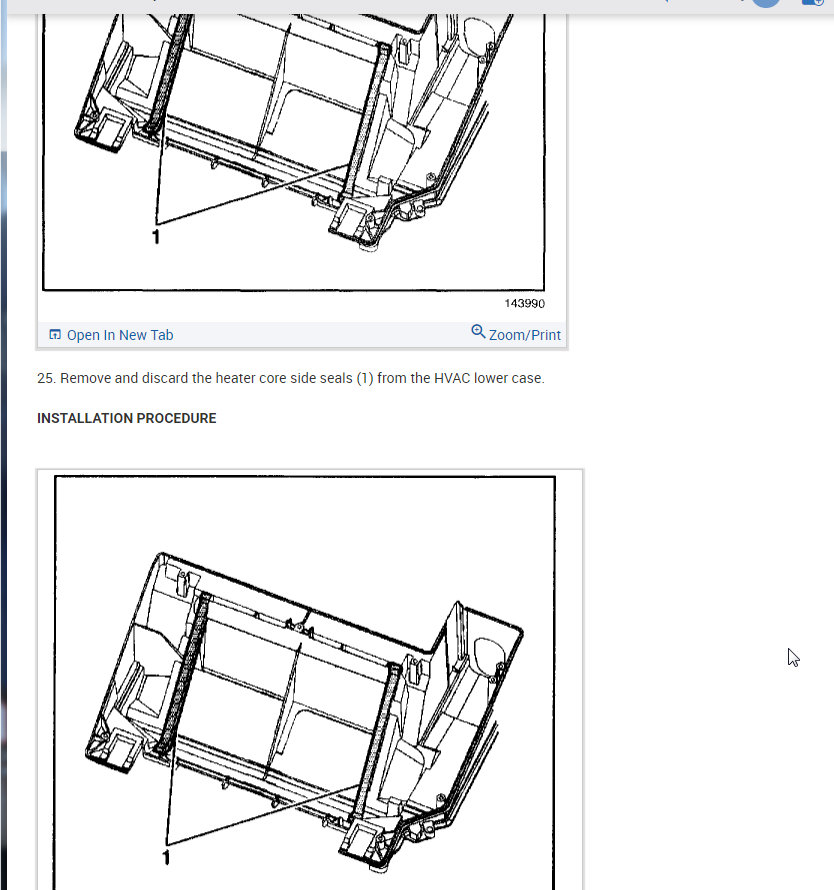

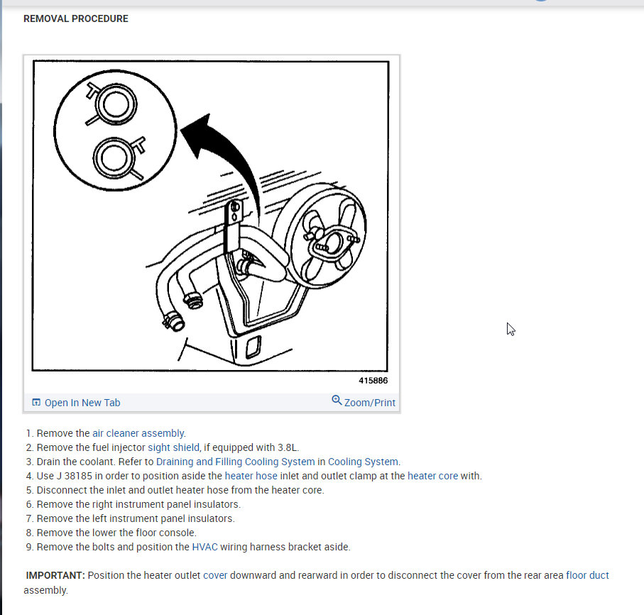

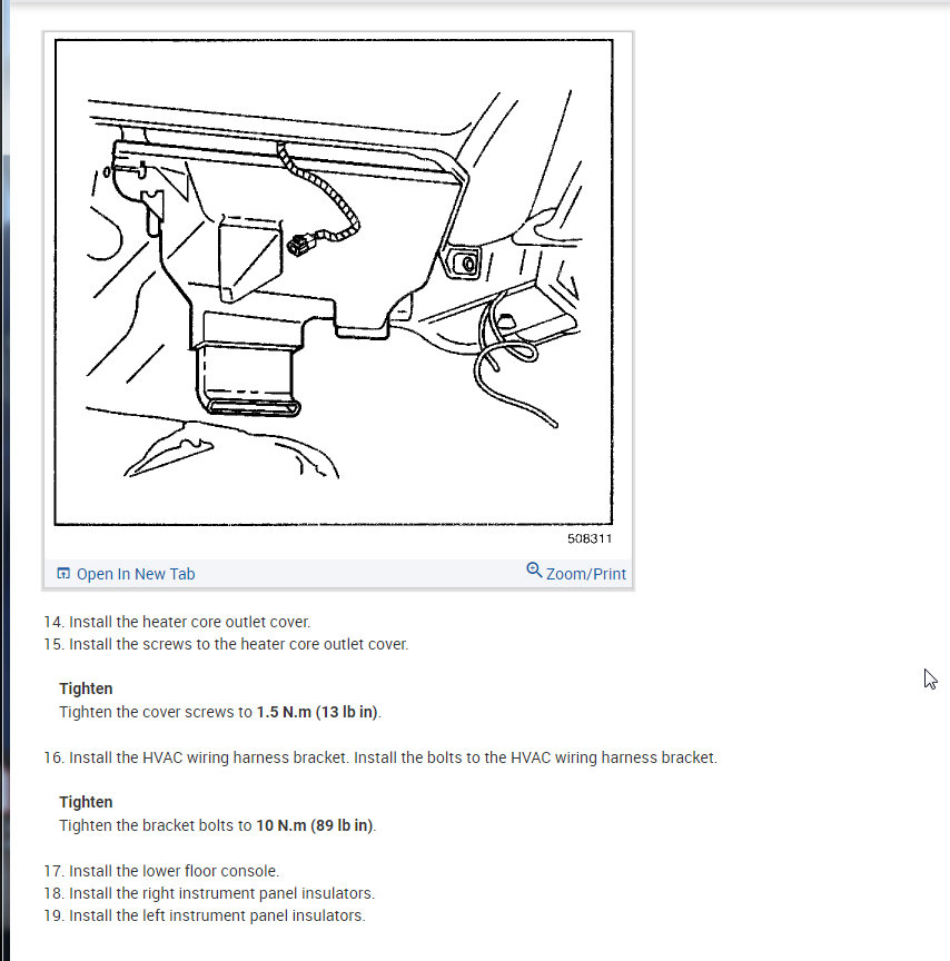

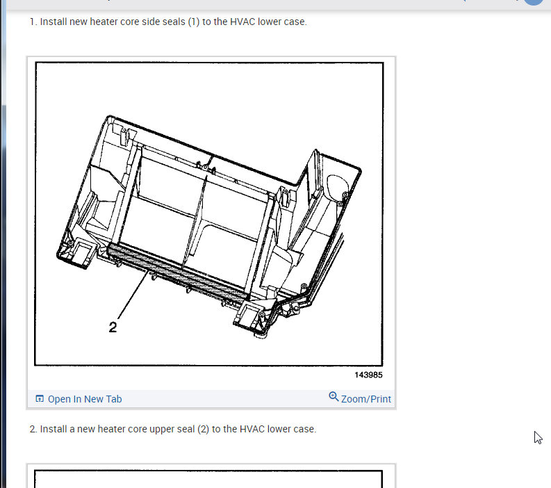

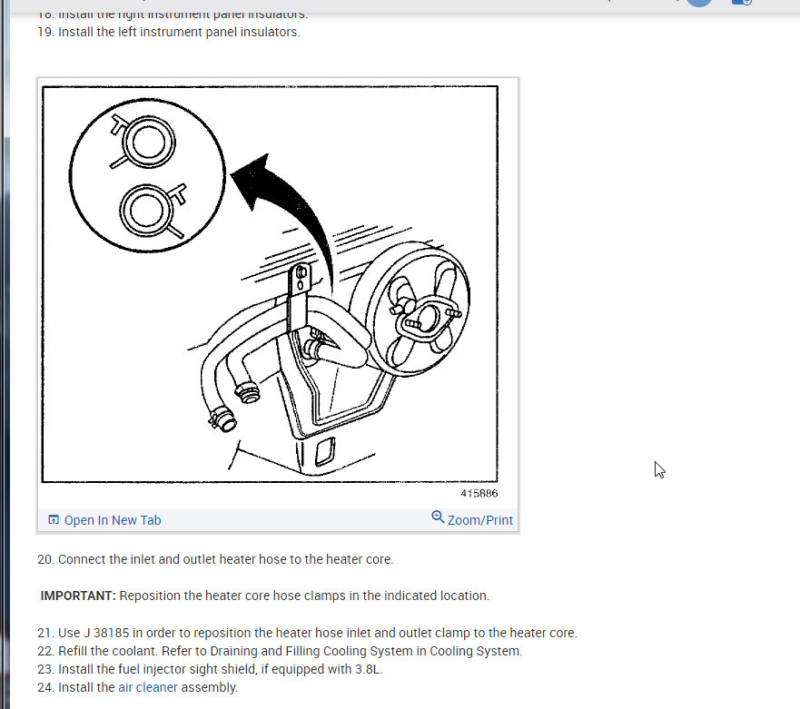

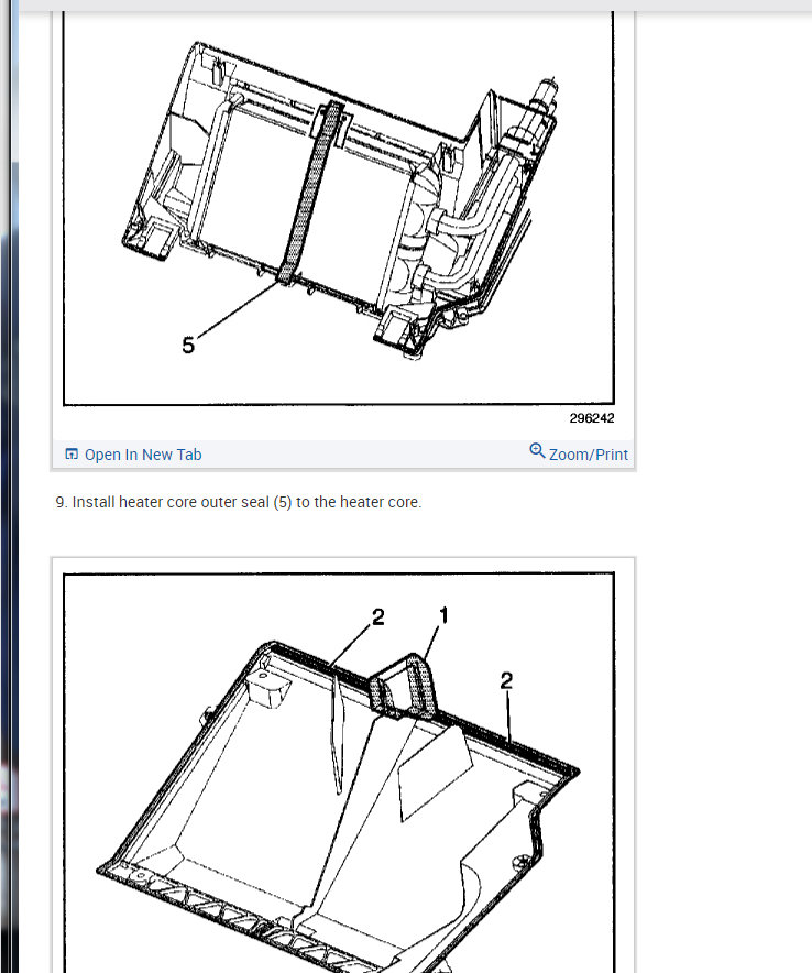

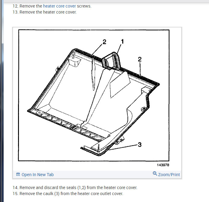

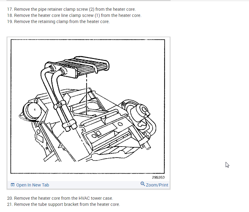

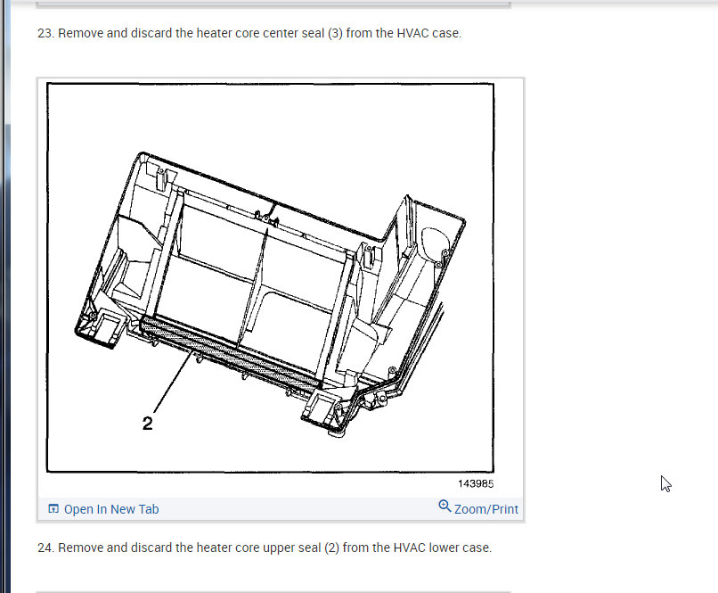

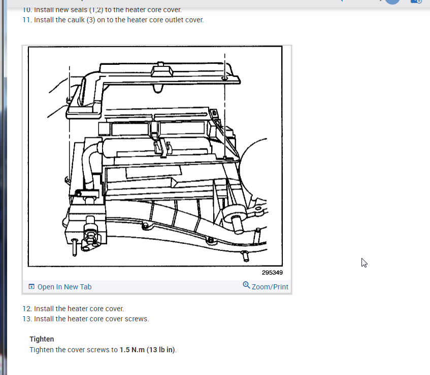

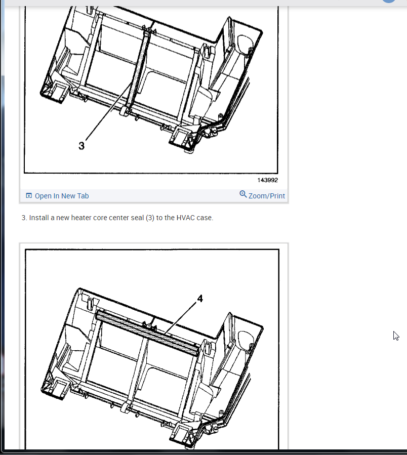

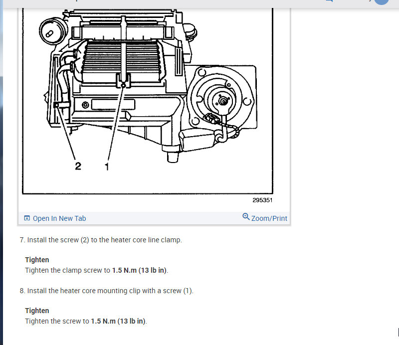

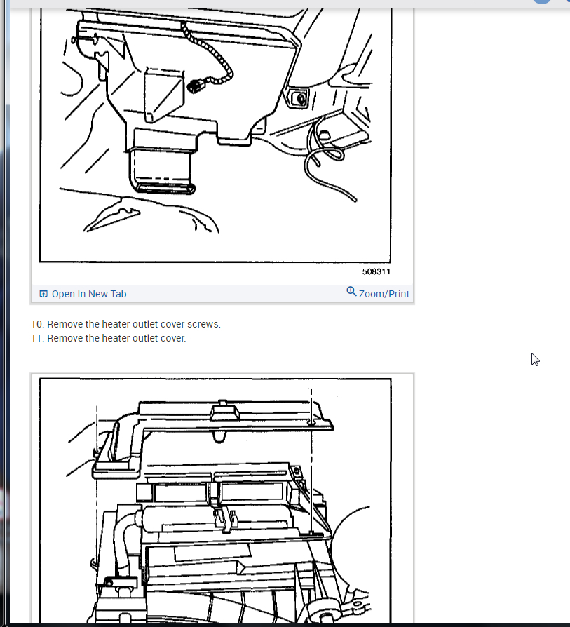

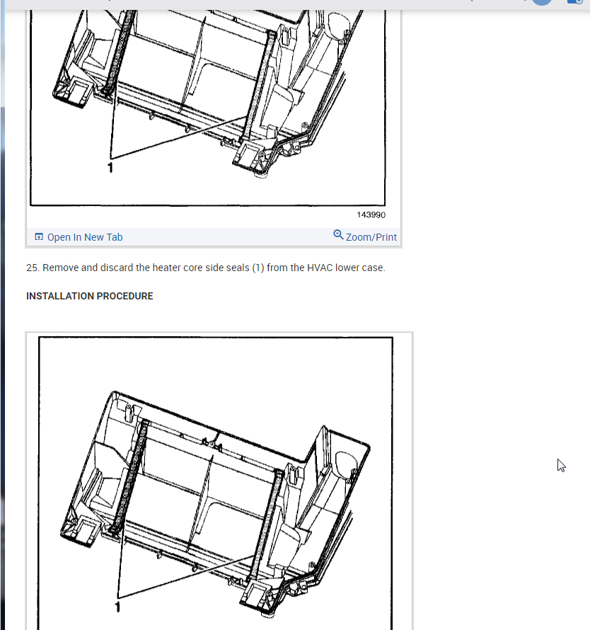

Heater core replacement in 2002 chevy impala What's the easiest way to replace the heater core?
Friday, February 19th, 2021 AT 1:51 PM (Merged)
Unfortunately there is no short cut for this vehicle. I am attaching below the process from the manual on how to replace this.
Let us know if you have questions. Thanks
