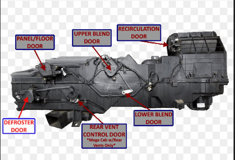

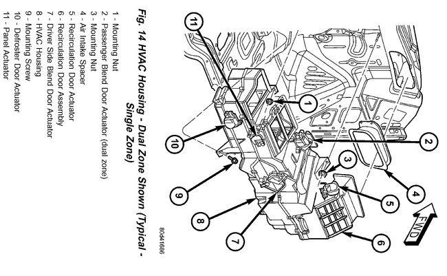

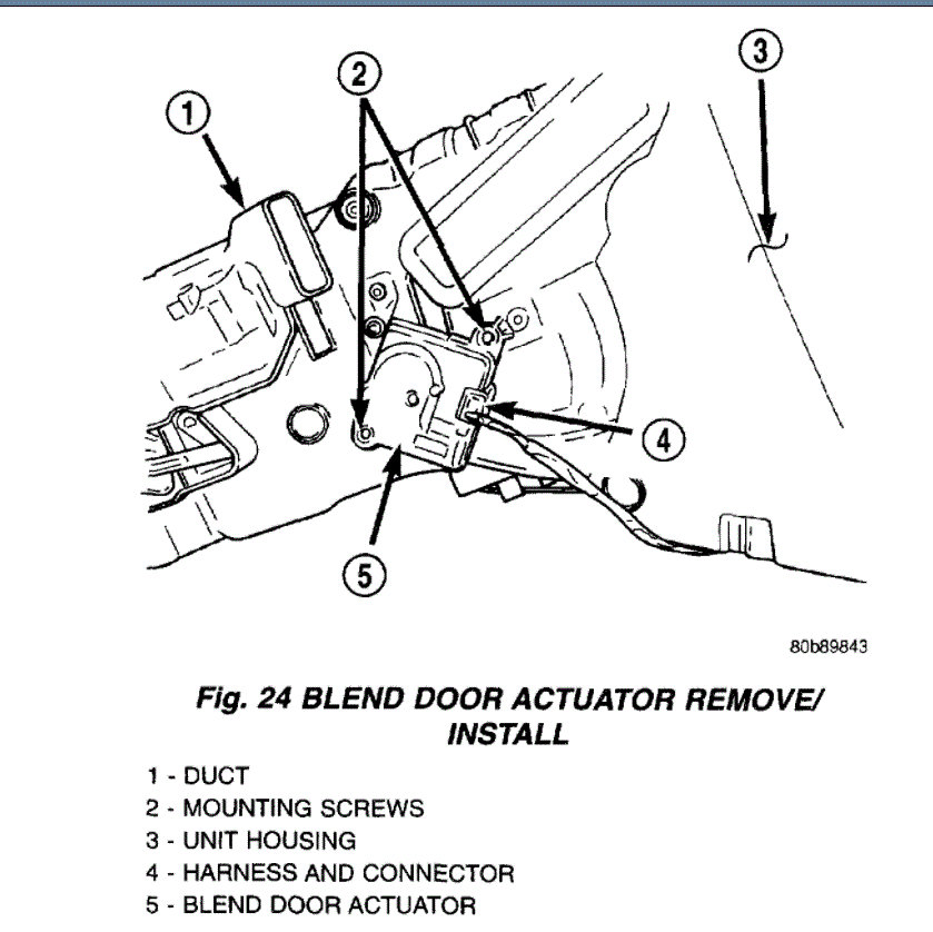

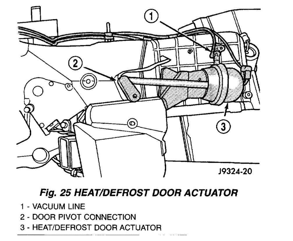

HVAC blend door actuator location?
2011 DODGE RAM
It is dual zone.
Okay. Do you have the exact same truck as this post? 2011 1500?
I see your screen name is different. If you have an 18 2500, we are going to have to get a new post started. We want to try and keep each to the same issue on the same vehicle just so that others can search and find the solution.
This is a common enough issue that we want to make sure others can find it.
I suspect this is still a fresh air door but let's get a new one started and then we can figure it out for sure. Thanks, and sorry for any inconvenience.
