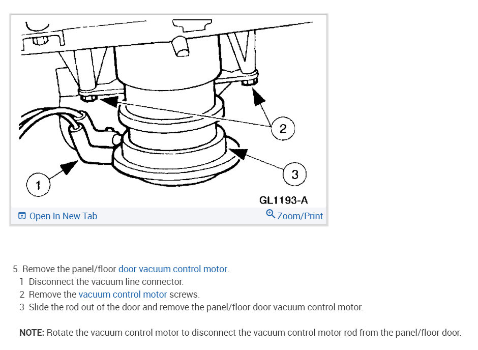

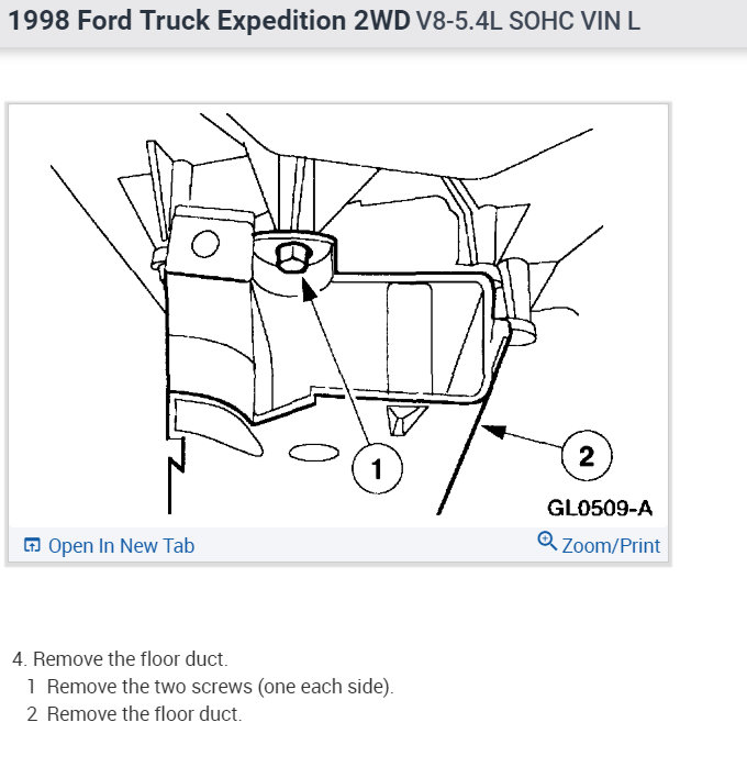

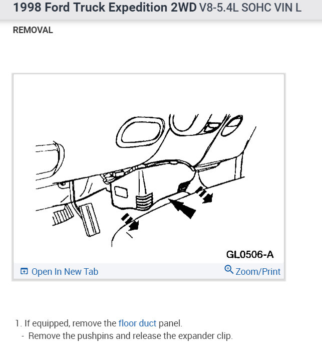

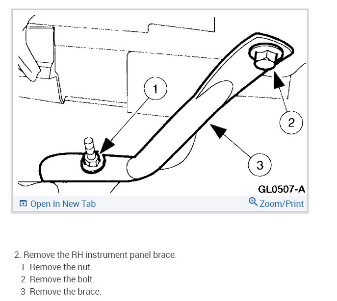

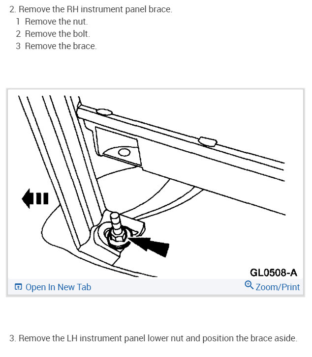

This sounds like two different problems the air flow issue sounds like the mode actuator is not working. here is a guide to help walk you through the steps with diagrams below to show you how on your car. The cold air part could be the system is low on charge. here is a guide for that as well. Check the vacuum source to the HVAC system
https://www.2carpros.com/articles/air-vents-stay-in-the-defrost-position
and
Check out the diagrams (below). Please let us know what you find.
