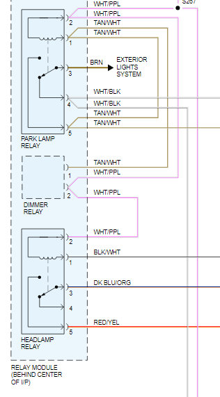

Where is relay for headlights at no lights and does not have auto light on it?

Okay, the relay is on the relay panel behind the center of the dash as listed in the diagram.
Image (Click to make bigger)

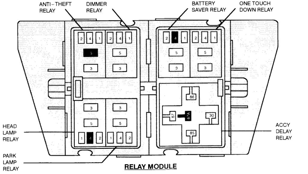

Do you know watch one it is it not marked on cover?

Picture attached.
