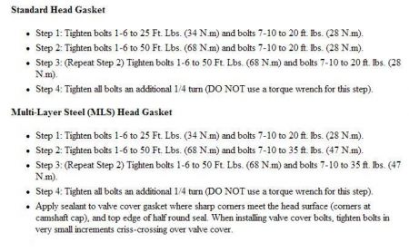

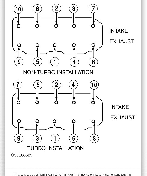

JOHN CLUTCH CARROLL
  • 1997 MITSUBISHI ECLIPSE
  • 2.0L
  • 4 CYL
  • FWD
  • MANUAL
  • 150,000 MILES

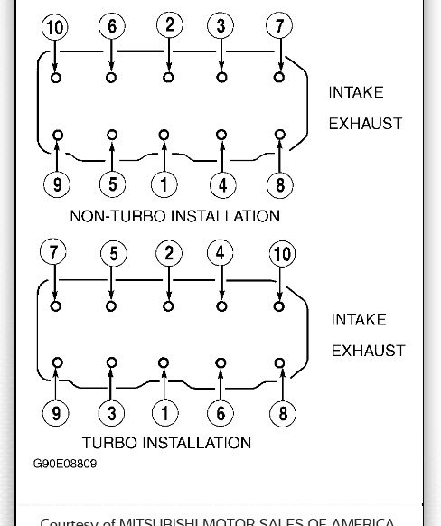

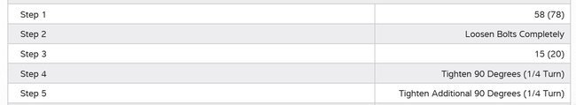

And my Chilton repair manual it says to do it fifteen pounds and the ninety degrees of an another additional ninety degrees is this correct for a turbo engine for this vehicle or is there a different torque spec? That was supposed to send it to that I do not know about you, but I am not finding.
Friday, September 16th, 2016 AT 11:25 AM
13 Replies
HMAC300
  • 48,601 POSTS
I sent that to you yesterday. But I will send again if I still have it. Pictures have torque spec, bolts to tighten in order as well as proper placement of head gasket.
+1
Friday, September 16th, 2016 AT 12:06 PM

HEFESTIS
Engine Mechanical problem 4 cyl Front Wheel Drive Manual 164000 miles

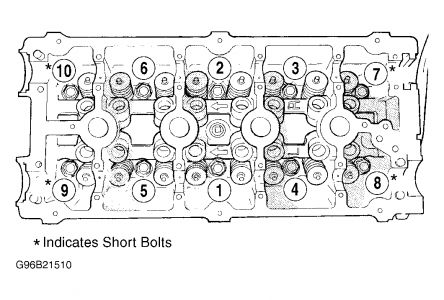

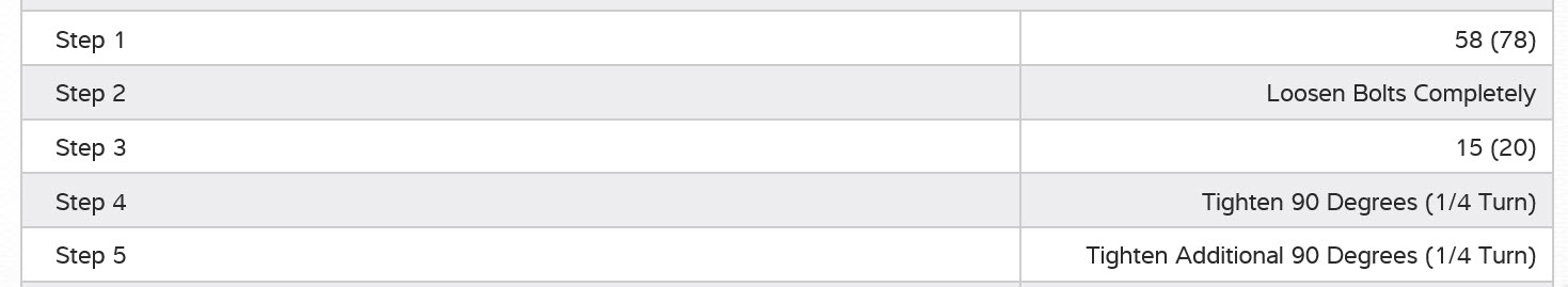

I need to know how tight to torque the head bolts down on a 1997 mitsubishi eclipse 2.0 DOHC non turbo. I just need to know how many pounds of torque to tighten them too thank you.
Friday, October 13th, 2017 AT 2:25 PM (Merged)
BLUELIGHTNIN6
  • 16,542 POSTS
https://www.2carpros.com/forum/automotive_pictures/261618_Noname_1502.jpg
https://www.2carpros.com/forum/automotive_pictures/261618_Graphic_284.jpg
+11

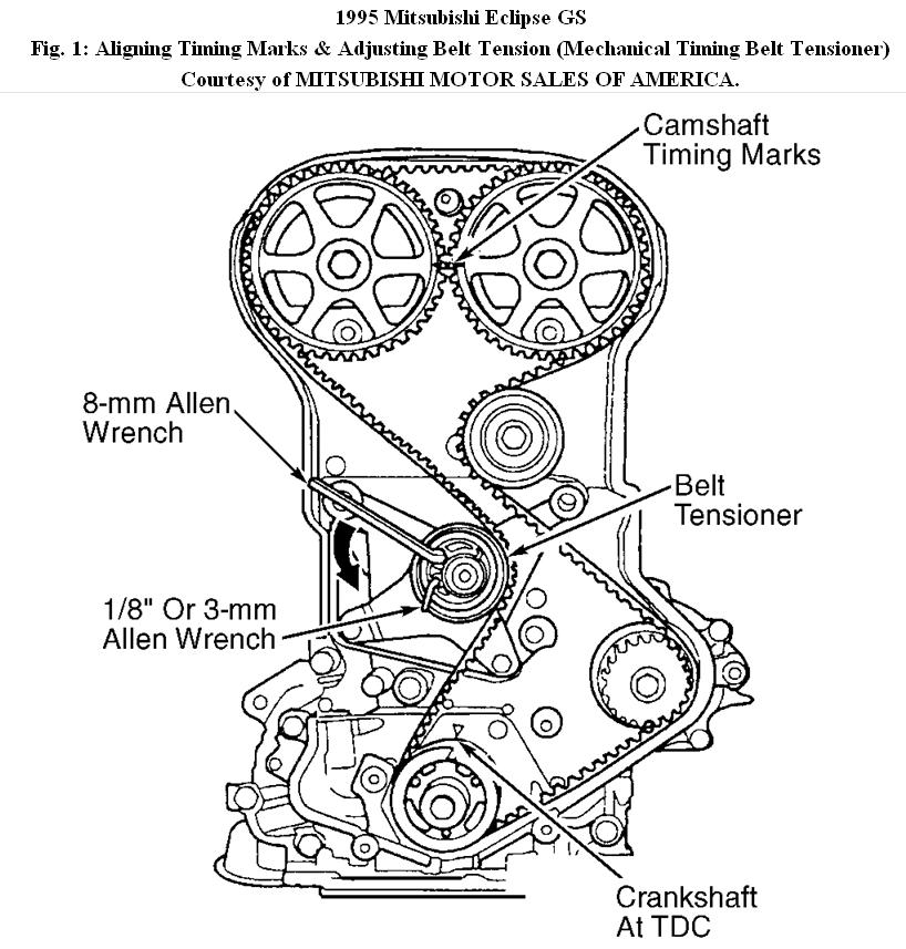

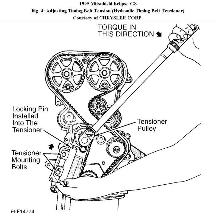

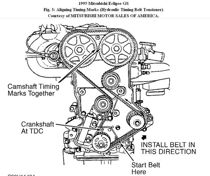

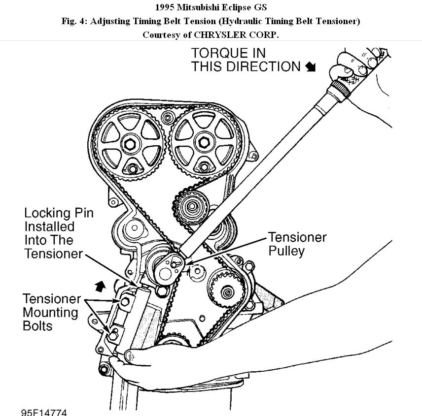

Hi my names mike and I could really use some help with my project im working on I would really appreciate it, the car is a 1995 mitsubishi eclipse gs, its got the 420A in it. I got everything pretty much apart except the timing belt, I know things can get screwed up easy when it comes to that so I wanted to know everything I need to do and if you have pictures and diagrams it would be really helpful thank you very much for any and all help
Friday, October 13th, 2017 AT 2:26 PM (Merged)
KHLOW2008
  • 41,814 POSTS
Hi Mike,
Hope the following are helpful.
REMOVAL & INSTALLATION
CAUTION:This application is an interference engine. Do not rotate camshaft or crankshaft when timing belt is removed, or engine damage may occur.
TIMING BELT
Removal (Mechanical Timing Belt Tensioner)
1. Raise and support vehicle. Remove right inner splash shield. Remove center bolt from crankshaft pulley. Use gear puller to remove crankshaft pulley.
2. Remove power steering pump (hoses attached) and mounting bracket from engine. Move out of way.
3. Lower vehicle. Place jack under engine for support. Remove right side engine mount. Remove engine mount bracket from front of engine. Remove timing belt cover. Rotate engine clockwise to align the camshaft and crankshaft timing marks. See Fig. 1.
CAUTION:To prevent pistons from hitting valves, do not rotate camshaft
or crankshaft after removing the timing belt.
4. Install 8-mm Allen wrench into timing belt tensioner. See Fig. 1. Insert long end of a 3-mm Allen wrench into pin hole in the front of tensioner. Slowly rotate tensioner counterclockwise with 8-mm Allen wrench while pushing lightly on the 3-mm Allen wrench, until it slides into the locking hole. If reusing old timing belt, mark belt with arrow to indicate direction of rotation. Remove timing belt.
CAUTION: Mechanical timing belt tensioner is serviced as an assembly. To prevent premature timing belt failure and engine damage, do not
separate tensioner pulley from tensioner bracket.

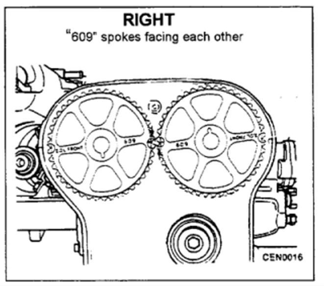

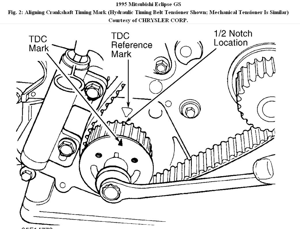

Fig. 1: Aligning Timing Marks & Adjusting Belt Tension (Mechanical Timing Belt Tensioner) (ENSURE THE MARKINGS "609" ARE FACING EACH OTHER WHEN INSTALLING.)

Installation (Mechanical Timing Belt Tensioner)
1. Ensure camshaft and crankshaft timing marks are aligned. Rotate crankshaft pulley sprocket 1/2 tooth counterclockwise from TDC location. See Fig. 2.
2. Install timing belt starting from crankshaft pulley sprocket, go around water pump sprocket, idler pulley, camshaft sprockets, and then around tensioner pulley. Move crankshaft sprocket to TDC to take up belt slack.
3. Remove Allen wrench from timing belt tensioner pulley. Rotate crankshaft clockwise 2 revolutions. Check alignment of camshaft and crankshaft timing marks. If timing marks do not align, remove timing belt and realign timing marks.
4. Continue installation in reverse of removal procedure. Adjust drive belts to proper tension.
Fig. 2: Aligning Crankshaft Timing Mark (Hydraulic Timing Belt Tensioner Shown; Mechanical Tensioner Is Similar)
Removal (Hydraulic Timing Belt Tensioner)
3. Lower vehicle. Place jack under engine for support. Remove right side engine mount. Remove engine mount bracket from front of engine. Remove timing belt cover. Rotate engine clockwise to align the camshaft and crankshaft timing marks. See Fig. 3.
4. Loosen timing belt tensioner to remove timing belt. If reusing old belt, mark belt with arrow to indicated direction of rotation. Remove timing belt.
5. Remove tensioner from engine. It will be necessary to compress the center plunger and lock it in place.
6. Place tensioner in a soft-jawed vise. Align the hole in the end of the tensioner center plunger with the hole in the end of the tensioner body. Slowly compress the tensioner, and when holes are aligned, insert a locking pin in the tensioner.
Fig. 3: Aligning Timing Marks (Hydraulic Timing Belt Tensioner)

Installation (Hydraulic Timing Belt Tensioner)
2. Install timing belt starting from crankshaft pulley sprocket, go around water pump sprocket, idler pulley, camshaft sprockets, and then around tensioner pulley. Move crankshaft sprocket to TDC to take up belt slack. Install timing belt tensioner, but do not final tighten fasteners yet.
3. With 21 ft. Lbs. (28 N.M) of torque applied to tensioner pulley, move tensioner against pulley bracket and tighten bolts to specification. See Fig. 4.
4. Remove tensioner plunger locking pin. Pretension is correct when locking pin can be removed and installed again.
5. Rotate crankshaft clockwise 2 revolutions and check timing belt alignment marks. Reset belt if marks are not aligned. Install timing belt covers.
6. Continue installation in reverse of removal procedure. Adjust drive belts to proper tension.
Fig. 4: Adjusting Timing Belt Tension (Hydraulic Timing Belt Tensioner)

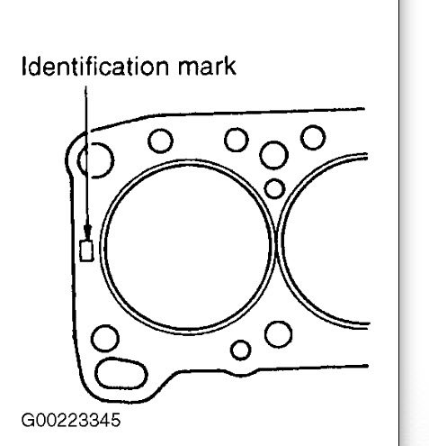

WADEKO
  • 2001 MITSUBISHI ECLIPSE
  • 4 CYL
  • 2WD
  • 158,000 MILES

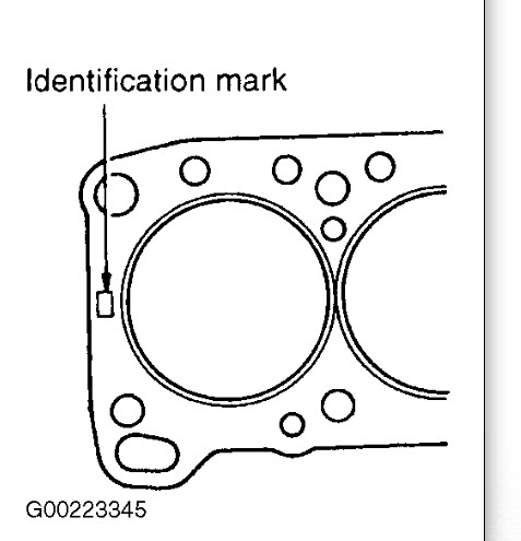

2.4L MITSUBISHI Eclipse SOHC. 4g64 engine. Complete head and valve job by shop. All new gaskets. New timing ans water pump. Engine runs but lots of valve noise. Lifters not pumping up. Pumped up manually and sounded good for two minutes and lots of lifter noise again. Lifters wont stay pumped up. Is it possible head gasket is upside down? Please help
DOCFIXIT
  • 18,828 POSTS
Possible gasket has identification marks on timing belt end MUST face up. Where they?
