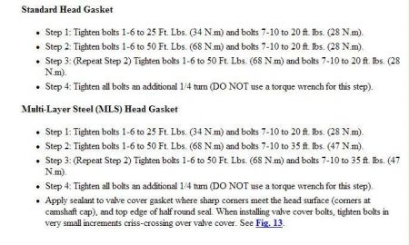

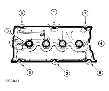

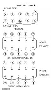

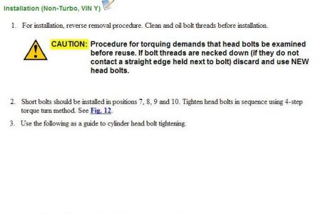

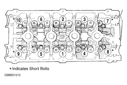

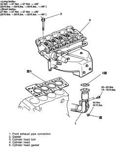

1997 Mitsubishi Eclipse 4 cyl Two Wheel Drive Automatic 100+ miles

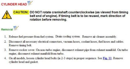

have a 97 eclipse. Recently broke timing belt, so this meant bent valves and the hole shabang. Removed the valve cover, and found the bent valves. Need instruction on how to remove cylinder head(what needs to be remove) and would like to know if any one could send me engine diagrams.
Thursday, December 22nd, 2016 AT 3:25 PM (Merged)
BLUELIGHTNIN6
  • 16,542 POSTS
Is this a turbo or non-turbo engine?
-2
A-ITURRALDE
Not turbo, 2.0l 16 valve

https://www.2carpros.com/forum/automotive_pictures/261618_Noname_875.jpg
FIG. 11
https://www.2carpros.com/forum/automotive_pictures/261618_11_1.jpg
https://www.2carpros.com/forum/automotive_pictures/261618_2_59.jpg
FIG. 12
https://www.2carpros.com/forum/automotive_pictures/261618_12_1.jpg
https://www.2carpros.com/forum/automotive_pictures/261618_3_26.jpg
FIG. 13
https://www.2carpros.com/forum/automotive_pictures/261618_13_2.jpg
+2
