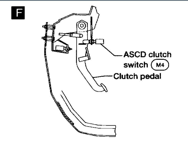

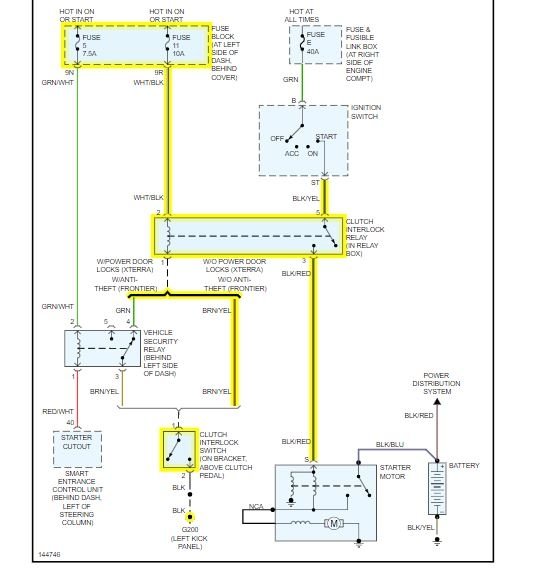

When I press the clutch down it will not start. Don’t know if it’s a bad spot in the clutch or if it’s a starter or if it’s a neutral safety switch? If I roll in neutral and pop the clutch then try to start it it’ll start sometimes or like today I shut it off then tried to to start it and it wouldn’t start. Then I waited a couple hours and tried to go back out and start it then it started. So I don’t know where to start to figure out the problem of why it won’t start. Does anyone have any suggestions on what might be going on? And thank you In advance.

The neutral switch is the clutch switch. That is what controls power to the starter motor.
I attached a wiring diagram for you to view. You need to verify power to the starter motor with the key in the start position.

Okay, you need to go to the clutch switch under the dash and check for voltage to the switch with the key in the start position.
