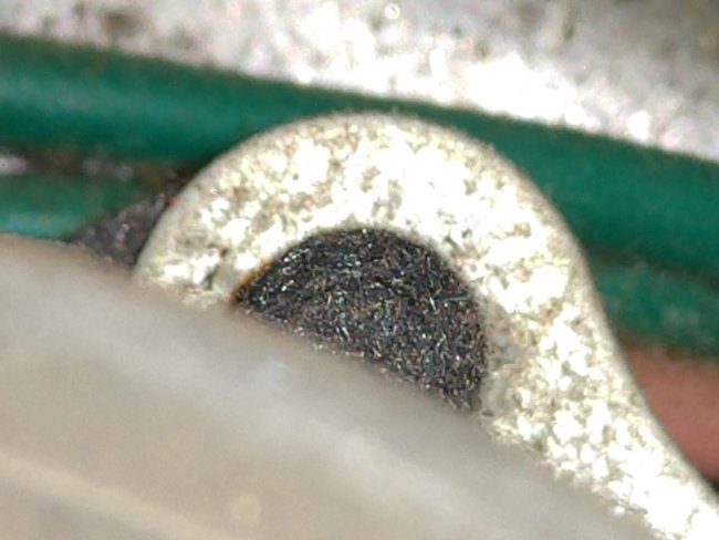

JOHN BRANDON
  • 11 POSTS
It's just a msd distributor I can send you a picture. I don't know any model
Monday, April 2nd, 2018 AT 2:47 PM

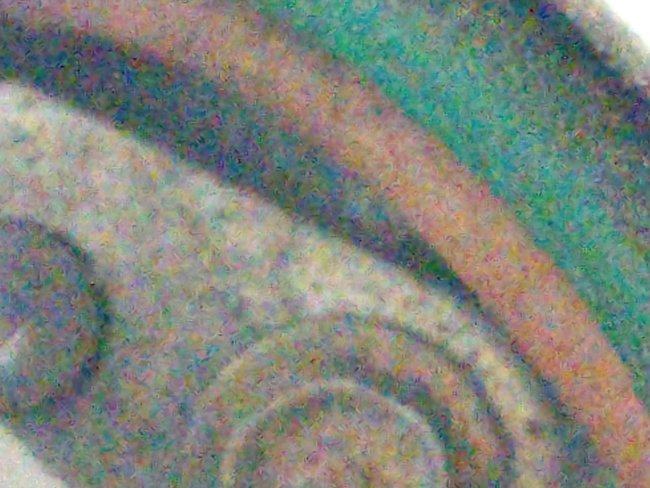

JOHN BRANDON
  • 11 POSTS
These are the wires I see down in the distributor
Monday, April 2nd, 2018 AT 2:56 PM

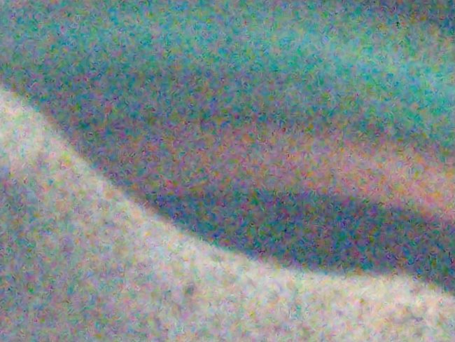

JOHN BRANDON
  • 11 POSTS
This picture is at the back down inside
Monday, April 2nd, 2018 AT 2:58 PM
Is that corrosion in the distributor?
Monday, April 2nd, 2018 AT 3:03 PM
JOHN BRANDON
  • 11 POSTS
It looks like it is.
Monday, April 2nd, 2018 AT 3:06 PM
JOHN BRANDON
  • 11 POSTS
But it was running until 2 weeks ago. When it ran until it got hot and wouldn't start for a few hours. Now it won't spark at all
