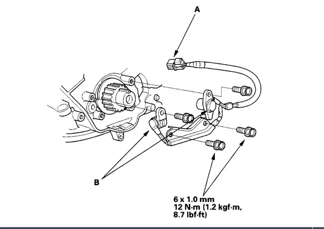

I have a feeling it is related to the crankshaft position sensor. There is a chance it was damaged or disconnected. If you take a look at pic 1, it shows what I'm referring to. It is located behind the crank pulley which fell off. Check it first.
To help confirm that it is likely this sensor, see if there is spark to the plugs. If the sensor is bad, there won't be spark. Here is a link that explains how to check for spark:

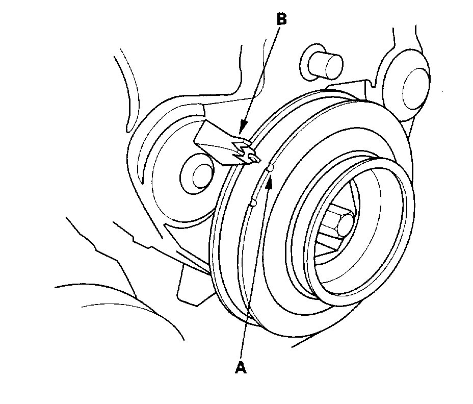

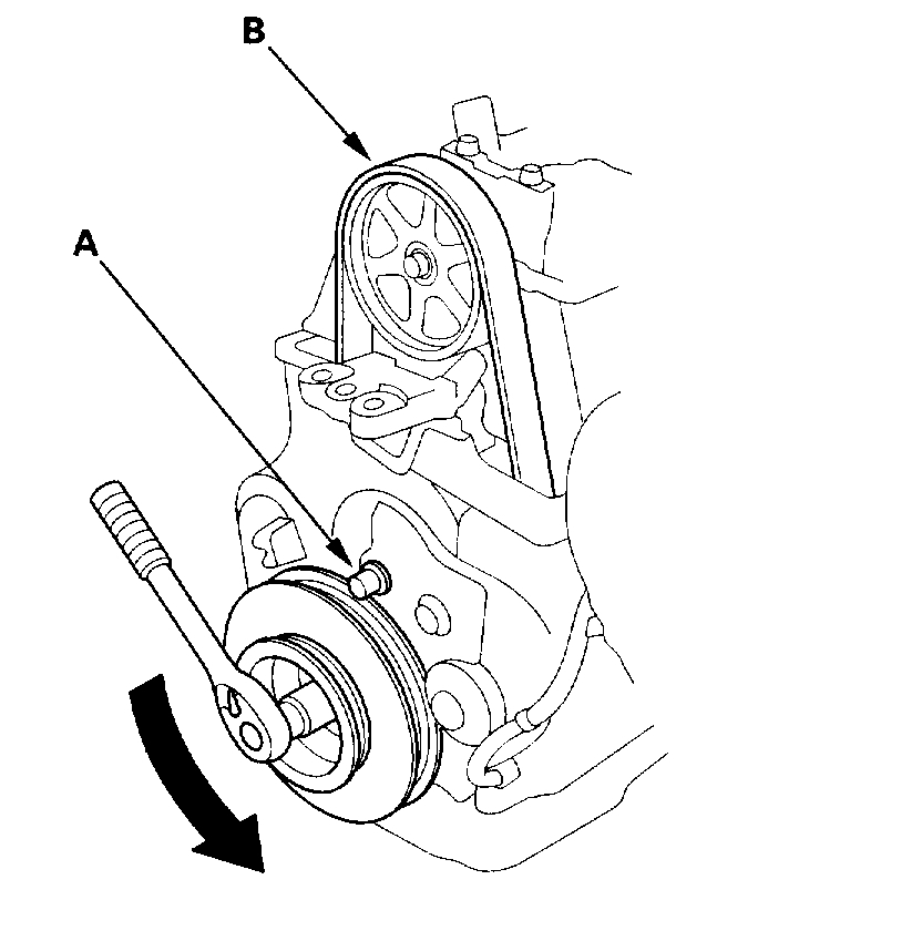

3. Turn the crankshaft pulley so its TDC mark (A) lines up with the pointer (B).

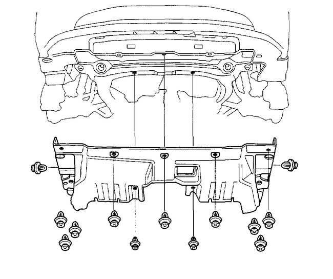

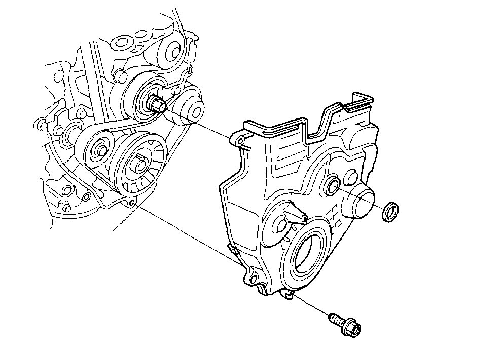

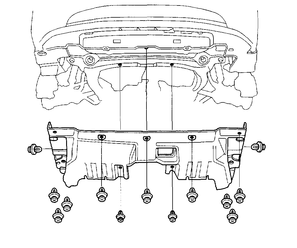

5. Remove the splash shield.
Pic 3

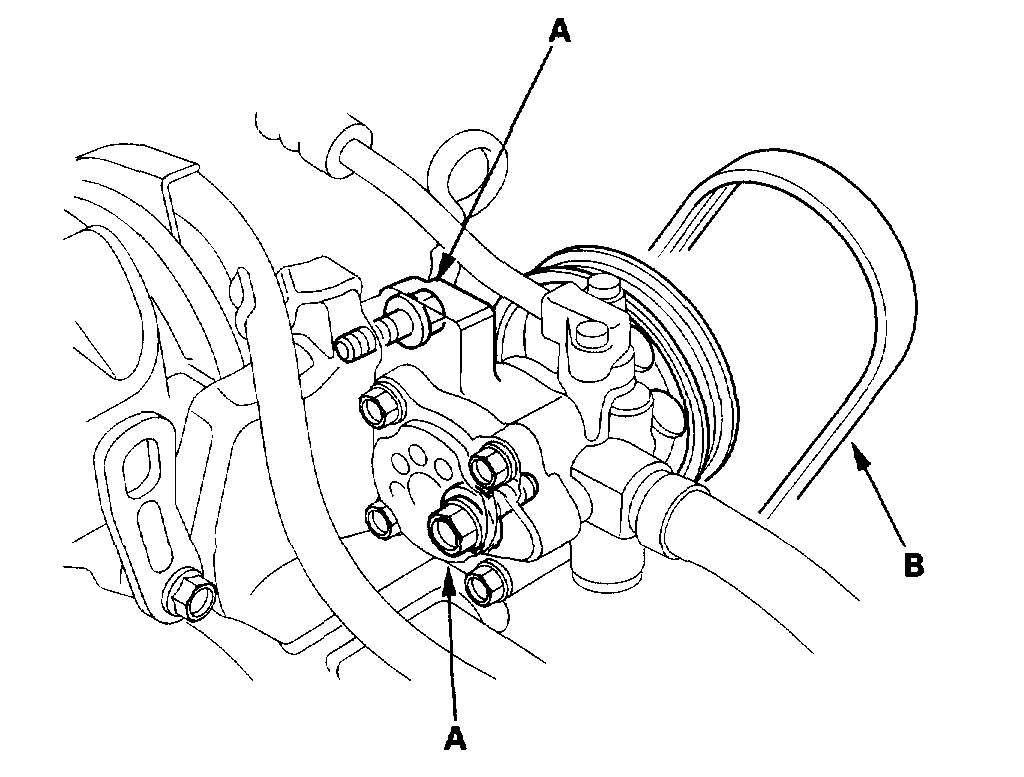

6. Loosen the mounting bolts (A), then remove the P/S belt (B).

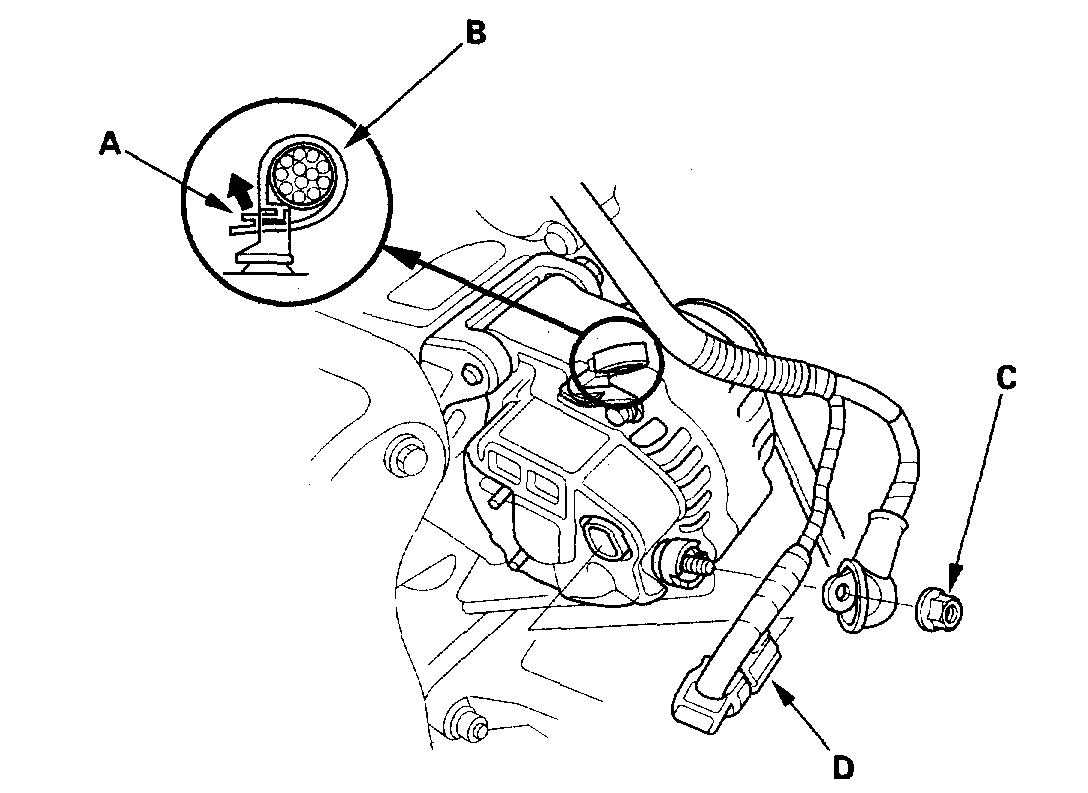

7. Disconnect the alternator wire harness.
1 Pull up the lock (A), then release the wire harness tie (B).
2 Pull back the boot and remove the 6 mm nut (c).
3 Disconnect the connector (D) from the alternator.

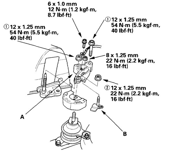

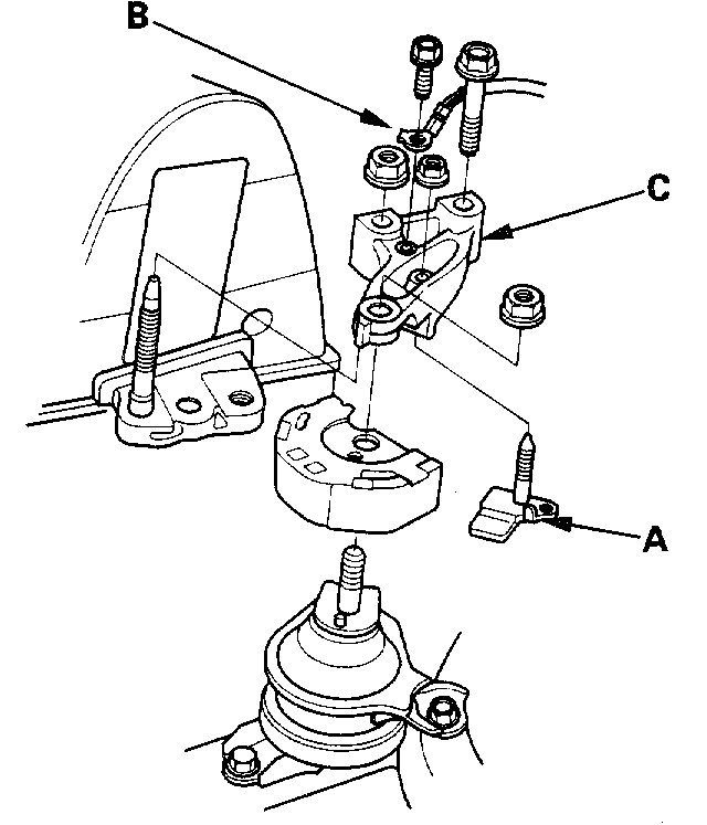

11. Remove the stopper (A) and ground cable (B), then remove the upper bracket (C).

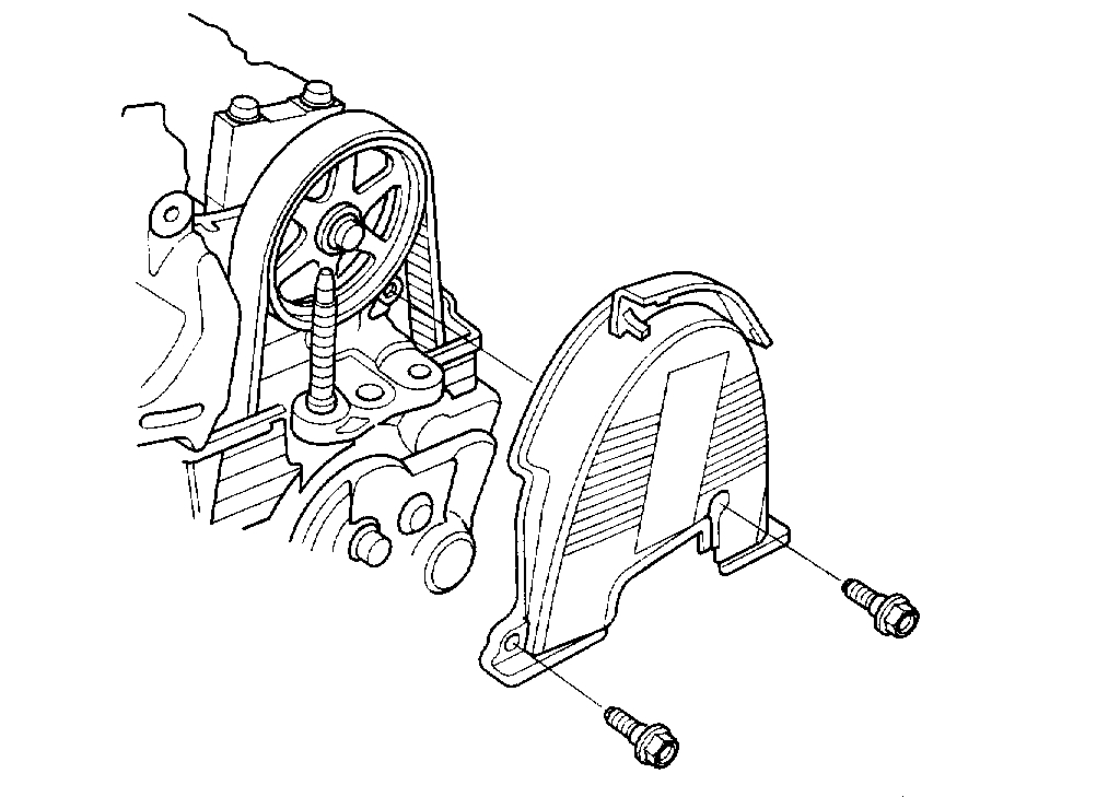

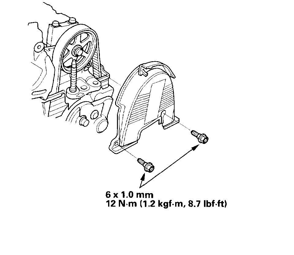

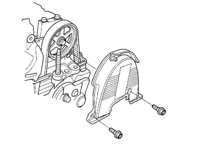

13. Remove the upper cover.
Pic 7

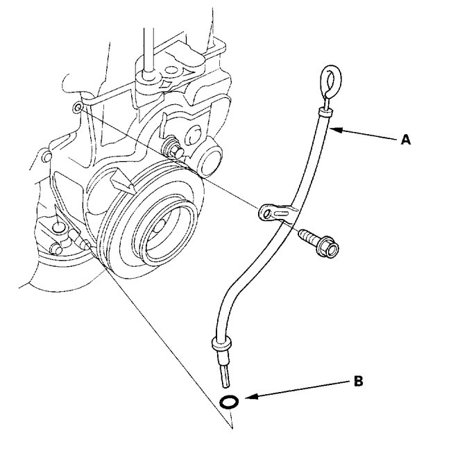

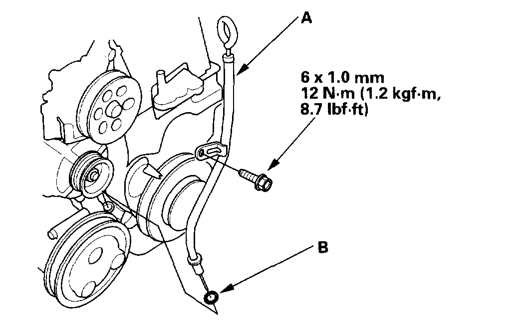

14. Remove the dipstick and tube (A). Discard the O-ring (B).
Pic 8

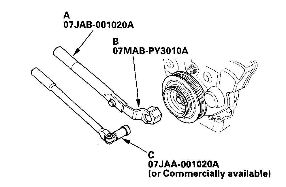

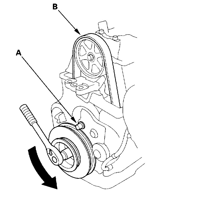

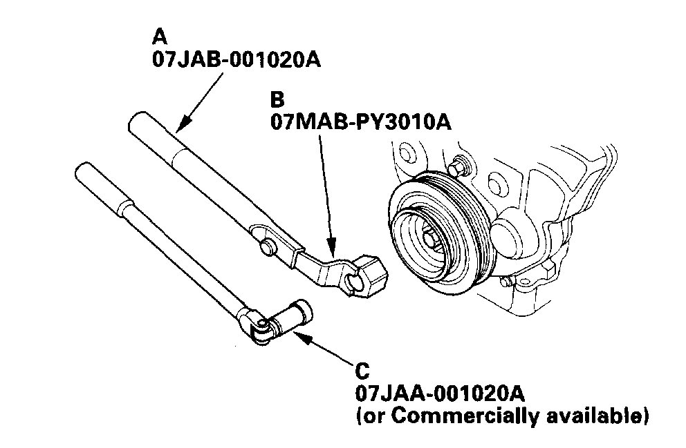

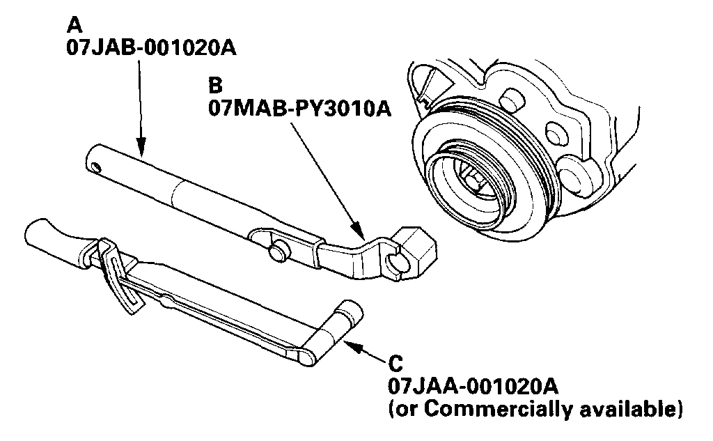

15. Hold the pulley with holder handle (A) and holder attachment (B).
16. Remove the bolt with a heavy duty 19 mm socket (c) and breaker bar.
Pic 9

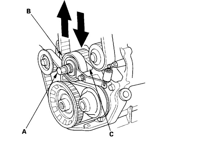

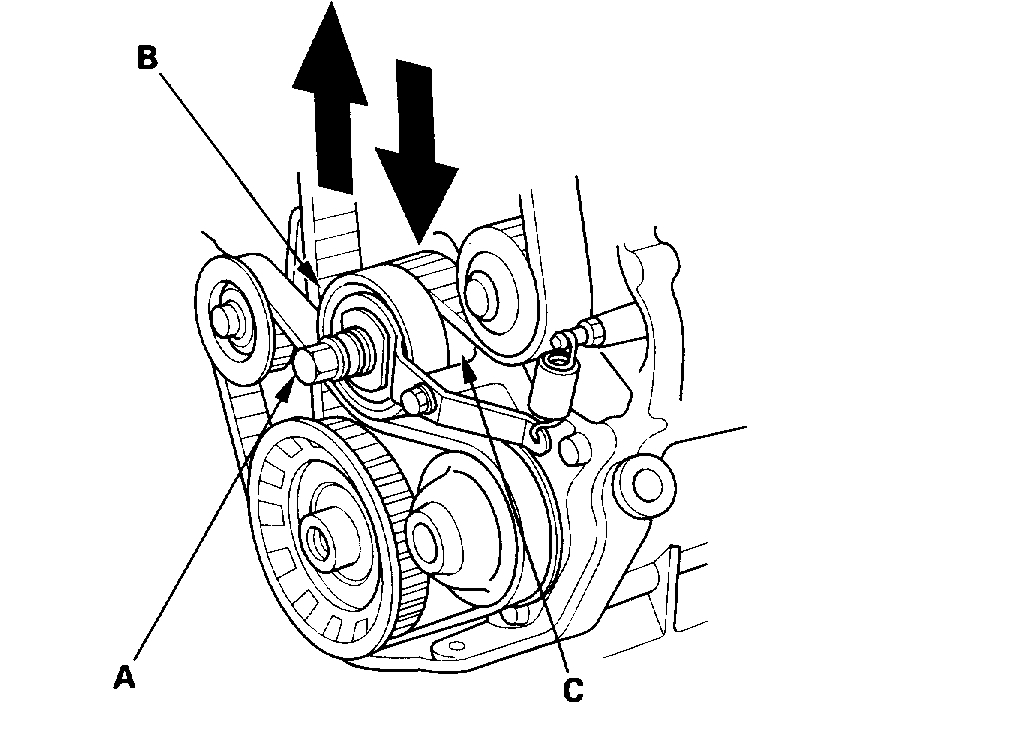

19. Release tension from the balancer belt:
1 Install a 6 mm bolt (A)(from the timing cover) through the hole in the end of the timing belt adjuster arm to temporarily lock the arm in place.
2 Loosen the adjusting nut (B) 2/3 - 1 turn.

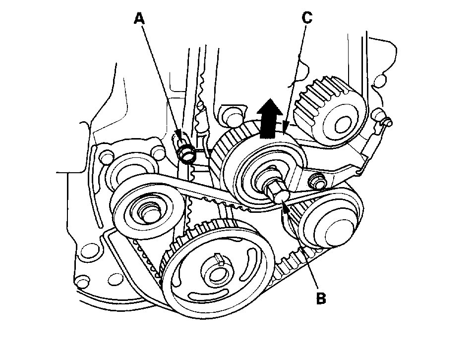

3 Push the tensioner (c) up to take tension off the balancer belt.
4 Retighten the adjusting nut (B).
Pic 11
20. Release tension from the balancer belt and the timing belt:
1 Loosen the adjusting nut (A) 2/3 - 1 turn.
2 Push the balancer belt tensioner (B) up to take tension off the balancer belt.
3 Push the timing belt tensioner (c) down to take tension off the timing belt.
4 Retighten the adjusting nut (A).

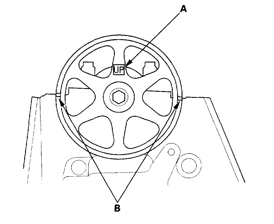

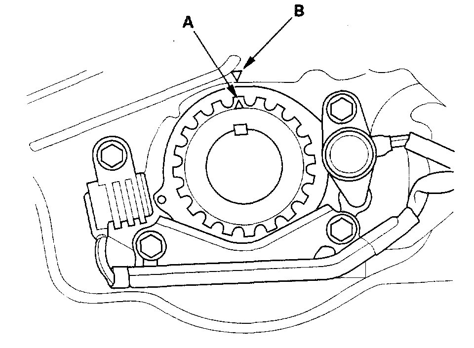

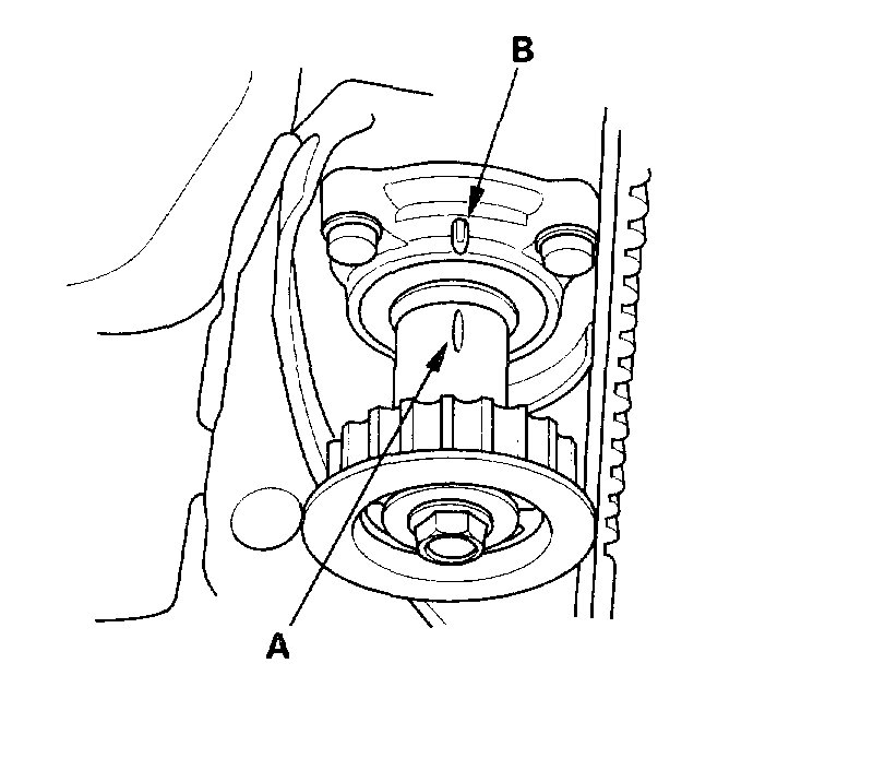

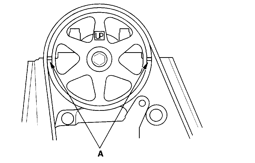

3. Set the crankshaft to TDC. Align the dimple (A) on the tooth of the timing belt drive pulley with the pointer (B) on the oil pump.
Pic 13
4. Clean the camshaft pulley and set it to TDC.

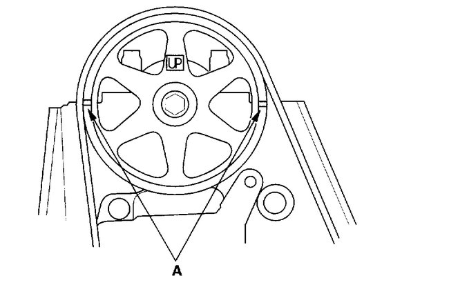

1 The "UP" mark (A) on the camshaft pulley should be at the top.
2 Align the TDC grooves (B) on the pulley with the too edge of the head.
Pic 14

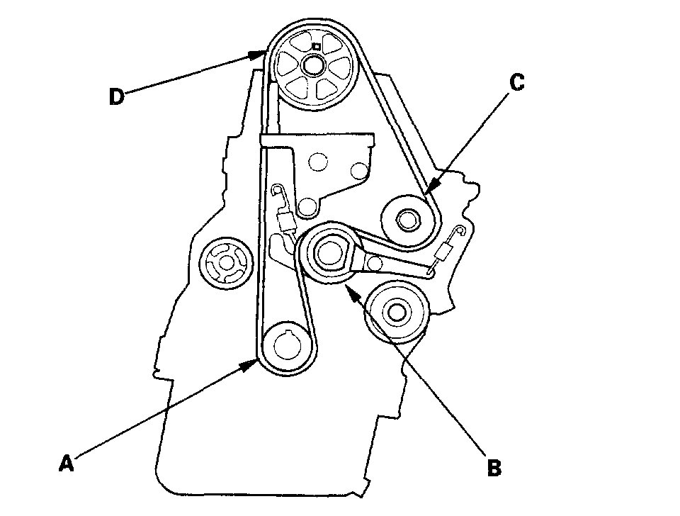

5. Install the timing belt in a counterclockwise sequence, starting with the drive pulley.
1 Drive pulley (A).
2 Tensioner pulley (B).
3 Water pump pulley (C).
4 Camshaft Pulley (D).

13. Turn the crankshaft pulley so its TDC mark (A) lines up with the pointer (B).
Pic 17
14. Check the camshaft pulley marks.
If the camshaft pulley marks are also at TDC, go to step 15.
If the camshaft pulley marks are not at TDC, remove the timing belt and repeat steps 3, 4 and 5.

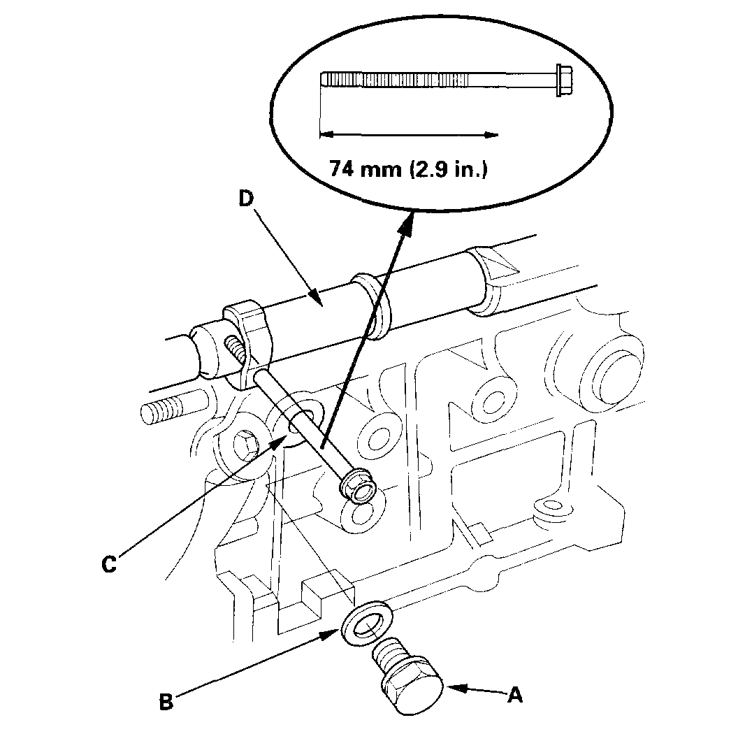

19. Align the rear balancer shaft pulley with a 6 x 100 mm bolt (or equivalent).
1 Remove the bolt (A) and washer (B) from the maintenance hole (C).
2 Scribe a line on a 6 x 100 mm bolt, 74 mm (2.9 inch) from the end.
3 Insert the bolt in the maintenance hole and into the hole in the balancer shaft (D) up to the line you scribed.
Pic 19

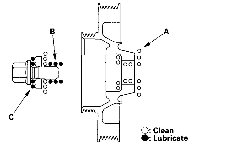

28. Clean the crankshaft pulley bolt and washer.
Pic 20
29. Clean all oil off the inside face (A) of the crankshaft pulley, and apply lubricant to the pulley bolt (B) and washer (C).
Pic 21
30. Install the crankshaft pulley, and hold with holder handle (a) and holder attachment (B).
31. Tighten the bolt to 245 Nm (250 kgf-m, 181 ft. Lbs.) With a torque wrench and 19 mm socket (c). Do not use an impact wrench.

40. Install the upper bracket (A), then tighten the bolt and nuts in the numbered sequence shown.
41. Install the stop (B).

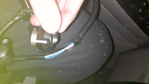

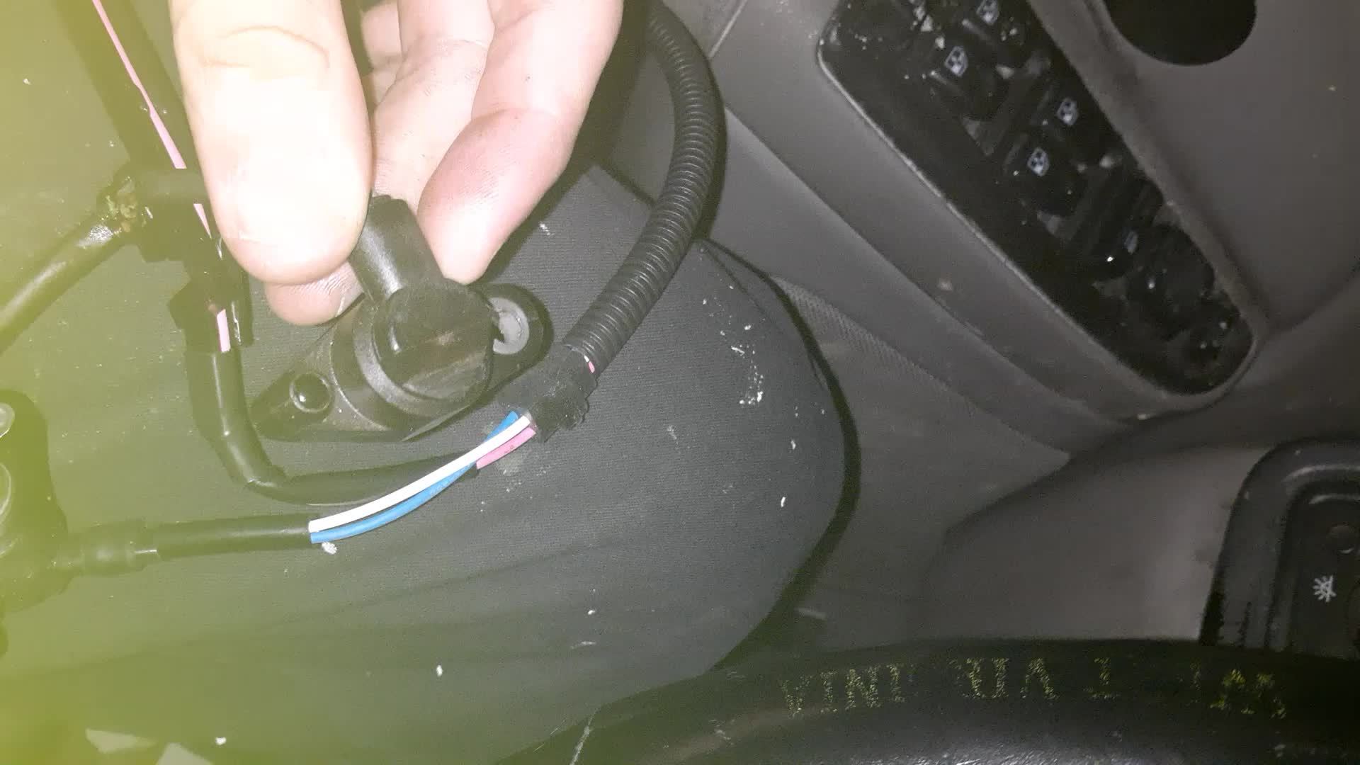

I've also now run into another problem. The sensor that they say is for this car does not match up. The left one plugs in fine but the right one the bolt hole does not line up with how it fits. When it twist it to line the hole it doesn't fit right anymore. Everything looks good by eye but I don't want to crank it down and mess it up.
Sunday, January 3rd, 2021 AT 1:26 PM
  • 110,194 POSTS
Dan,
You will need to do it over. I would suggest putting it back at TDC and confirm the marks for the cam are correct. Now, as far as the sensor, we need to confirm if it is a Vtec engine or not. That is likely what is causing the variation in the crankshaft position sensor. Usually, it will say Vtec on the valve cover or engine cover.
Sunday, January 3rd, 2021 AT 6:40 PM

It's a v tech. So after I get the right sensor installed, put it all back together line the mark up take it back apart and line everything else up. That mark appears to be on the balancer itself. Do I put the balancer belt back on first also? Or just get the balancer back on?

You install the balancer so the marks line up then then remove the balancer to install the belt, then reinstall the balancer. Let us know what happens and please upload pictures or videos.

This is turning out to be a big pain. I can't find the right part for nothing.
-1
Tuesday, January 12th, 2021 AT 12:08 PM
KEN L
  • MASTER CERTIFIED MECHANIC
  • 55,481 POSTS
Here is the part number for the crankshaft sensor but I would call around to see if you can get an aftermarket or used one.
Crankshaft Position Sensor
37840P0AA01
$455.41
Also if you try to see the video what you are trying to show does not enter the screen.

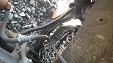

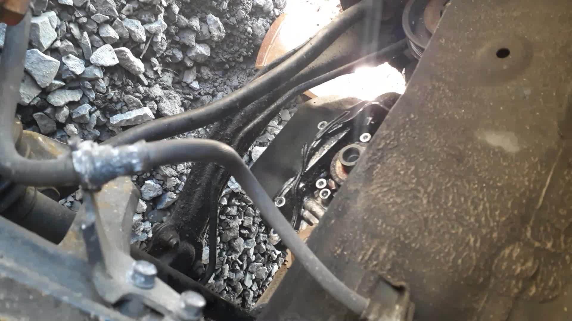

I got the old part back I'm not sure why the other video cut short. Here's what I mean without the cut it doesn't clear that black ring thing I pointed to. If he can't find a used one I'm just going to tell him to bring a tow truck and junk it at that price.

I still can't see what you are talking about. Can you look at the video please? Also which phone are you using?
Thursday, January 14th, 2021 AT 8:54 AM
DANIEL STROTHER
  • 12 POSTS
Using an Android. Not sure why it says error I guess I'll have to draw it and see if that works. But I do have another question, my neighbor seems to think it's a different thing wrong all together. He says that if this was bad it would still crank just not start. I wasn't getting anything when turned the key. So I just want to be sure I'm still heading the right direction.

Yep, if the engine does not crank over the harmonic balancer will have nothing to do with that. These guides can help us fix it:
