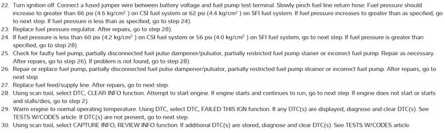

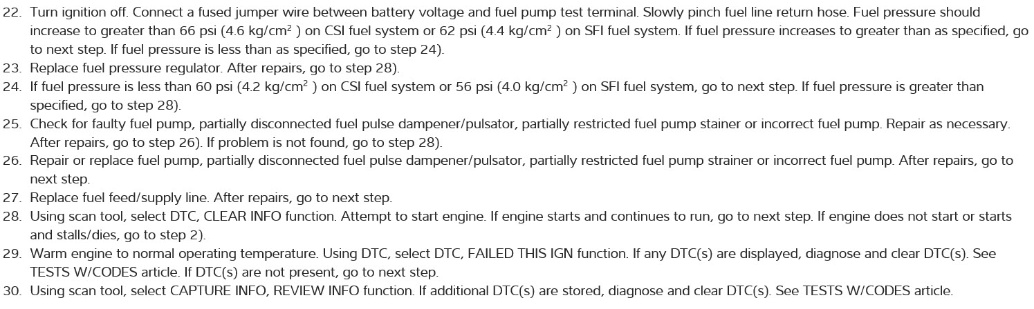

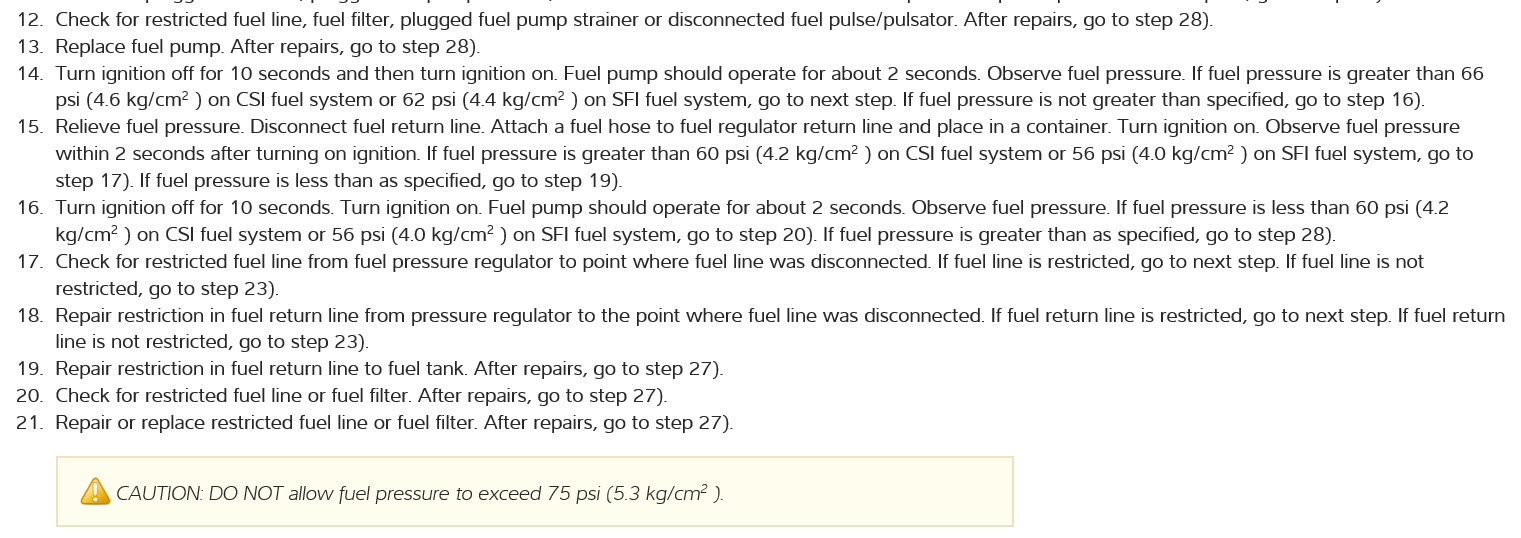

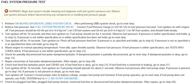

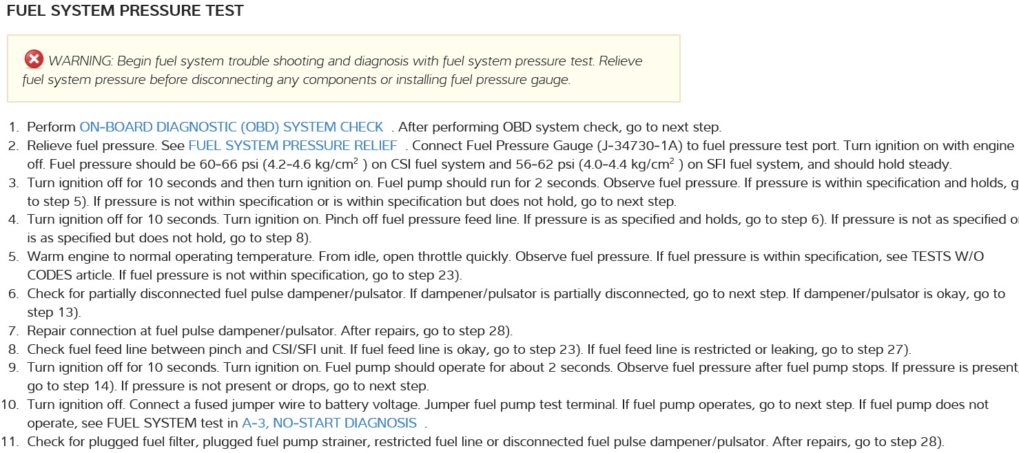

HMAC300
  • 48,601 POSTS
It should not drop that much only about 10 psi. Check the items in picture as it can be a regulator, pinched line, filter or injectors leaking.
