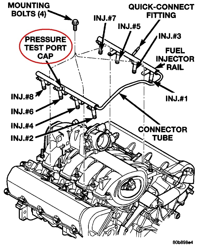

First let me say there are only about 48,000 miles on the engine, replacing it less than a year ago.
The problem is when starting the truck, it takes 5 to 6 times to start.
New parts when engine was installed. New damper, new injectors, used fuel rail, five new coils, new plugs, new throttle control, new coolant sensor, new O2 sensors (2) new intake manifold. Ran fine for 5 months and started this problem, figured 230,000 miles was probable fuel pump, replace it and cleaned tank pressure is 49 PSI then drops slowly to 41, replaced Intake air sensor. Cold weather replaced battery.
Checked every wire and connector, looks fine, checked for vacuum leaks with a smoke detector, nothing. Bought an Xtool scanner which does not id my PCM, but I am able to read all of the sensors, O2 is working, fuel trims are fine, no check engine light, RPMs are around 610, no pending codes, MAF within specs, coolant temperature in specs, TPS works fine smooth up and down, starts at 11.7 IAC seems fine.
I have done and tried everything that I could think of, and I am at the end of my ropes as to what to do.
I looked all over the place for ideas but mostly everything is crank no start, which is what I don't have.

If I read that right, you have a long crank time, but once the engine starts, it keeps on running okay. Stop me if I have that wrong. This is the typical symptom for fuel pressure dropping when the engine is stopped. It should hold for weeks, but for sure at least overnight.

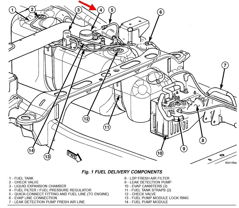

You should hear the fuel pump run for one second when the ignition switch is turned to "run". That is to insure fuel pressure is up for starting in case it dropped a little. That one second is not long enough if the pressure dropped real far or to zero. The pump doesn't resume running until the Engine Computer sees engine rotation, (cranking or running). That means if fuel pressure had dropped a lot, it can take some time for it to build back up to where the engine will run, and to add to the misery, battery voltage is drawn down to as low as ten volts during cranking. That means the fuel pump will be running considerably slower than normal at that time. Fuel pressure builds too slowly, and some will be bled off by the injectors trying to fire.

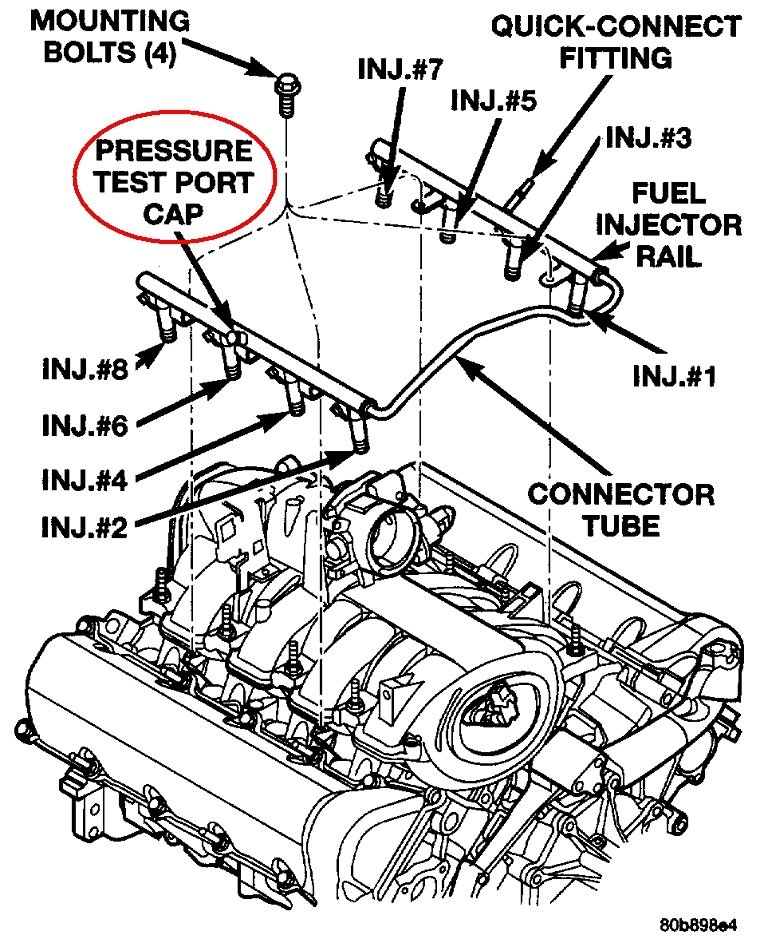

There's two ways to verify this. The proper way is to connect a fuel pressure gauge and watch what happens when the engine is stopped. I circled the fuel pressure test port in the drawing below. The second way to get a clue is to cycle the ignition switch multiple times before cranking the engine. The pump will run for one second the first time the ignition switch is turned to "run". Turn it off, then back to "run" a second time, and perhaps a third time, then crank the engine. The pump will have run longer and built more pressure. The engine will start quicker if fuel pressure is the problem. I don't recommend cycling the ignition switch more than three times. On some models, the cranking system will be locked out after three attempts, then you have to wait a minute or more before resuming. That can let the pressure bleed off again.
If you verify we're on the right track, there's four places fuel pressure can bleed down. The least common is through the check valve in the fuel pump. To find that, use a hose pinch-off pliers to block the supply hose where it transitions from the body to the engine. That will maintain pressure at the test port while it drops on the tank side of the pliers.
Another place is through a leaking fuel pressure regulator. This doesn't apply to your engine, but for those older models where the regulator is on the fuel rail, excess fuel passes through the spring-loaded regulator, then back into the tank. Use the hose pinch-off pliers to block that smaller return line. If the regulator is leaking, fuel can't get past the pliers to bleed down, so pressure will stay up. That style regulator is shown in the second drawing.

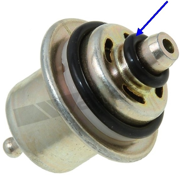

The third place also doesn't apply to your truck, but for the benefit of others researching this topic, it's the rubber o-ring with the red arrow in the second drawing. I've been involved with two of these, one on a brand-new car just delivered to the dealership, and one on a high mileage model. The owner refused to buy the 25-cent o-ring so we had to let the car go that way. Both had a very long crank time, but the engines ran fine once started.
The clue to a leaking o-ring is when the engine is stopped, fuel pressure drops to "0" within a few seconds. If the regulator's valve is leaking, it will take longer for pressure to drop; perhaps as long as two or three minutes. The two o-rings I found were cut. That's an issue with the person who installed those regulators. It's not something that develops on its own over time.
The third drawing is for your 2003 model. It shows the newer-style pressure regulator back at the tank. I haven't heard yet of someone solving a problem by replacing that type.
Probably the most common cause of dropping fuel pressure is a leaking injector. The clue is with the pinched-off fuel supply hose, (and the return hose on older models that have the pressure regulator on the fuel rail), you will still lose pressure at the test port. With both lines blocked, if fuel pressure drops off, it can only be past an injector or one of their o-rings in the fuel rail. If one of those o-rings is leaking, you'll smell and possibly see the gas seeping out. You're also likely to smell it inside the vehicle. You won't see or smell it if it's leaking from the injector's valve. To identify that, you have to remove the fuel rail with the injectors still attached, then look at each one to see if any are wet. The clue to a leaking injector is it typically takes hours for fuel pressure to bleed down.

I have tried to turn on and off the ignition but got the same results. I don't have any rubber on my gas line that I can pinch off, it's either hard plastic or metal. I also have checked the injectors by removing one side at a time and leaving them hooked up and even turned on the ignition no wet spots and no leaking. The fuel pressure goes to 49 lbs, but after 5 minutes it drops about 4 lbs and after 20 minutes it drops to 42 lbs. My book says that this is normal and can drop to 0 lbs overnight, which it does by leaving my pressure gauge hooked up, but when I turn on the ignition again it immediately goes to 49 lbs. Also, in my book it has the same picture as # 3, but my tank only has 4, 5, 6, 7, 8, 9, 10 and no 2, 3, 12
I was thinking I could install a check valve on the metal hard line, but it shouldn't need one
I am assuming that my crank and cam sensors are okay since I have no check engine light.
My MAP sensor is reading the correct temperature, my throttle pos sensor reads 14.7 pedal in the up position and goes to 74.9 when pushed to the floor, my Xtool is a little slow on the uptake and it seems to go up a bit at a time. Also, the xtool won't read my PCM and I have to use the xtool obdii section click on SAE J1050 PWM to read any data. And yes, I have updated the Xtool.
I very much appreciate the help, like I said to myself this is just driving me batty. My only thought is that the throttle body is the problem, but how do I figure that out?

Item # 2, check valve is different than the one inside the fuel pump. # 2 isn't related to this. I'm surprised to see it's considered normal for fuel pressure to drop to "0" overnight, but as long as it comes up high enough to start the engine right away, that is all that's needed.
I've used the low-cost code readers that supply data, but as you've seen, they respond very slowly. What you might consider is looking on eBay for a Chrysler DRB3. I have one for all of my older vehicles. The first they went obsolete on was the 2004 Dakota / Durango. They were still used up to 2008 on some Jeep models. Depending on the year the scanner was built, they will work back to '98 or '96 models, and with extra plug-in cards, they can all work on all Chrysler products back to '83 models, and they can do emissions-related stuff on all car brands sold in the U.S. Starting with '96 models. For that reason a lot of independent shops bought them, but now that they're obsolete, you may find a local shop with one to sell.
One of the menus with the DRB3 is a "crank / no-start" menu. That would be appropriate for a long crank time too. That screen shows all the data related to fuel, spark, and timing that the Engine Computer sees. The data updates almost instantly, so you can watch to see what's wrong or missing before the engine starts.
For my 2014 Ram truck, I bought a used Snapon Solus Edge from a seller on eBay who always has a few listed as having the latest updates. Snapon charges way too much for their annual updates, so a lot of people, including myself, will never have them updated. Mine is good for up to 2018 models. I'd have to pay $1000.00 for the 2019 update before I could buy the 2020 update for another $1000.00, and so on for every year. It would cost roughly the same to buy a brand new model. They won't let you skip any years. Here again, once it gets too far out-of-date, a lot of shops will just sell theirs cheap and buy a new one. You can look on eBay for one that's really far out-of-date, as long as it covers the 2003 models.
After rereading your first post, please clarify what you mean by, "it takes five or six tries" to start the engine. Do you mean the engine just cranks and cranks but doesn't try to run? Between attempts, do you turn the ignition switch all the way back to "off" before trying again? Do you just get a loud clunk from the starter but it doesn't crank the engine? That is another common symptom that might have an easy solution.

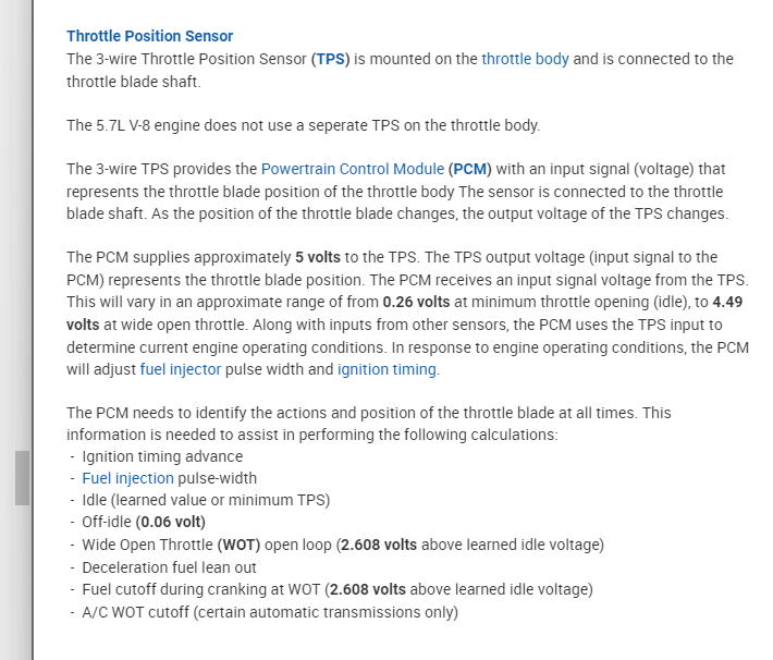

Also, one more question, should the throttle position sensor at normal setting be reading more than 0, because mine reads 17.9 engine on or off? Tested my girls 2009 Jeep and hers was 0, of course different engine and different year.
Monday, March 21st, 2022 AT 4:05 PM

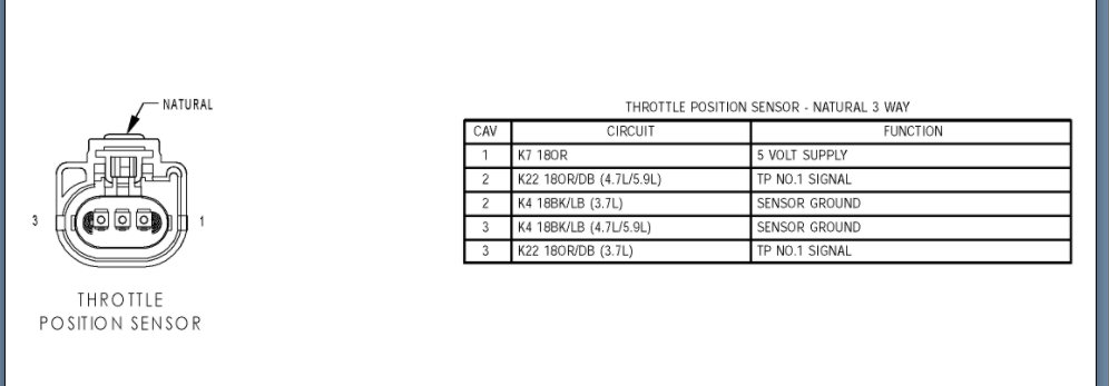

Just to jump in on this one because I want to clarify what you are seeing with the TPS. I assume you are looking at this with your scan tool and seeing at key on it is 17.9 degrees?
Let's just check the voltage to confirm the sensor is telling us this or it is a scan tool issue.
Unplug the connector and check voltage from pin 1 to 3. You should have 5 volts.
Then plug it back in and back probe the signal in pin 2 and 3.
Let me know what this voltage is and then we can see if we have a throttle issue but if this is hanging open then it can cause a hard starting.

At key on with the engine off, your throttle plate should be 0 degrees or close to it.
I don't remember looking at other 4.7L of this year but I do know that I have looked at enough other Chrysler products and they are all 0 except for Hemi engines.
When the engine is idling it should be slightly open as this is how the throttle controls the idle on Hemi's because they don't have separate IAC valves. So, this is more than likely what people are saying when it is "normal."
However, the 4.7L does have an IAC motor so I would expect the throttle to be 0 as the IAC will allow air the proper amount of air in.

Hi, I checked the voltages, I was mistaken about the percentage of the throttle position sensor, it is 11.9. Replaced the TPS and it is still at 11.9
It is not degrees? It is percentage.
I unplugged the connector and check voltage from pin 1 to 3. I have 4.96 volts.
I plugged it back in and back probe the signal in pin 2 and 3 and I got 0.40 volts
I do remember doing this a while back but didn't remember what the results are.
Looks normal to me

11% sounds high but the voltage on these sensors is from a half volt to 4.5 volts range. So, of the 5 volts it uses this range so that is normal.
