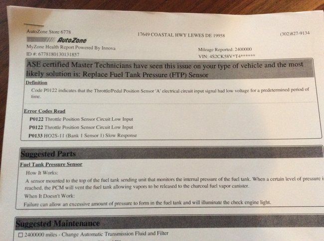

Ken, I thought I would try another auto parts place to do a code read and actually they were able to read the codes this time so I’ve got a.
P0122 throttle position sensor circuit low input, and a
P0122 throttle position sensor circuit low input, and then I’ve got a P0133 HO2S-11 (bank 1 sensor 1) slow response
Does this help. Or complicate the diagnosis?
PS additionally the fuel tank pressure sensor is not working properly.
Tuesday, January 30th, 2018 AT 12:40 PM

Here’s the print out.
Tuesday, January 30th, 2018 AT 12:43 PM
STEVE W.
  • 15,697 POSTS
Don't believe the tank pressure sensor as a fault. If that was an issue you would have an EVAP code as well as a throttle position code. AutoZone LOVES to sell parts.
From the codes you posted I would check the wiring at the TPS sensor at the throttle body, as well as testing, or just replacing the TPS sensor. Setting for long periods of time can easily create corrosion. I would remove the connector and spray a bit of contact cleaner in the wire side, then plug it in/out a couple times. The TPS only uses a 5 volt signal so even a small amount of corrosion could cause a voltage issue.
That could cause the shifting issue because the PCM uses throttle position as an input for gear selection and shifting points.
However it's also possible the shift issue is mechanical and also due to it setting for long periods. I would deal with the TPS code first.

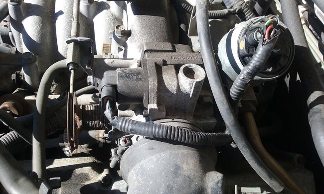

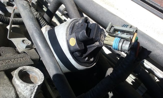

I'm sending two photos to make sure I'm identifying the right part. Is that the TPS on the right side of the first photo? And on the second photo I disconnected that connector and though it did not look corroded I sprayed it with WD-40 and reinserted it
Wednesday, January 31st, 2018 AT 8:19 AM

Here’s the photos.
Wednesday, January 31st, 2018 AT 8:33 AM

Hey Dan,
The TPS sensor is lower on the throttle body what you are showing is the EGR valve. The TPS is lower.
+1
Wednesday, January 31st, 2018 AT 10:14 AM
STEVE W.
  • 15,697 POSTS
That is the EGR valve. The TPS is under it.
+1
Wednesday, January 31st, 2018 AT 10:16 AM
DAN LACOMBE
  • 13 POSTS
Well it’s just unbelievable to me but the TPS was kind a like not pushed in to the hole where it seats and so I buy pushed it in and now everything’s fine and it shifts perfectly and it’s incredible to think that I brought this to it transmission specialist and told me it would have to be rebuilt and the mechanic told me that I should just take the car to the junkyard and now it has a new lease on life and I’m very appreciative to you guys you guys are the best so awesome thank you so much

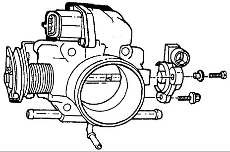

If the TPS itself was loose you may want to check it close, it should have 2 screws that hold it into the throttle body. One may have come out or the plastic may have failed, Unless you meant the connector was loose, then check that the latch on the connector is still there.
