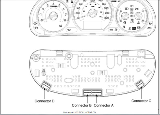

CWEST1313

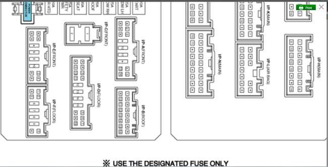

None of the gauges work.
Flashing AWD symbol looked it up and it said AWD disconnected.
Help
Feb 28, 2019 at 5:39 AM
SCGRANTURISMO
  • CAR REPAIR CONTRIBUTOR
  • 4,897 POSTS

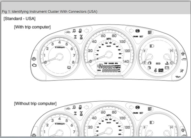

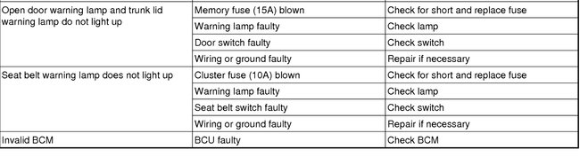

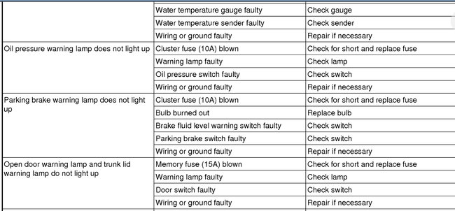

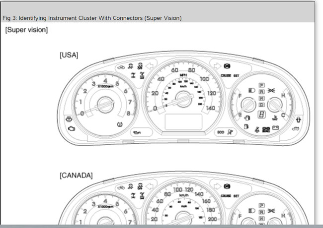

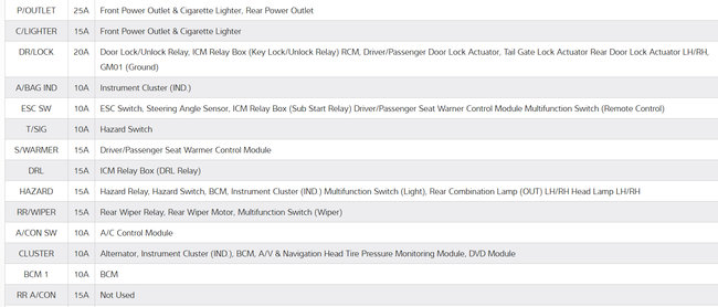

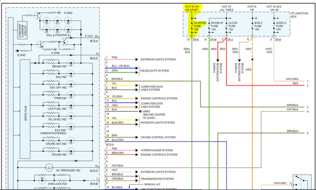

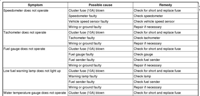

Hello.

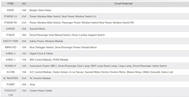

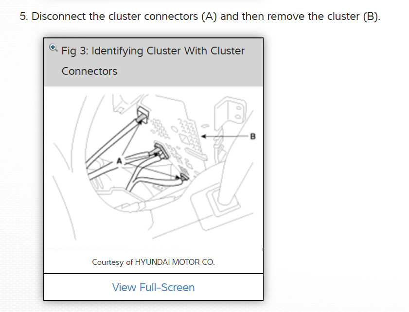

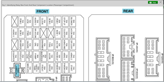

This could be a blown cluster fuse (10A). I have sent you a link down below to go to.

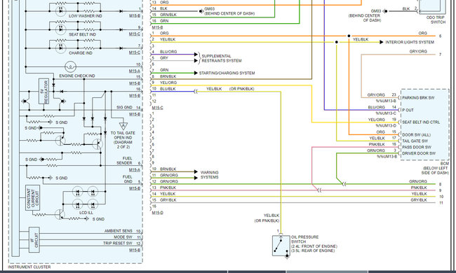

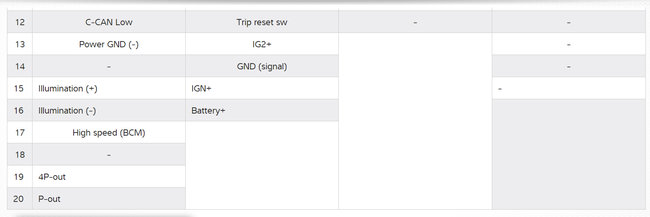

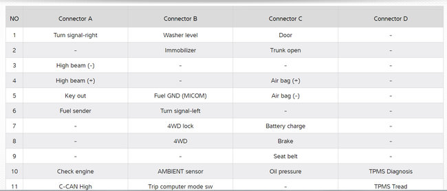

Also below I have sent vehicle specific diagrams in the diagrams below. Please go through them and get back to us with what you find out.
Thanks,
Alex

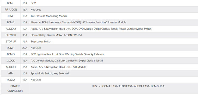

CWEST1313
Checked all fuses they are all okay.

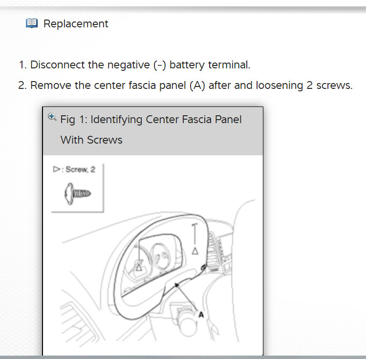

Hello again,

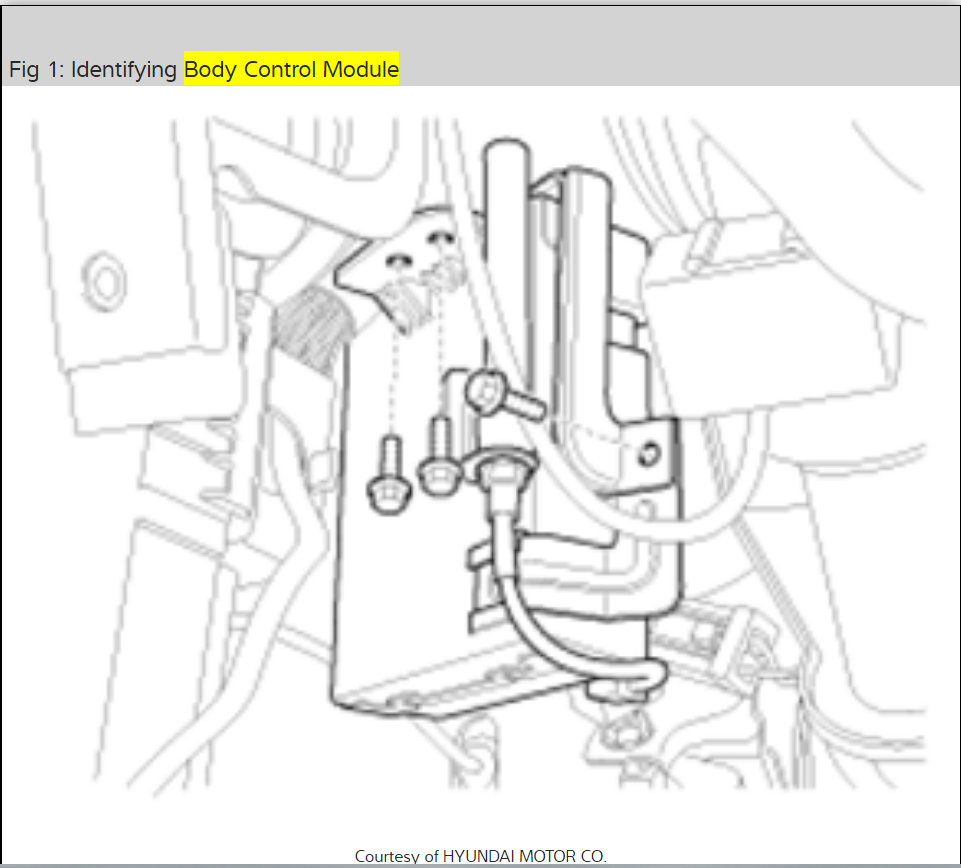

Okay. Let's check the Body Control Module.

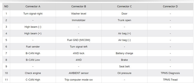

Have you heard of a smart box that all the wiring goes to?
Mar 7, 2019 at 3:52 PM
SCGRANTURISMO
  • 4,897 POSTS

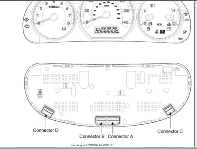

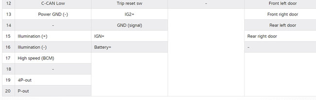

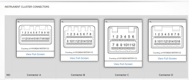

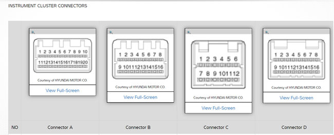

Hello again,
Okay here's what I got on the Body Control Module(BCM). The flowchart I already gave you in the first set of diagrams. Everything else is in the diagrams down below. Please go through them and get back to us with what you find out please.
Thanks,
Alex
