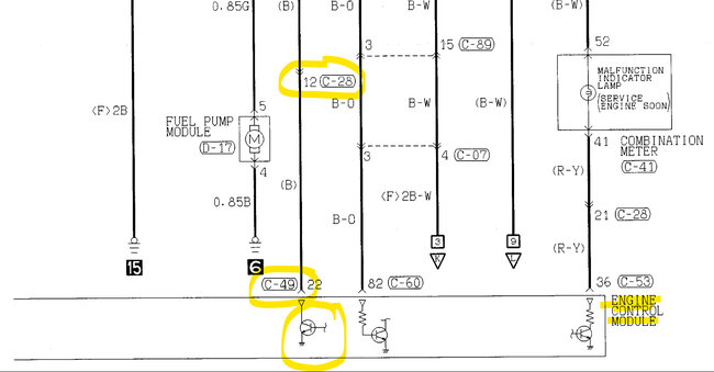

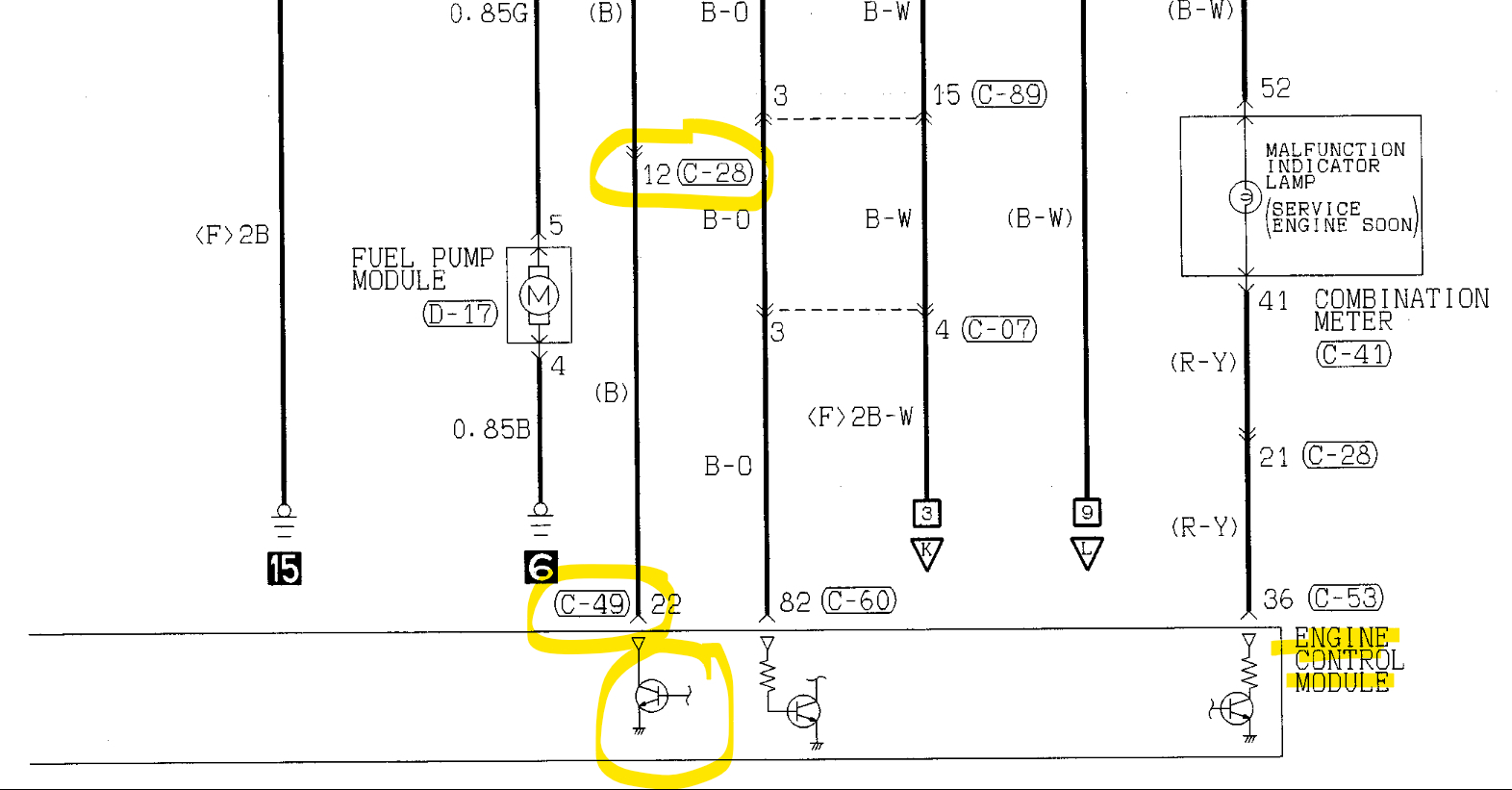

I've gone through diagrams and see the ground for fuel pump relay 2 and people say it goes to ECU or PCM. I'm currently testing for ground and receive no ground for fuel pump relay 2. Where does it get its ground from and why would there be no ground?

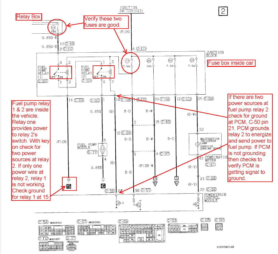

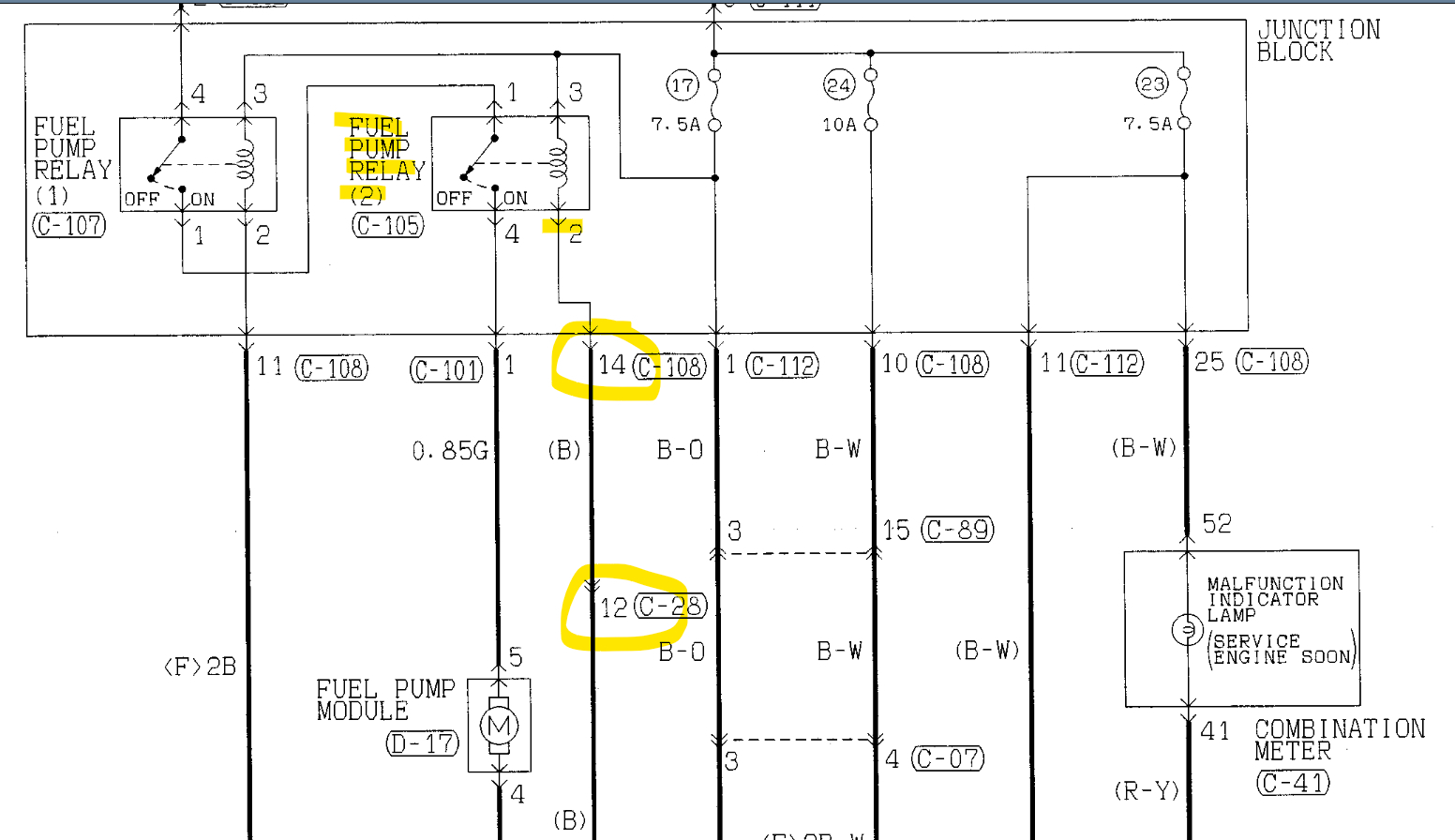

Hello, the ground does go through the ECM, the OEM diagrams are showing a transistor inside the ECM that closes that ground connection. So, either you have a wiring issue from the relay to the ECM, it's missing an ECM ground, and I will post the diagrams, or the transistor driver inside the ECM burned out. A wiring issue to the ECM is the most likely problem, so checking the wiring from the relay to the ECM would be my first test.

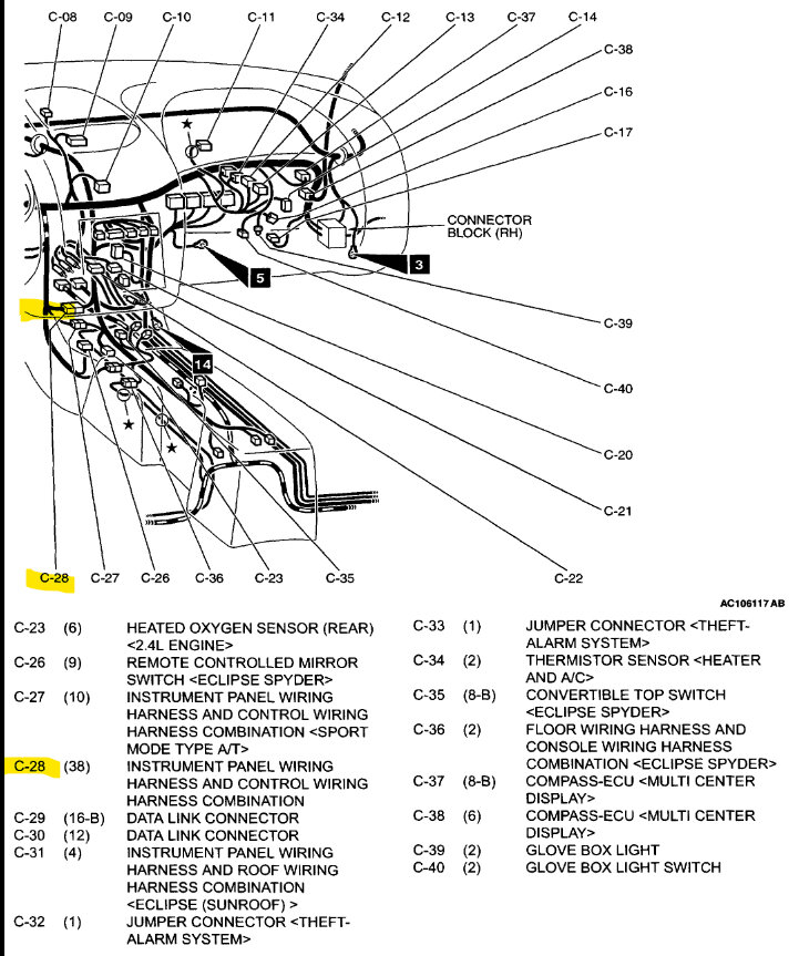

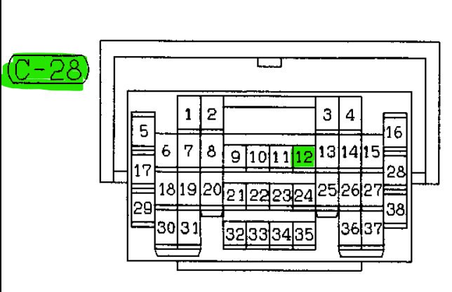

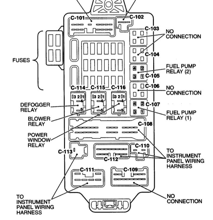

There are the connector C 108 at the Junction Block, also C 28 a connector in between the ECM and the junction block, and then the ECM connector itself.

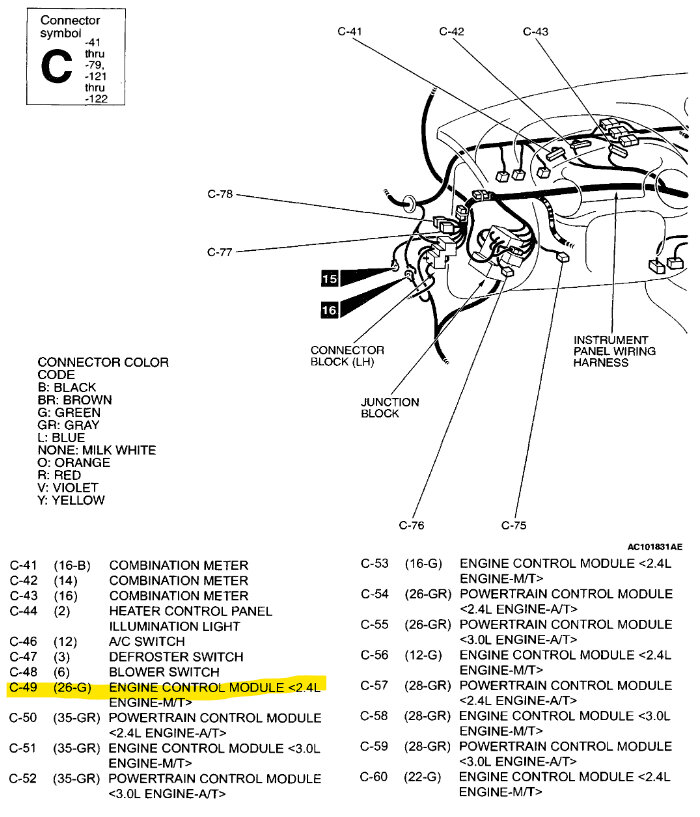

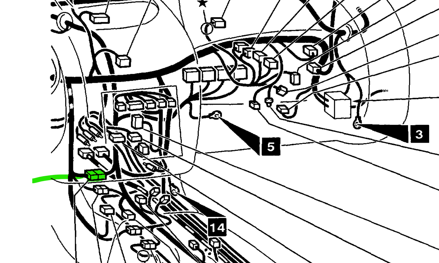

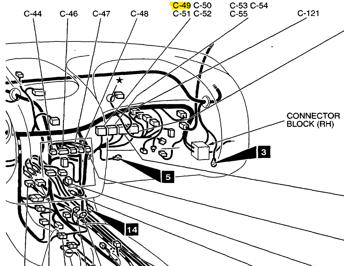

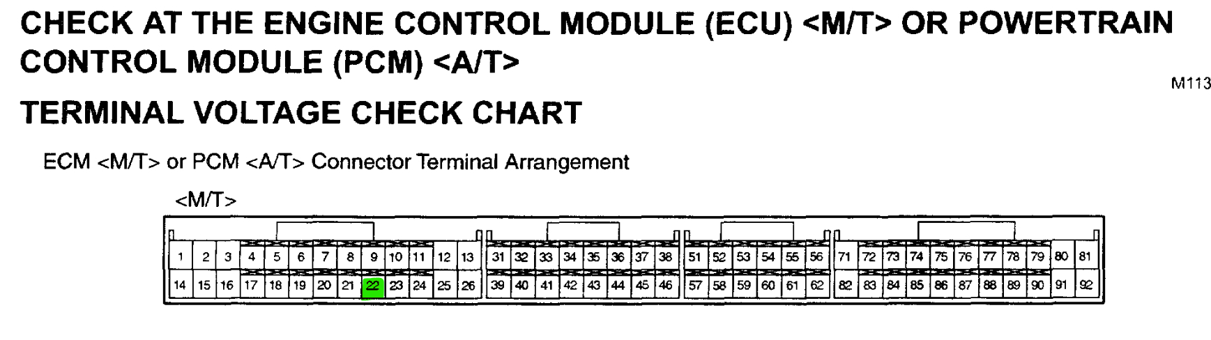

The C28 connector looks like it's in a pretty difficult place, somewhere in the lower center console. So, checking the circuit from the relay to the ECM connector for an open circuit to begin with will be easier. I'll find the ECM pinout.

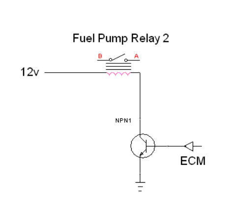

I have that picture and was wondering what is the transistor for. Like is there a reason it won't give ground due to safety in the computer? If not, I'll continue to follow the trail of that wire and determine whether there is a break in the wire or something to do with ECM. Thank you for your reply.

The transistor is what the ECM uses to turn that ground connections off or on. It's a 3 pin component, think of it like a switch, when the ECM sends a low voltage signal to the Base of the transistor, it turns the transistor on and completes the Ground through the other 2 pins. The 1st diagram is one I threw together to show how a NPN transistor works, the rest are the connections in between the relay and ECM and each connectors pinout. Just note that when you go to check the ECM connector to see if that ECM pin is making ground for the relay, you need to use an led test light, that ECM driver is not made for high current, if the transistor isn't bad and you use and incandescent test light to check that ECM ground you could burn it out. That Fuel pump relay probably only pulls 150 to 200ma maybe. So, anything more than that and the ECM will be junk. Using an LED test light is the only safe way to check that ECM driver. If you don't find any connection issues to the ECM, check the relays resistance, a shorted relay on its control side will burn out a driver like that. Relays are usually around 75 ohms.

Yeah, I do mobile diagnostics too, got to love it. Were there any codes stored? This C28 connector looks like it's below the HVAC controls, it has wiring for the cluster and control harness combination. So that's not very helpful.

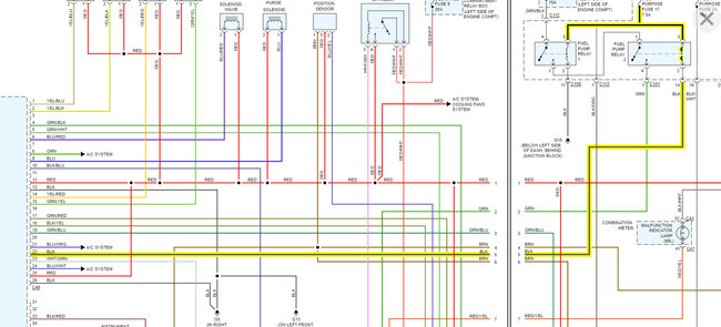

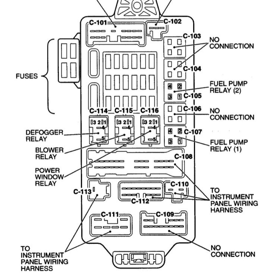

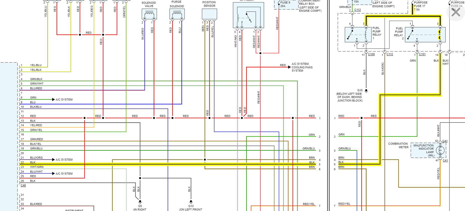

Also, a 16pin dlc plus another data connector that's C30 pins 21 to 32, I don't know what this other data connector is for. Also found this through all data community, looks like there is supposed to be an empty space between the 2 fuel pump relays. This 3rd diagram will be helpful too.

These diagrams make me feel better knowing what I'm doing is correct. This whole thing getting ground from PCM for a 2nd relay is dumb thank you for all your help with these diagrams I'll be sure to post back what I find when it makes it back to the owner's home. I'll be a lot warmer to and will be sure to take pictures of what I find.

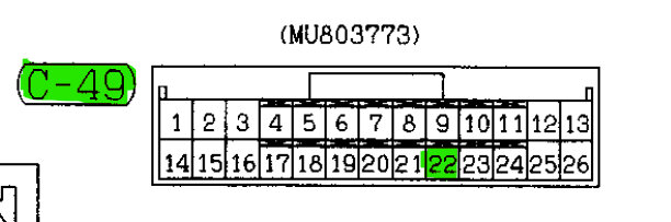

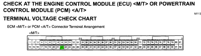

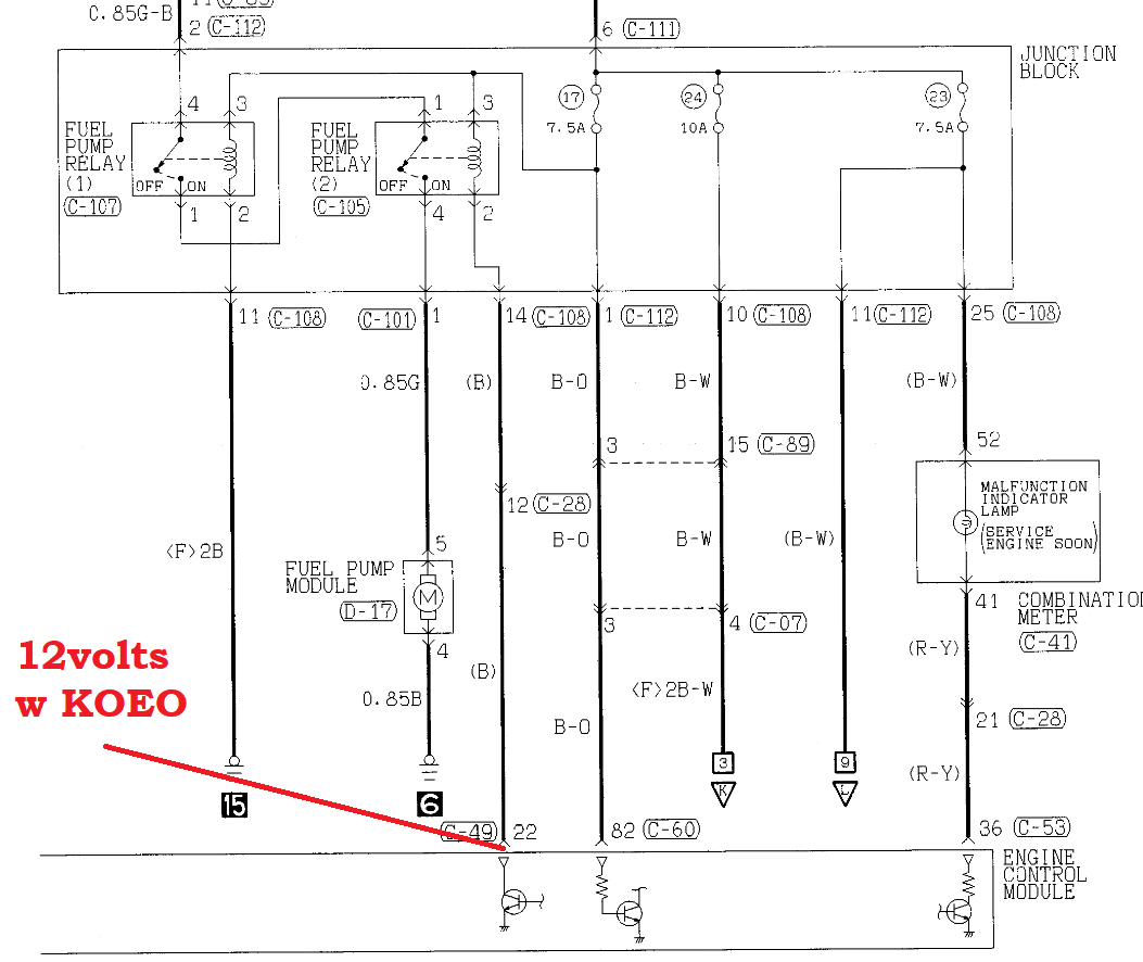

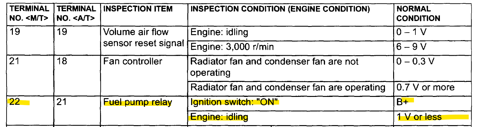

One other quick test you can do is that pin at the ECM, pin 22 with key on should read 12-volts until the engine is cranked over and the relay is pulled to ground. So, Key on 12-volts, engine running less than 1 volt. 12-volts will travel through the relay to the ECM connector until the ECM grounds it. This will verify your powers through that hidden connector without having to deal with it. Looks like a black wire.

I have power to the signal wire with key on.
Friday, February 3rd, 2023 AT 3:44 PM
AL514
  • 5,593 POSTS
At the ECM? And the voltage doesn't drop off when cranking? If not, we need to figure out if there's any inputs missing to the ECM. I'd think it would just be a crank signal, but there might be an ignition feed missing since he had the fuses out. That's something that will need to be verified. I haven't gone through all the power feeds yet to the ECM, it's a bit slow with these OEM diagrams.
Friday, February 3rd, 2023 AT 4:11 PM
SEMME03
  • 11 POSTS
No at the relay.
Friday, February 3rd, 2023 AT 4:21 PM
AL514
  • 5,593 POSTS
With the relay in, you should read 12v on pin 22 of the ECM. The wire that gets grounded. It will read voltage until it's pulled to ground by the computer. Same with a fuel injector, or any other solenoid. The control wire will read the voltage coming through the relay until the relay is energized. Once you start to crank the engine over, that voltage should drop to 0v.
